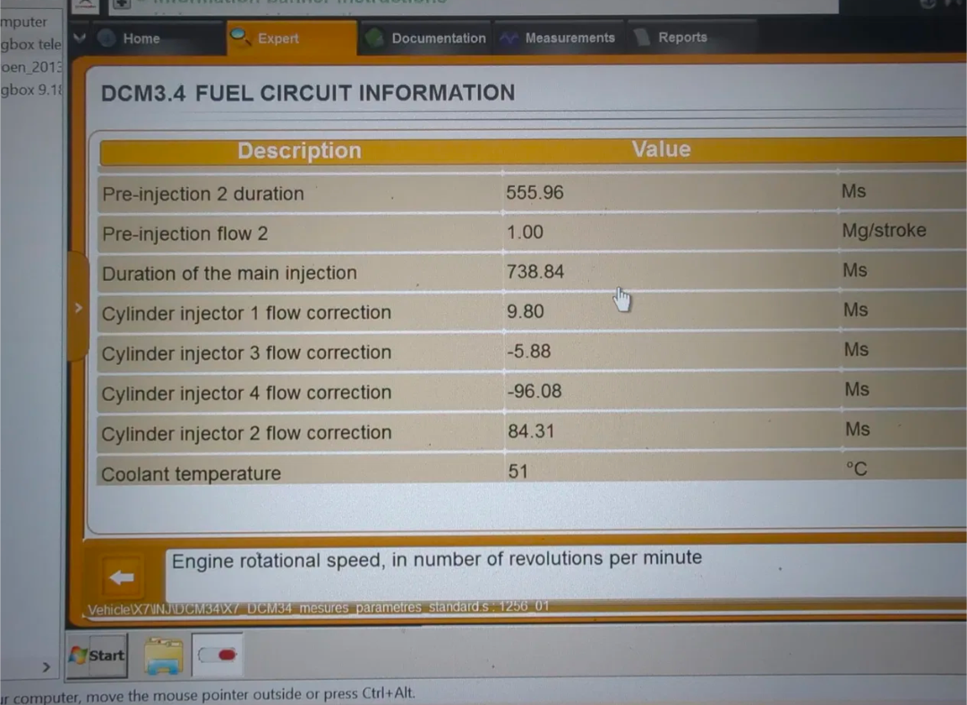

Diagbox shows P1471 — EGR valve, logged as Local, Intermittent, with the fault characterized as an open circuit.
I've attached photos from the live readings (engine on).
Seems to work fine for 30 seconds or so - but then the "no EGR" kicks in.
I assume the EGR is knackered, and this is causing the emissions issues?

I also wondered if it could be the injectors...
I do also get p1351 error.. but as far as I can tell, this is unrelated and you can pretty much ignore it.
It has done about 120k miles, so may be due a dpf clean? From what I understand, the dpf should catch all the black soot?

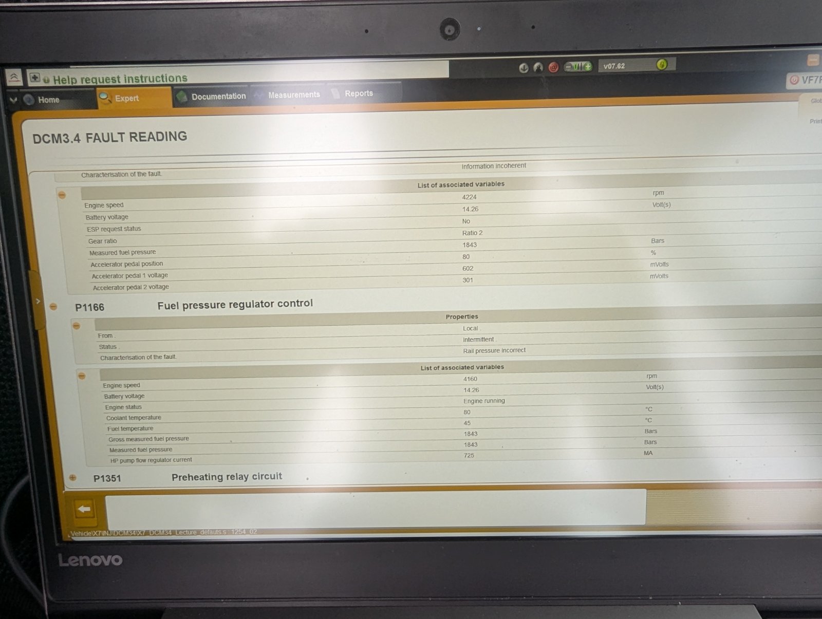

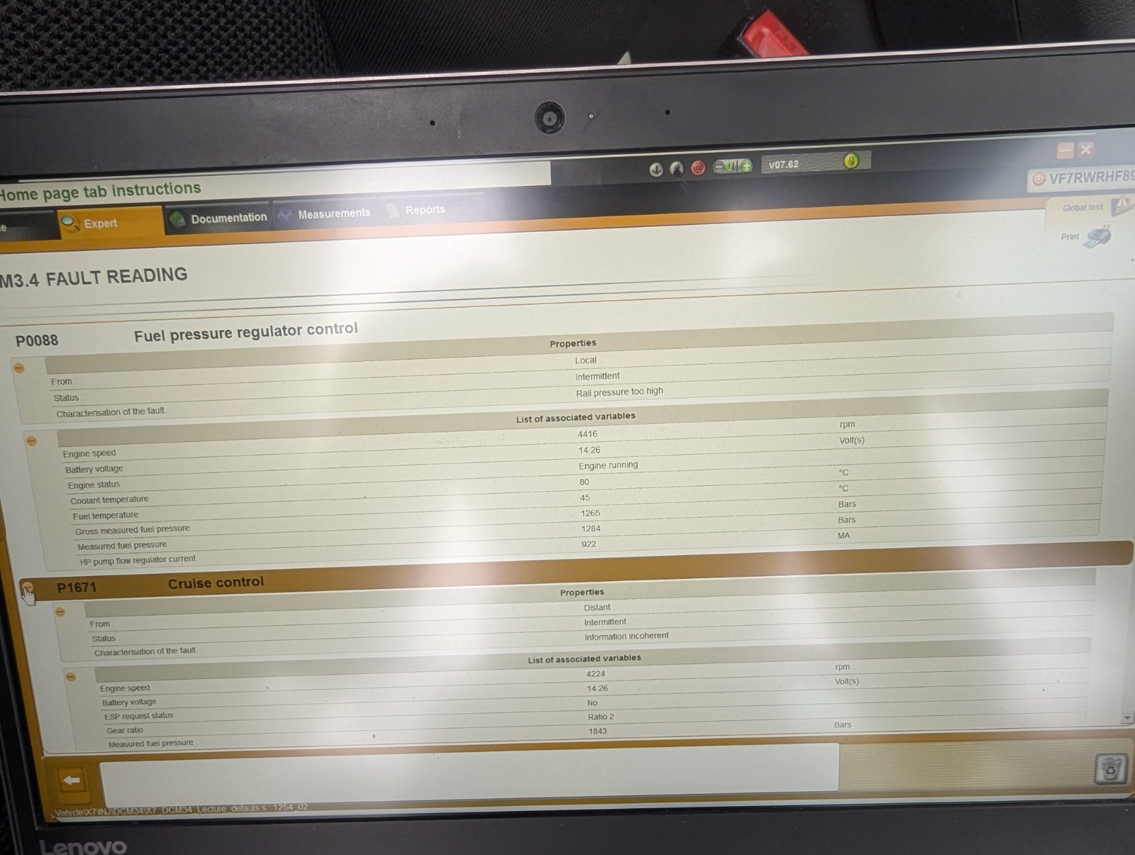

I was just redlining my car in second gear, and got "anti pollution fault" with engine management light.
¯p0088 and p1166.
P1671 also came up, but I suspect that's just a red herring.
Rail pressure got up to 1843, and from what I understand if shouldn't go over 1500?
Could the fuel pressure regulator be the cause of the emissions woes?
