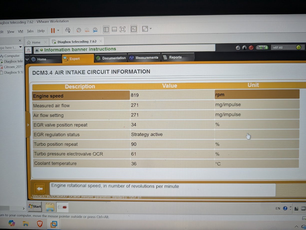

My 2009 x7 failed the MOT on emissions today..
Diagbox shows P1471 — EGR valve, logged as Local, Intermittent, with the fault characterized as an open circuit.
I've attached photos from the live readings (engine on).
Seems to work fine for 30 seconds or so - but then the "no EGR" kicks in.
I assume the EGR is knackered, and this is causing the emissions issues?

Does it have a DPF?
