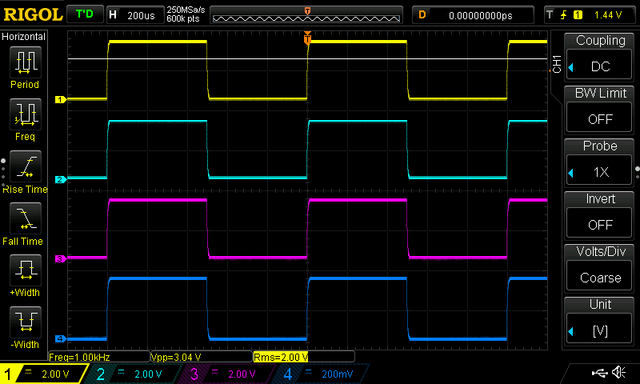

New scope arrived this morning, and you could honestly have fooled me into thinking it had never been used. As new definitely would be accurate.
Only had a brief poke around, but I think I've found a likely candidate for why the PET isn't working. I don't know much about this system, but I'm pretty sure that address bus line A2 on the memory shouldn't look like this.
Wait...I don't need to faff around with taking photos of a screen here. With the press of one button I can just save a screenshot to a USB stick.
I reckon that has the potential to be a surprisingly useful feature when bug hunting. Definitely better than my own memory and half readable scribbled notes.

Definitely realised one advantage of the new scope this evening when I was wanting to compare two signals to each other - having a full colour display *definitely* is a huge advantage over a conventional CRO when you're using more than one channel. Didn't think to snap an image at the time, but here's all four channels hooked up to the square wave test terminal on the front of the scope.
Definitely makes things easier to keep track of.
