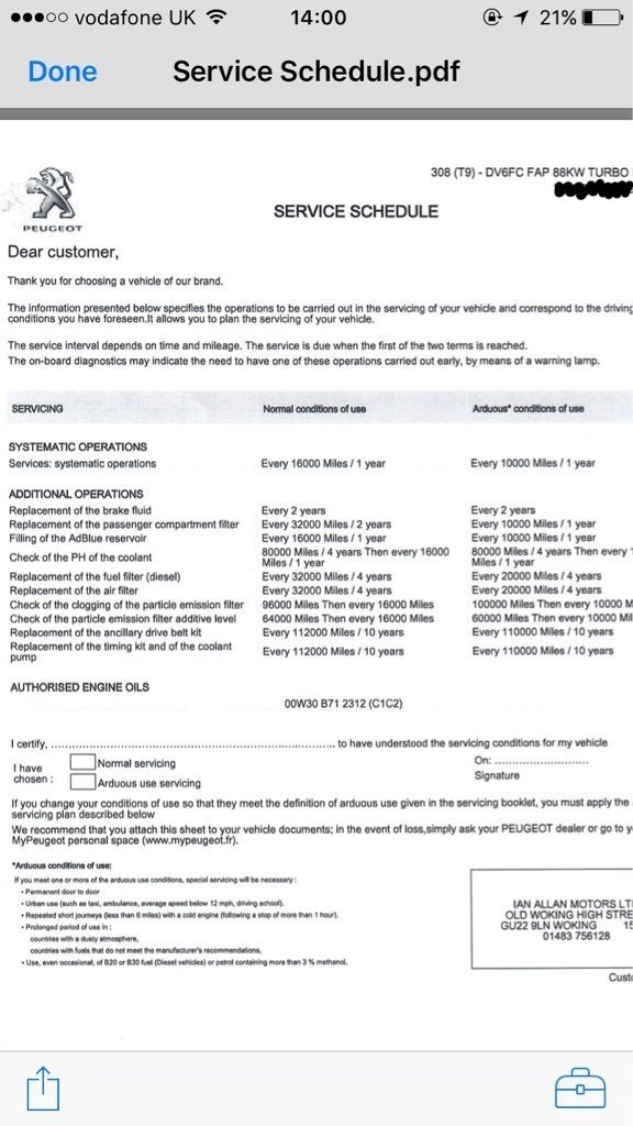

The service schedule is based on mileage OR one year, if you don't reach the recommended mileage. This is my service schedule and it clearly says "The service interval depends on time and mileage. The service is due when the first of the two terms is reached".
As regards 25,000km or15,000km my best guess is that these are the normal conditions and arduous conditions mileages. These roughly correspond to 16,000 miles and 10,000 miles on my schedule.
