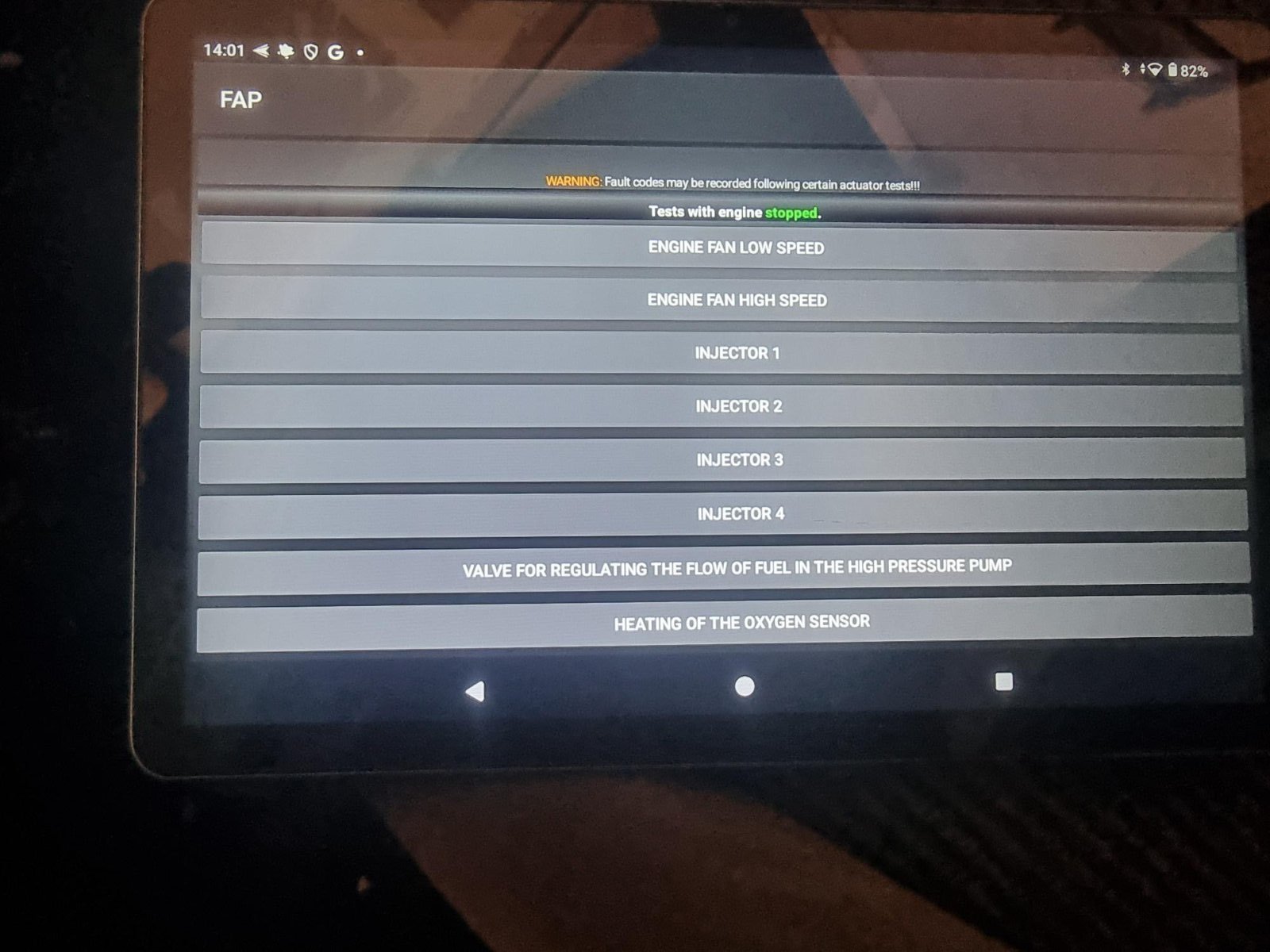

I fired it up and under the component tests menu I dont see anything about particle filter regeneration - see attached image.

Im wondering is it because I loaded the app before I started the engine? Cos it says explicitly (see screenshot) - "Tests with the engine stopped" - I guess I can try starting the app with the engine running to see if it shows something else.

Tried it every way and couldnt get the top of the test screen to change from "Tests with the engine stopped." to something else - Im running version 1.62 - are you running something else ? Im also using the Nexas nexlink (since many members got results with that). Perhaps you could post up a screenshot from the menu ?Huskyxantia wrote: 14 Sep 2026, 17:18 Try it that way see if it makes any difference sometimes rebooting app or programes seems to make it work
