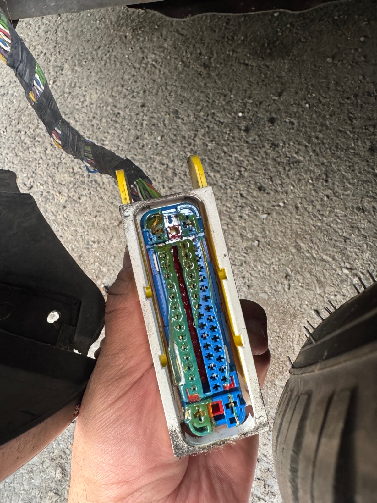

Re: Peugeot 207 CC 1.6 HDi 2009 – ABS/ESP U1221
I think this connector is supposed to look like this; it seems to have some kind of protective coating or material on it. At least, that’s what GPT says.
I checked the top and bottom points with a multimeter and couldn’t find any break in continuity. However, the battery voltage drops as low as 8.77 V while cranking.
Tomorrow I’m going to check it with Diagbox. Also, I couldn’t find the MF9 and MF10 fuses.

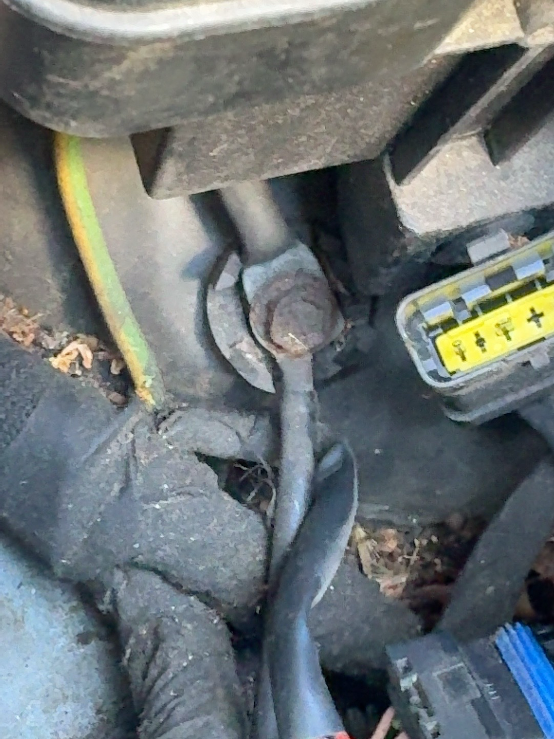

I did a more thorough check and found that the ground connections were very poor. I cleaned them, but it’s already late now, so I’ll continue checking everything tomorrow.

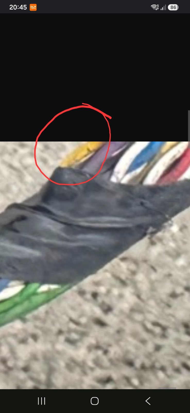

Huskyxantia
- Posts: 3938
- Joined: 30 Jul 2018, 22:11
- x 925
That yellow wire in the loom looks spilt undo the back tape around the loom check each wire without the tape on that's how I found my problem

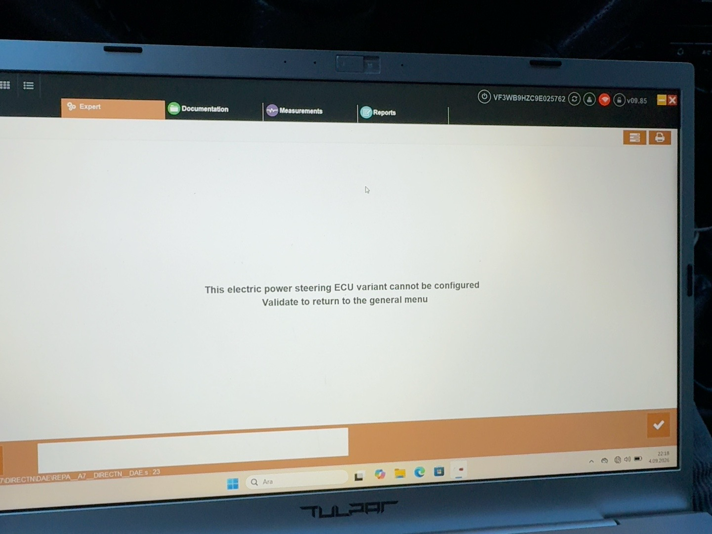

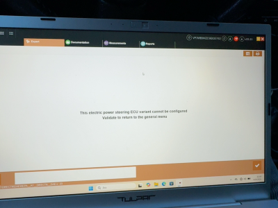

I am confident that the car's battery is in very poor condition. I am getting code U1331 along with a power steering fault. I tried to recode it, but couldn't find the option in DiagBox. There is also no communication with the ESP module, and everything is a mess right now. Do you think I need to buy a new battery? I checked the cables and they are intact.

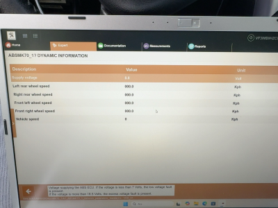

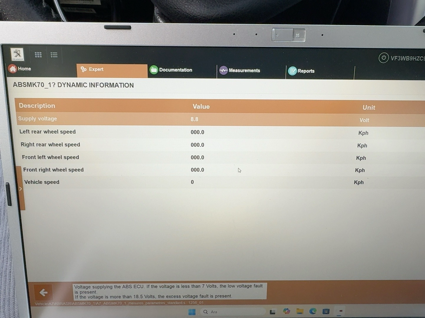

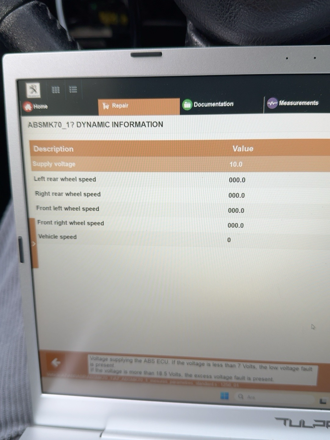

Today I installed a new battery. I also replaced the relay and the relevant fuses. The BSI was configured for a 42 Ah battery, but the new battery is 64 Ah, so I changed the battery setting to 64 Ah using Diagbox.
With the engine running, the BSI shows around 14.9 V and the electric power steering ECU shows around 14.0 V. However, the ABS/ESP ECU only shows around 9.9–10.1 V in live data.
There are currently no active faults stored in the ABS/ESP, and during the actuator tests I can hear the pump and valves operating. However, the electric power steering ECU still stores U1313 – no communication with ABS/ESP / incorrect data received. The “Power steering status” also sometimes changes by itself between Activated and Deactivated.
My main question is: if the BSI and power steering ECU are seeing 14–15 V, but the ABS/ESP ECU only reports around 10 V, does this suggest a real power supply/ground problem to the ABS unit, or could Diagbox be reading the voltage incorrectly? Could this also be the reason for the U1313 fault?
