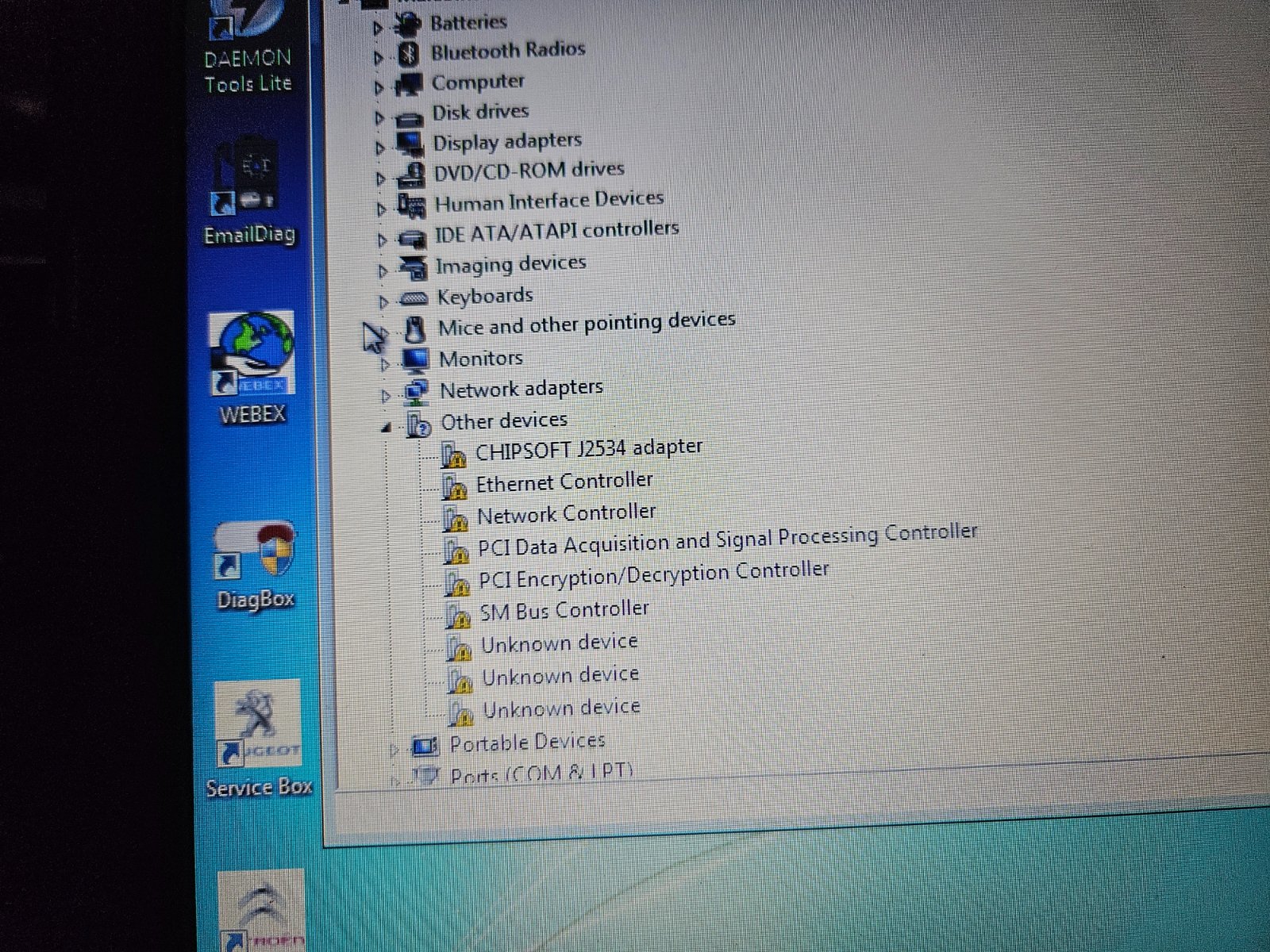

Hi everyone,
I’ve got a J2534 VCI interface that I’m trying to use with DiagBox 7.57, but Windows isn’t recognising it properly.
I’m running Windows 7 32-bit (legitimate installation).
As you can see in the picture, the VCI appears under Other devices with a yellow warning symbol. I’m guessing the correct drivers aren’t installed.
I also tried Interface Checker, but it says:
INIT KO
Does anyone know what drivers and firmware I need to install for this J2534 VCI to work with DiagBox 7.57?
Is there a specific firmware version that needs to be installed/flashed, or a particular driver package I should use?
Any help would be appreciated. I can also post the Hardware IDs from Device Manager if that would help identify the correct driver.
Thanks!

Re: J2534 VCI not recognised by Windows DiagBox 7.57
No sign of a picture? :)

mickthemaverick wrote: 07 Sep 2026, 18:28 No sign of a picture? :)
Oops! Sorry should be there now!

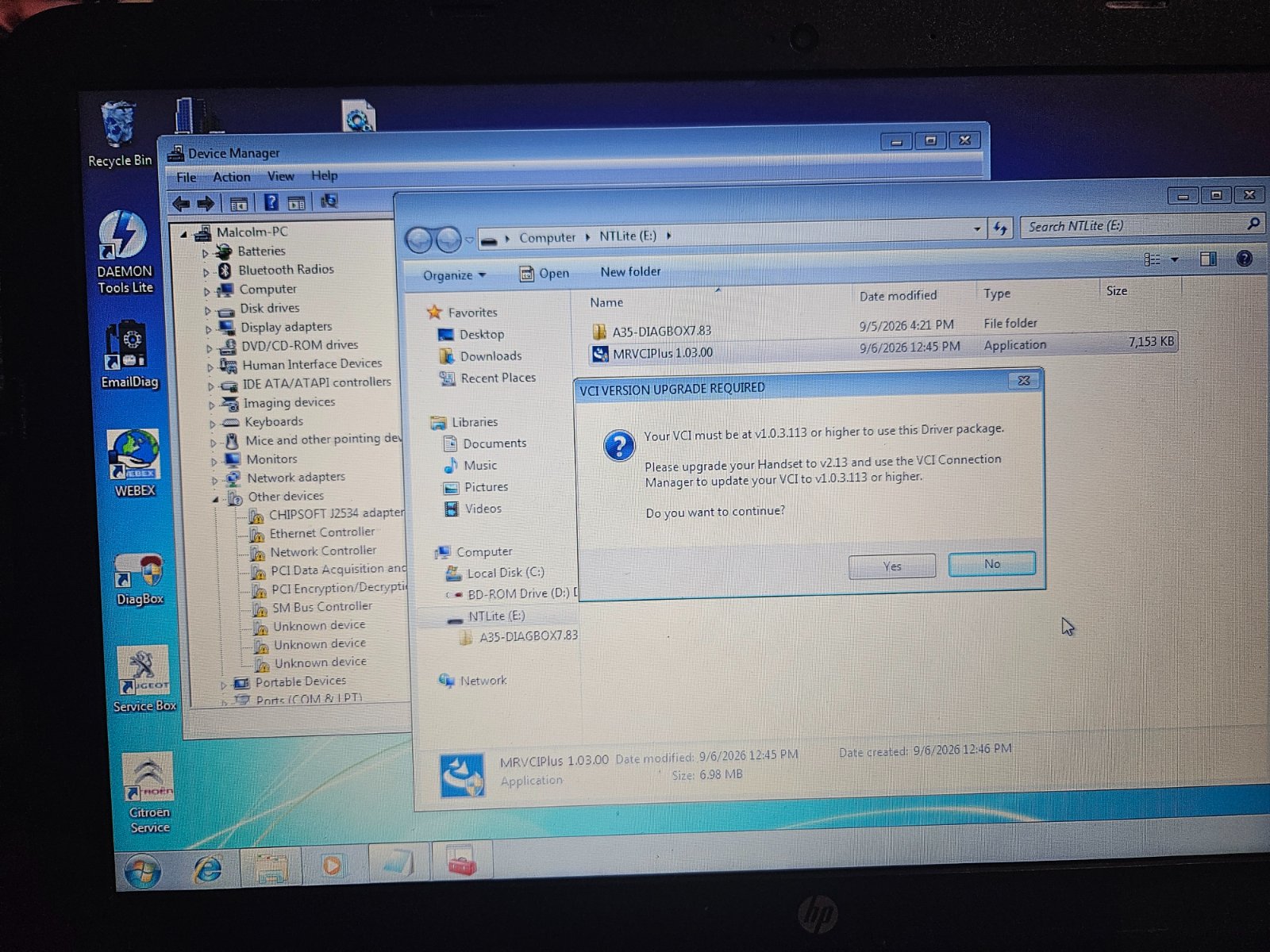

mickthemaverick wrote: 07 Sep 2026, 20:00 Have a look at this:
https://www.boschdiagnostics.com/J2534drivers
I've tried this but say the same thing happens. But the first time i launched it this popped up.
However the supplier of the VCI hasnt provided me with any firmware or anything.

What happens if you answer Yes on that screen? :)

It just proceedes to the installation where it then completes seemingly sucessful. If I launch it afterwards again it asks if I would like to uninstall the drivers or repair them.

No support passtru this version is very old. good luck!
