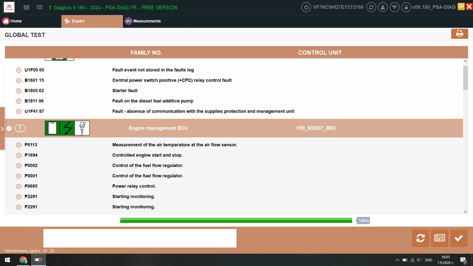

I opened fuel pressure regulator and cleaned it. The needle inside started pulsating when i tried to start the car and fuel came out of the hole where the regualtor must sit. I put it back in place and again tied to start the car. Noting happened.
mostcho
Posts: 10
Joined: 13 Oct 2021, 05:42
Re: C4 B7 not starting
Unread post by mostcho »
I forgot to add the new errors after the cleaning.
