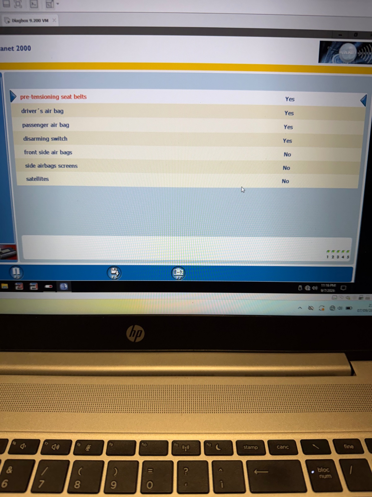

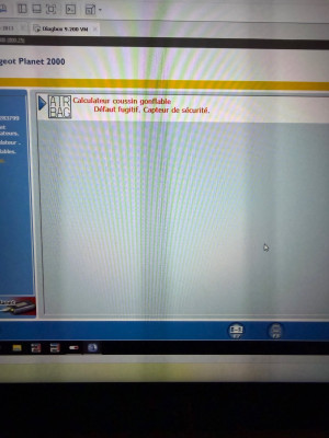

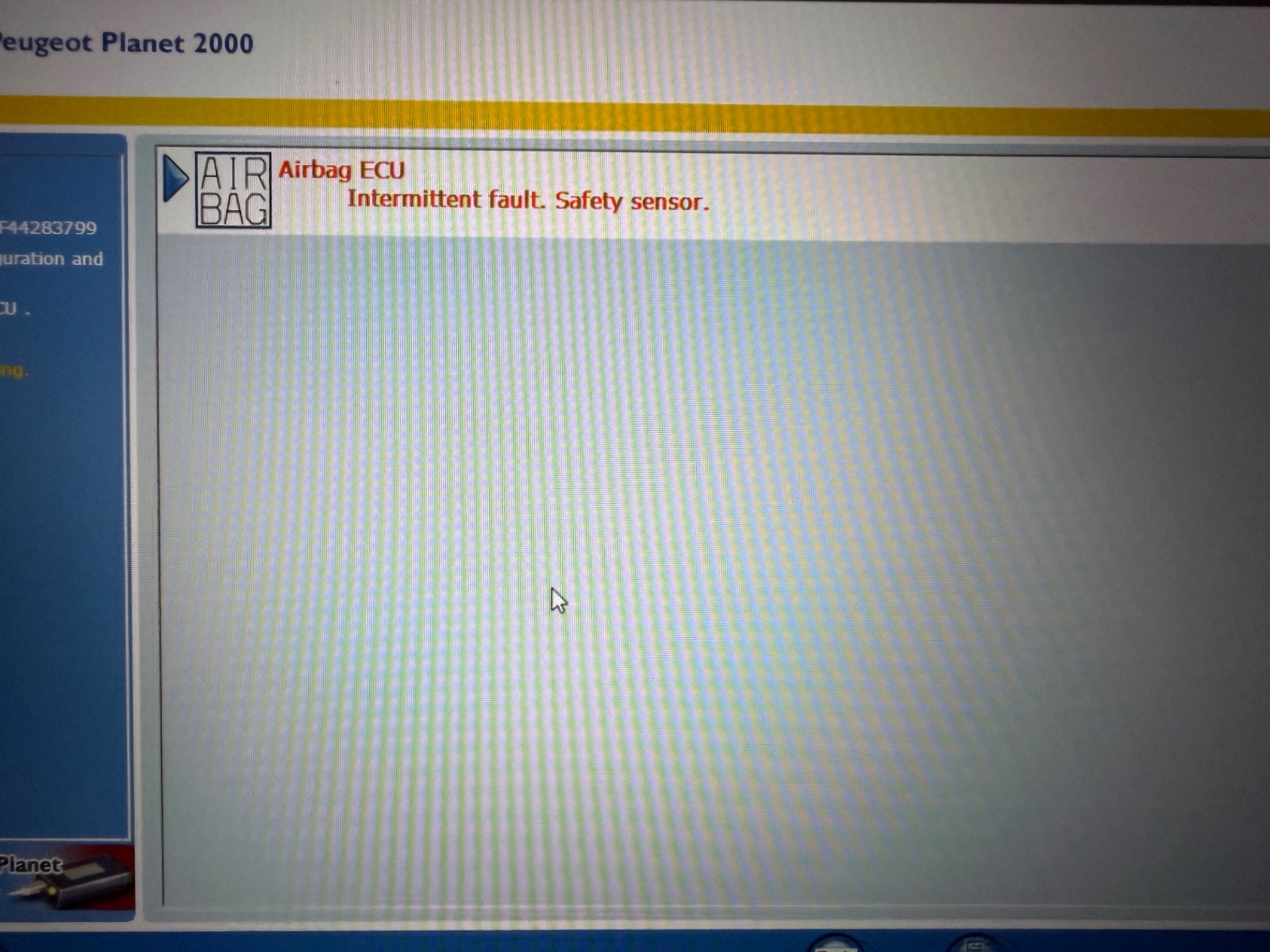

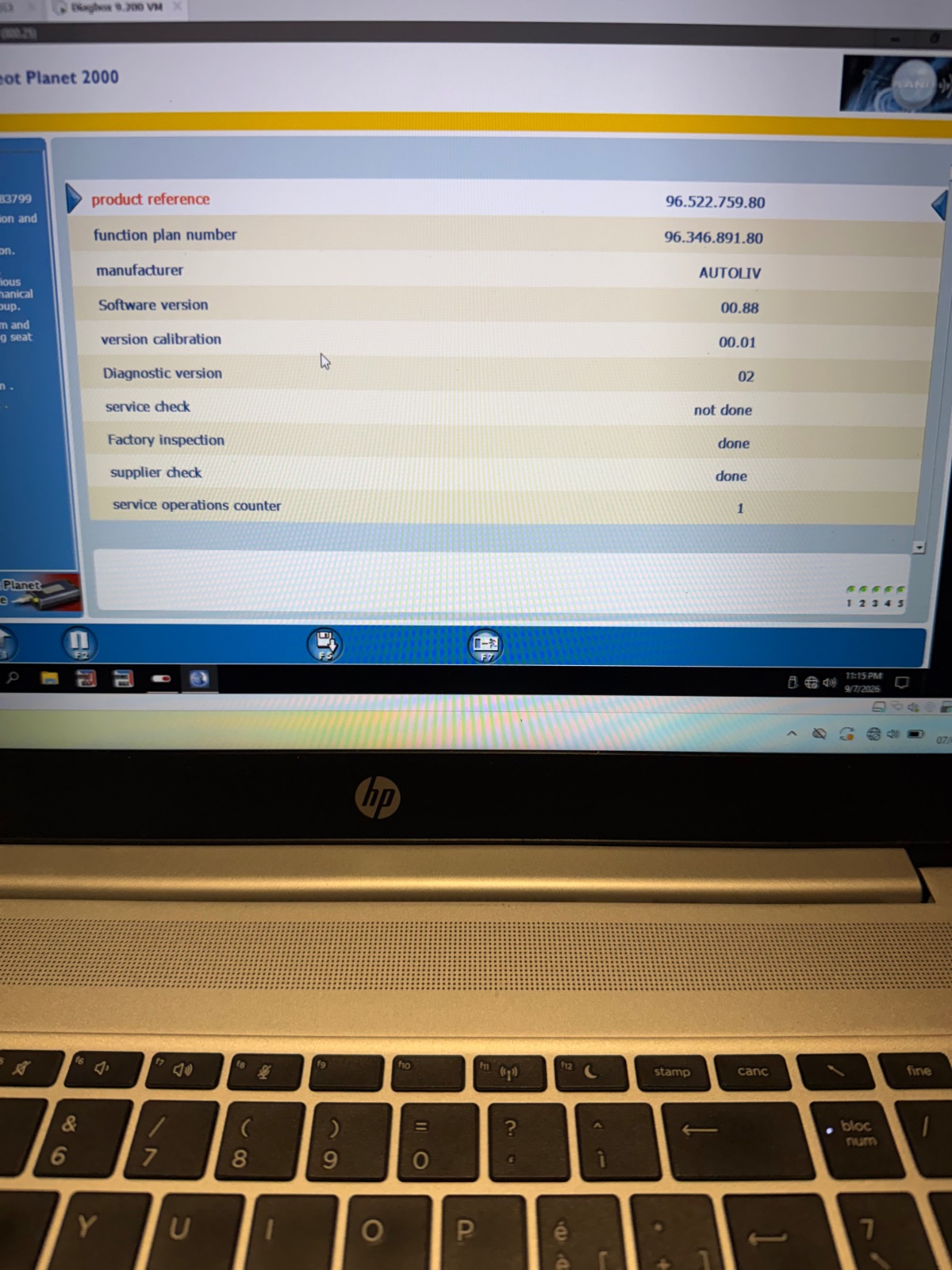

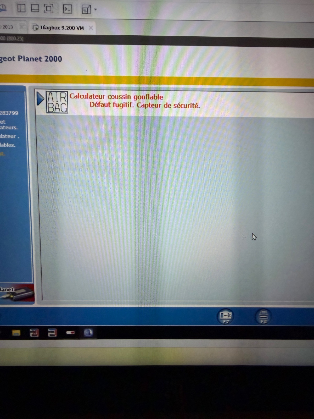

Re: Peugeot 206 1.4 HDi intermittent airbag fault
Hi all,
As promised here a few pictures of the fault codes, in French and in English. I also took a picture of the ecu config. No live data is available from the airbag ecu.
Thanks in advance!
Davide
Thanks in advance!
Davide
