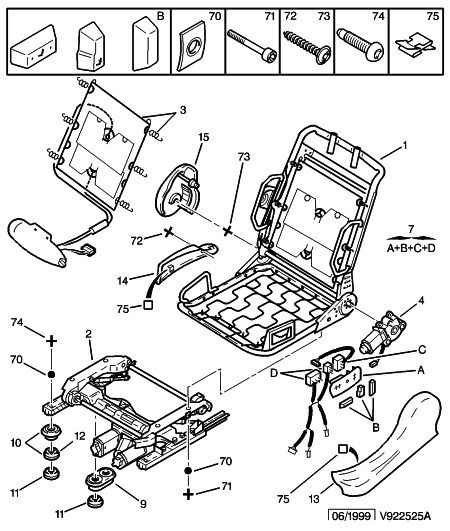

Re: Lame Xantia Electric Seat - Ideas Welcome
From the exploded diagram, the seat part certainly appears to be bolted to the runner part, looks like 4 bolts, fitted from underneath. The outer 2 are probably not too bad once the plastic edge trim is removed. The inner 2 look harder - depending on access from front / rear it may be necessary to remove the other seat and centre console to get at them.
Sounds preferable to at least explore before cutting holes in the floor!!
