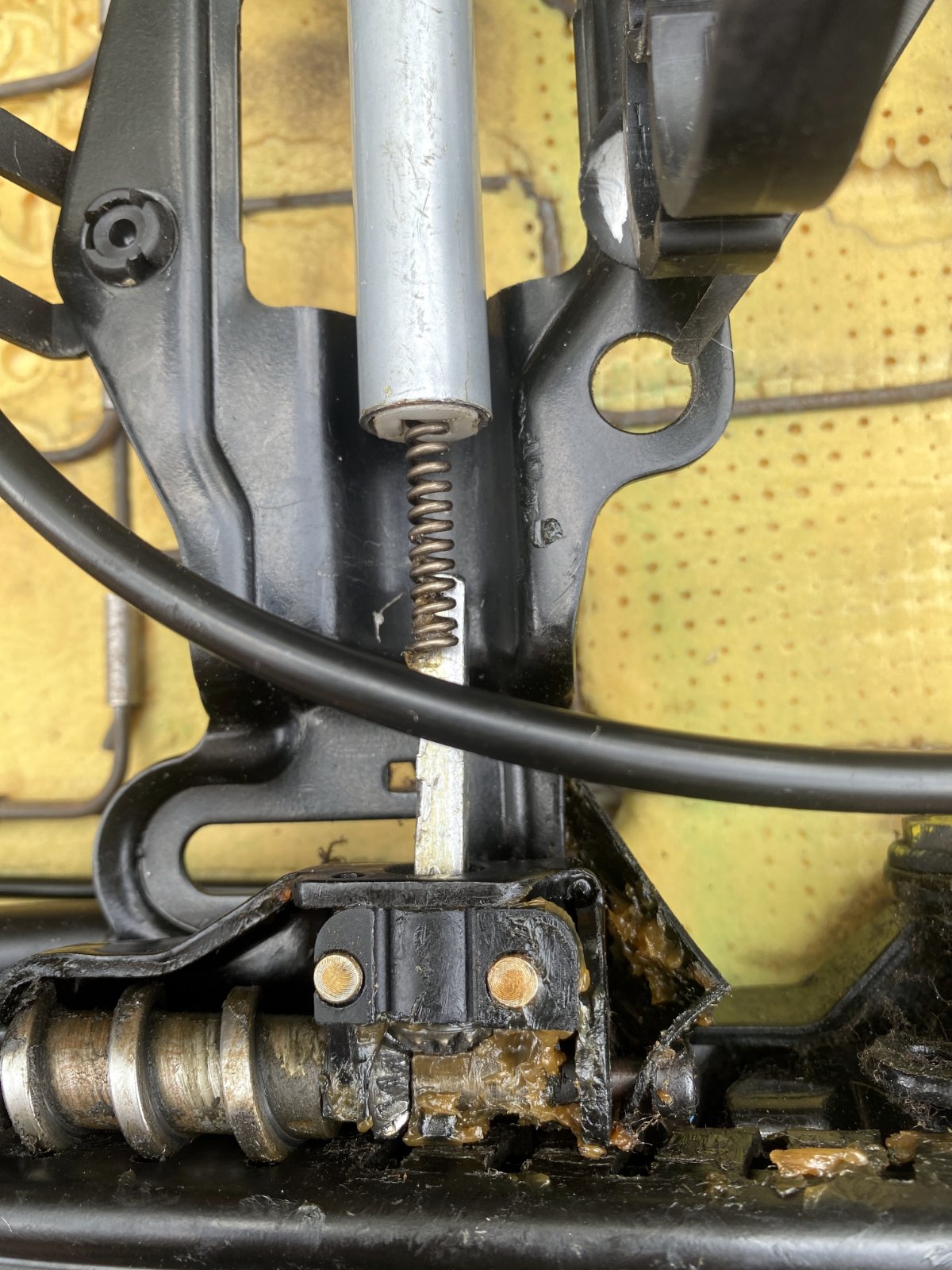

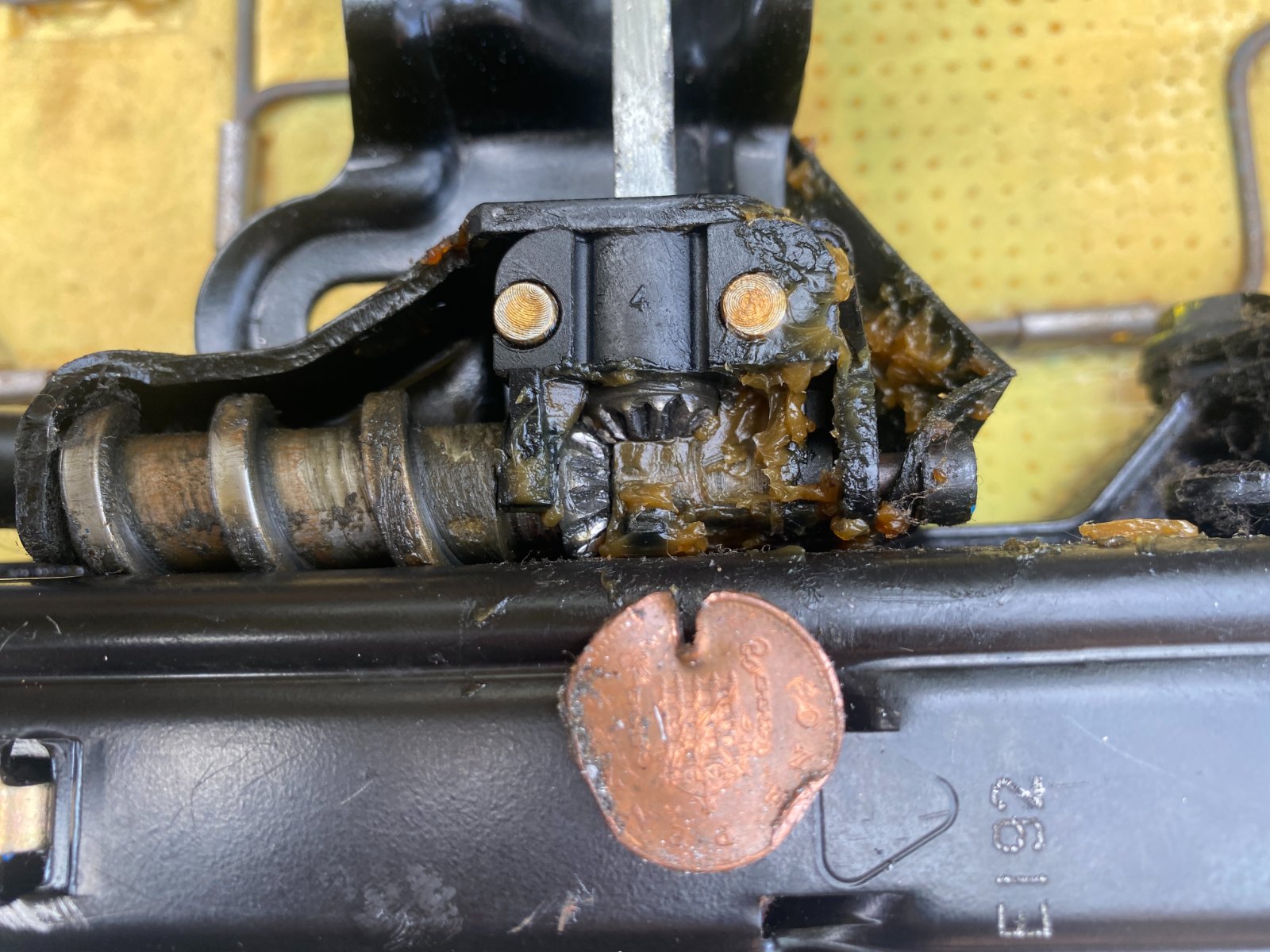

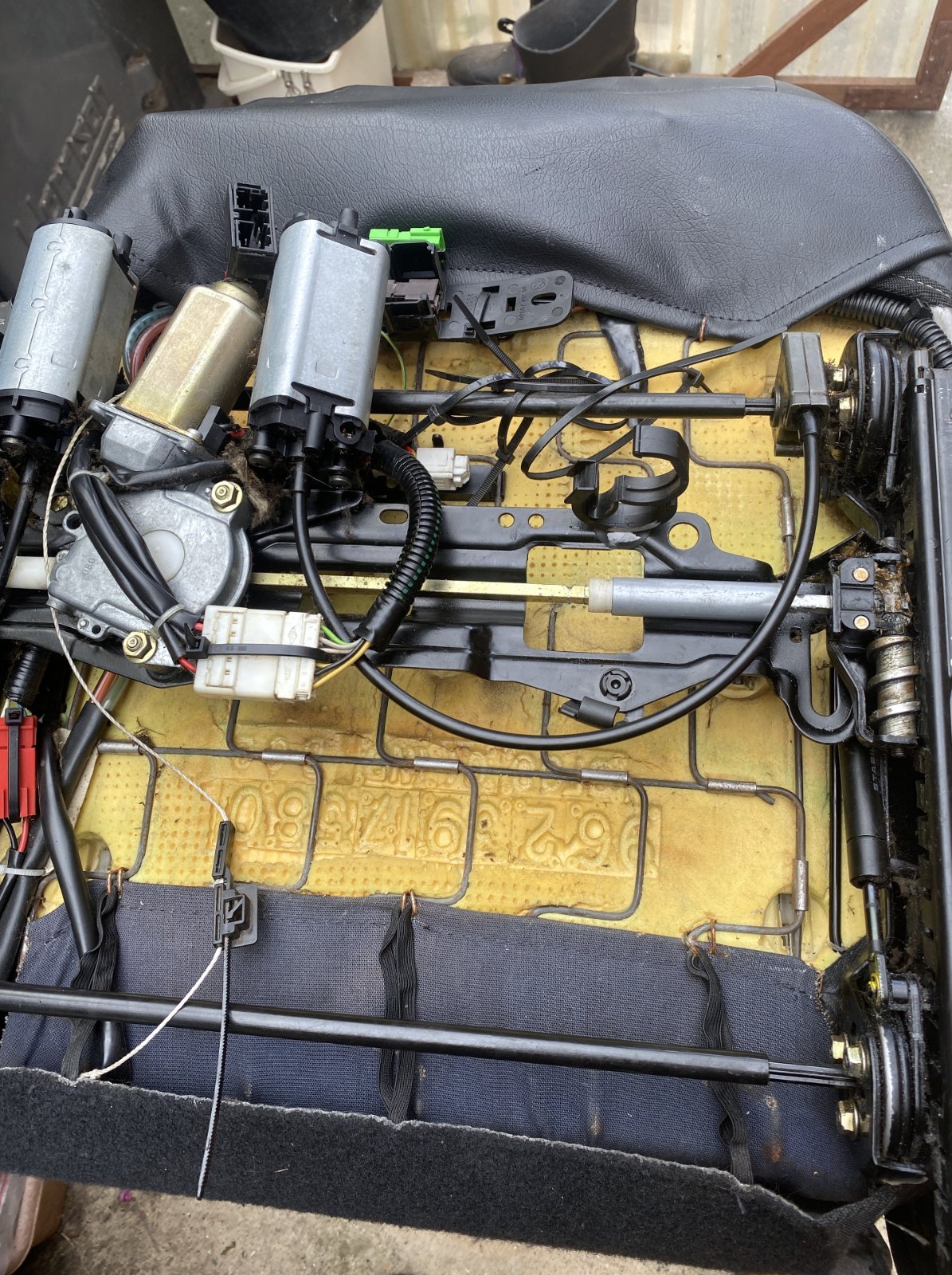

Bingo! Upper seat bolts were impossible to get to so ended up turning to my power hacksaw. Fortunately there was just enough room to get the blade in so it took a while to cut through the bolts. The rubber mounts and spacers beneath the bolts were found to be in reasonable condition so was able to use again. Because of my policy of not throwing anything away (drives wife mad) I was able to find some pipe just right for sleeving the araldited plastic coupler. All it needed was a light skim on the lathe for a nice snug fit. The coupler and inline spring were reassembled in the mechanism after lining up both sliding rails. The obstruction was found to be a penny coin which somehow got itself up into the rail and was well out of sight ……not a job I’m in any rush to do again. I’ve included a view of the culprit and a couple of views of the seat drive mechanism for reader’s interest. Works fine, all good and thanks again folks for your advice and interest, Regards Alan
General underside view
Spring detail (a little patience required here!)
Final drive detail + the horror
