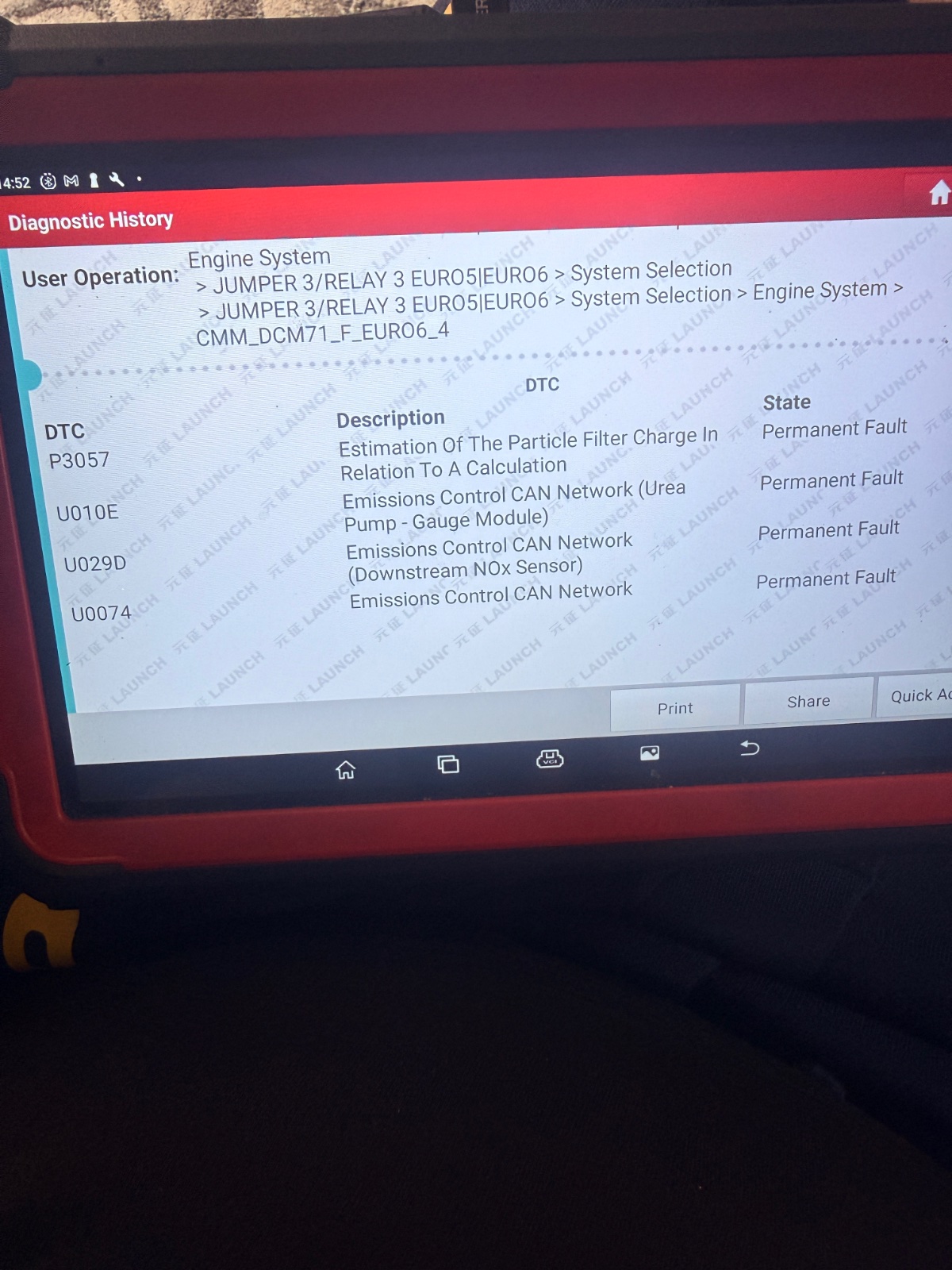

I’m having an issue with a 2024 Citroen relay van. It’s a 2.2 DW12RUD (4HB).
Basically the adblue system has decided to stop working. Currently display 612 miles left and flashes up check adblue system.
I’ve scanned it with my launch machine and the only thing that is coming up is
p3057
U010E
U029D
U0074
Screen shot attached
I’ve checked all the fuses in the drivers side (rhd) of the cabin, I’ve also checked fuses in the engine bay (near side) as I suspected all them tighter might suggest the module is down. I designated the adblue pump and rechecked, no difference and then tried the downstream nox sensor and still no change.
So my guess is the emissions module has either given up, or there’s something else causing the issue.

In correcting the rotation of your image I think I may have clipped the right side. Sorry about that. If I am right can you repost the picture after opening it and saving it in the correct orientation in a program like Paint. :)

Try deleting the faults and then see what comes back. You can reset the de nox system which will restore put the light out and avoid the countdown - till it faults again. I would guess at a broken wire somewhere pulling the network down.

mickthemaverick wrote: 29 Aug 2026, 13:49 In correcting the rotation of your image I think I may have clipped the right side. Sorry about that. If I am right can you repost the picture after opening it and saving it in the correct orientation in a program like Paint. :)
The image should show “permanent faults”

RichardW wrote: 29 Aug 2026, 13:56 Try deleting the faults and then see what comes back. You can reset the de nox system which will restore put the light out and avoid the countdown - till it faults again. I would guess at a broken wire somewhere pulling the network down.
That was the first thing I did. Says it’s cleared but the fault is still there and the countdown timer is still the same

Nelly1712 wrote: 29 Aug 2026, 14:46 That was the first thing I did. Says it’s cleared but the fault is still there and the countdown timer is still the same
I think all you did was to clear the DTC. You need to go into the engine ECU and look for a section called Pack Repair or similar. Then look for réinitialisé nox, or similar. That will restart the mileage countdown.

If it needs a new adblue tank or just an injector then it can be expensive. A search on all the fault codes suggests faults including a communication fault or water in the NOx sensor - if like our Cactus the sensor electrics are under the car and can be prone to water damage. Our Cactus needed a new one at under 3 years old and another a few months ago.

Paul-R wrote: 29 Aug 2026, 22:18
I found reinitialisation of the denox system faults. Did that and it made me wait 6 minutes for the end of the power latch. Says completed, but the timer is still the same. So god know what’s going on 😬
