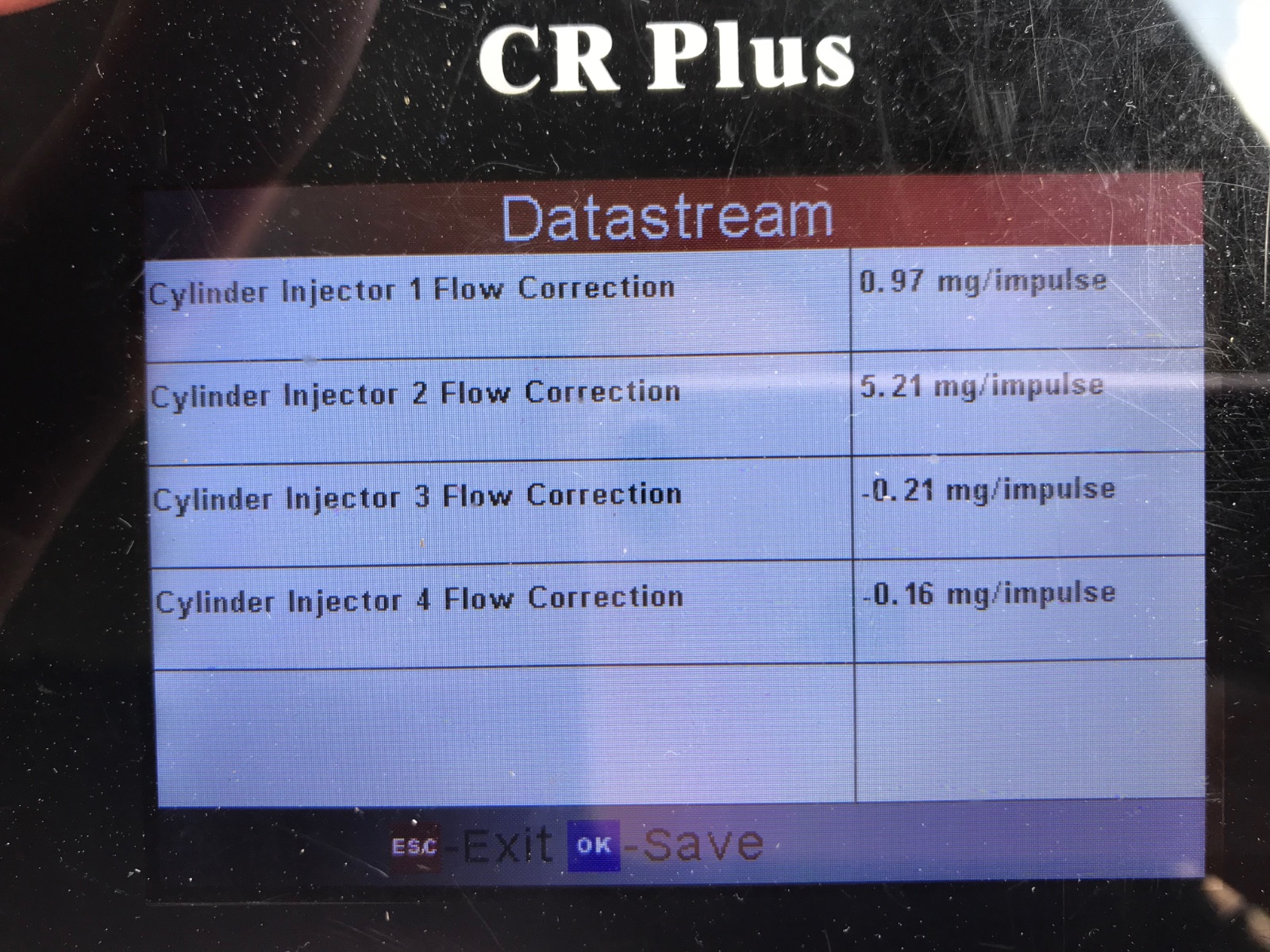

I have a 2008 Peugeot 207 1.6 hdi which is getting poor mpg I can usually get around 360 miles on £40 of fuel but that has dropped to 220 so I have used a scanner (icarsoft cr plus ) which has come up with no faults so I done a live data reading on the 4 injectors and this is the readings I am getting when idling also the in car display that tells you your mpg is all over the place one minute it says 50mpg
then it jumps to 300mpg then 999mpg and then back to around 50mpg and it does this constantly while driving

Having said all the above, looking at your screenshot the correction for injector 2 is a lot different to the other 3 so that injector looks to be on the way out.
I did some back of the envelope sums and I reckon you should have been getting about 250 miles, rather than 220, per £40 at the prices James put forward. So, you're about 30 miles down and maybe that bit can be blamed on the injector. But 110 miles down is due to the price increase.

I take it you have checked the obvious, Airfilter, Fuel filter, no brakes binding? Immediately after your next drive, touch each wheel with your hand, they should be same temperature side to side.
