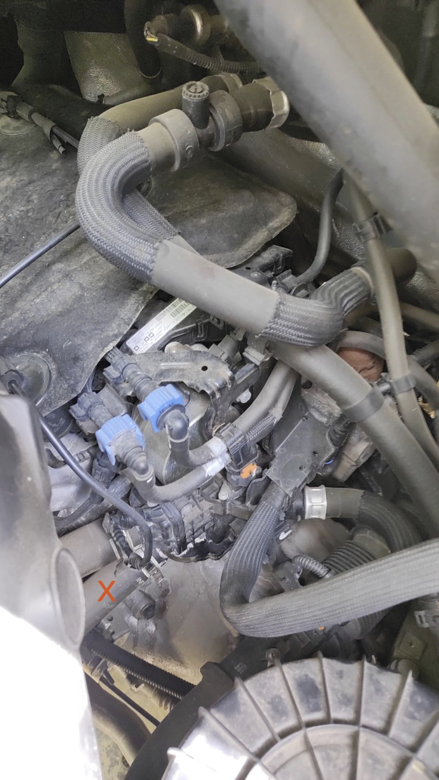

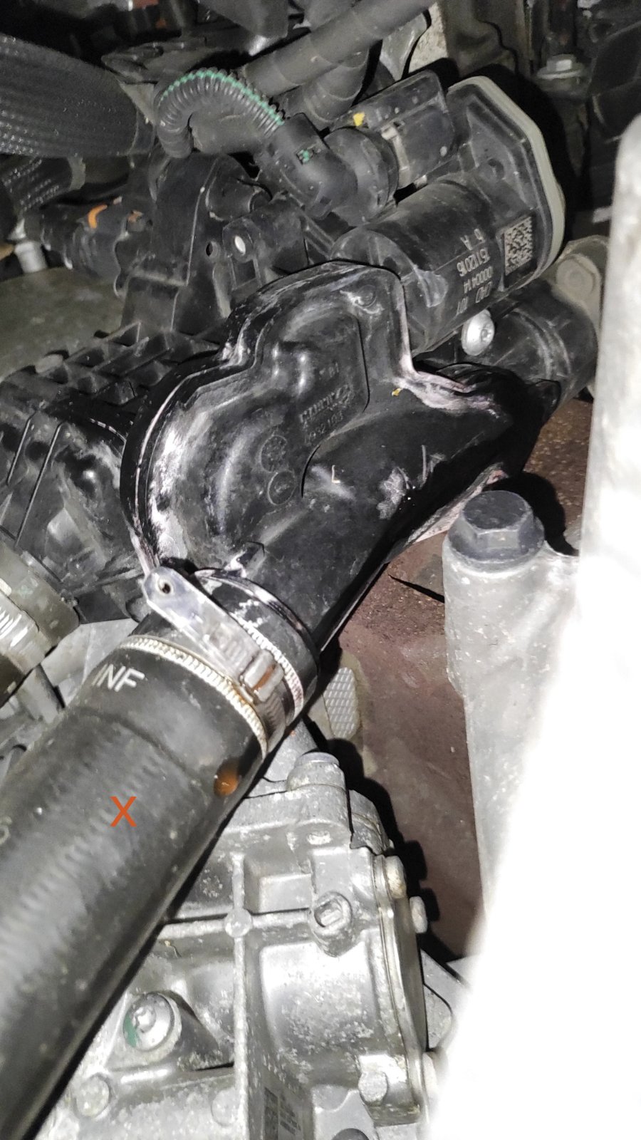

I have a coolant leak on my Boxer and am wondering if it's something I need to take a look at or if it's okay to just top up with coolant when it drops down.
It leaks around 120-150ml per month.
It can't quite get to see exactly where it leaks out but these are the best photos I could get.
The pipe marked with X in both pictures is the same. The second picture is taken from below.
The coolant runs down above the pipe and then runs on to it. I'm not sure the colour is really from rust, but rather from dirt on the outside of the engine.
Appreciate any thoughts!

The hose clip on the lower photo looks to be missing the screw part that tightens it up if it is a jubilee clip. If so it might just need a clip replacement.

Thanks but I think there is a screw on the opposite side, not visible on the photo. But the coolant is running down from above, probably somewhere on the thermostat housing.

Went to the mechanic and they confirmed that the thermostat is leaking. They then tested the coolant for gas leaks and confirmed that the cylinders are leaking a bit. The chemical was slowly changing colour to green.
So that's why the thermostat is leaking.
Obviously changing head gasket and seals was not what I was hoping for. Now considering whether to do something about it or not. It's only a small leak after all. They said the pressure leak is unlikely to get worse, but possibly the thermostat will die at some point.

No Stop-Leak product will stop a pressure leak from the cylinders.....however, I am very surprised that the pressure in the cooling system is not increasing more than it is. Blow-by is not often "leaking a little".
IF it is the case that you have blow-by then it needs doing now. Finding that it needs a new head gasket the way you have and at the time you have allows for a very easy gasket replacement without a head rebuild and other costs generated by a more "violent" event with follow-on damage/contamination.
I would fall on the ... Fix the thermostat leak, refill with clean coolant and Re-Check the head leaking test with a clean/new test kit. If it needs doing OK, if not you waste nothing (even recover the new coolant for re-use)
