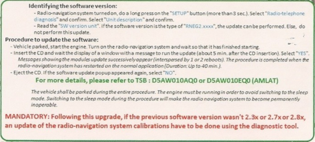

Hello everyone,
I’m having a problem with a black screen on my 3008. How can I find out which version is installed?
- Posts: 9409
- x 1940
Re: RT6 firmware
The firmware version is sometimes written on the RT6 unit itself. Even if present, this presupposes that there haven't been any firmware updates since the car was sold.

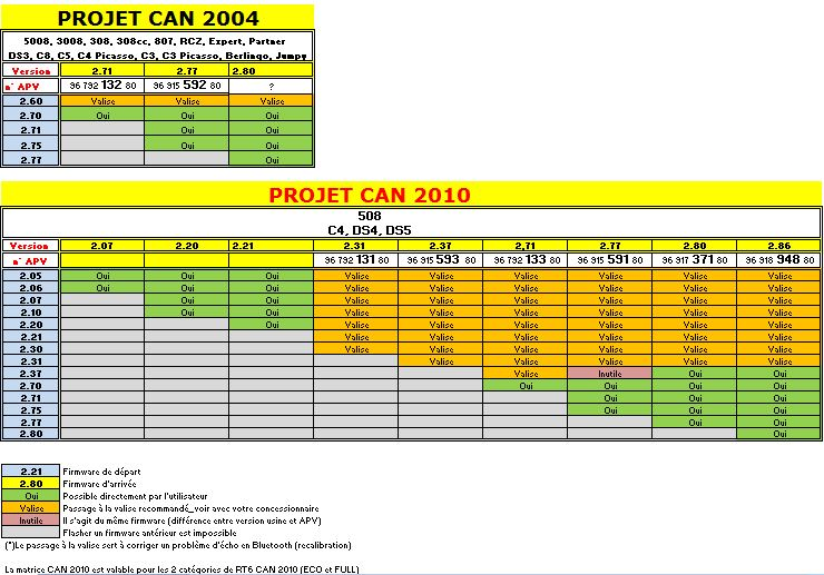

Hi Paul,Paul-R wrote: 31 Jan 2026, 11:30 According to the attached charts updating from 2.21 to any later version will mean losing your configuration settings. This will need either paying a dealer so that they can download the configuration files from the Stellantis servers or using Diagbox to change individual settings. You should be able to use Mirascripts to download the configuration file before you update and then apply it after updating. I strongly suggest that you do this.
Check your PM for a link in five minutes.
I have a 2011 Peugeot 508 with RT6, currently running RNEG2.1.G.5.
I'm having the same Bluetooth problem described by Brandon1998: Bluetooth works, but when streaming music it disconnects and I have to reconnect/pair the phone.
Following your advice in this thread, I've already used RT6 MiraScripts to back up User_com.dat and User_config.dat.
Could you please send me the link for the RT6 2.21 USB firmware?
Thank you very much.
