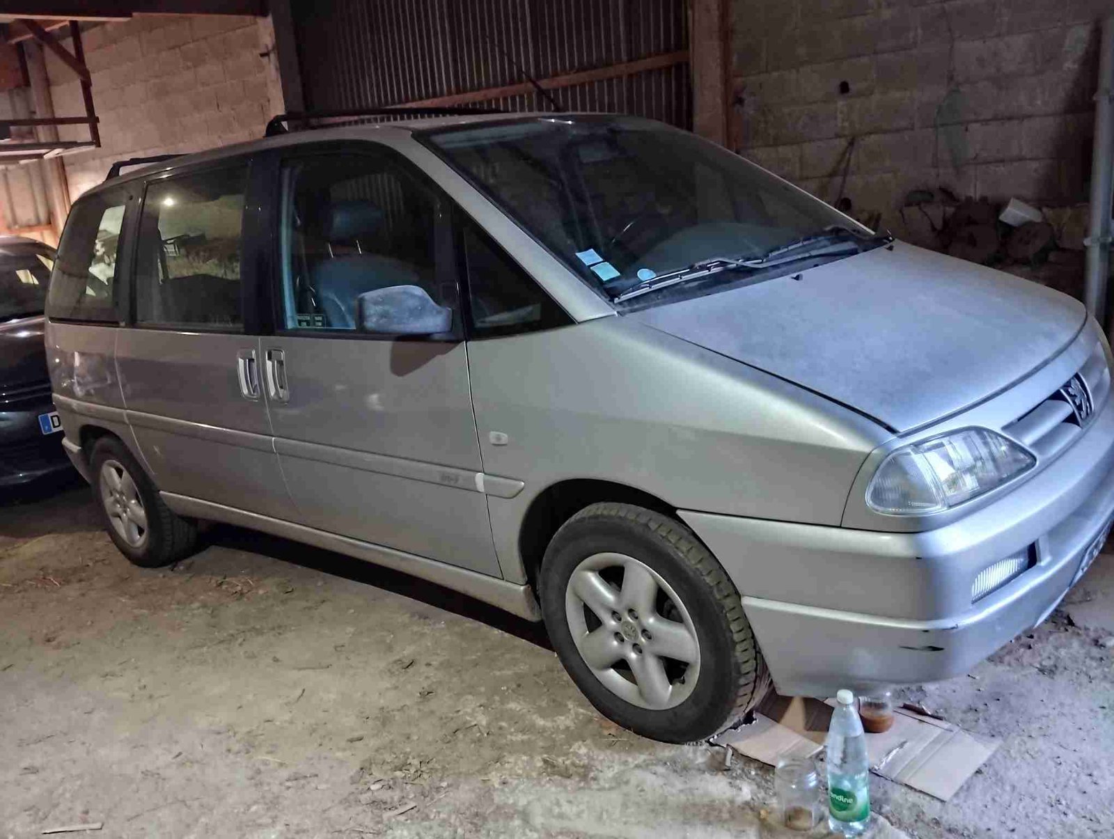

Huskyxantia wrote: 13 Aug 2026, 23:01 :-D I'd love to see a picture of the old car .
Here you go.
Look past the dirt & dust &, except for a couple of small rear end corners dings, the paint & bodywork is in pretty good nick for a car that's 'been well used'. Our local CT tester always comments on the old gals condition.
Sorry about photo taken in barn but she's not moving until ready to return to garage for leak problem.

Nice always wanted one of them several years ago plenty of room and a nice ride, looks in good Nick too

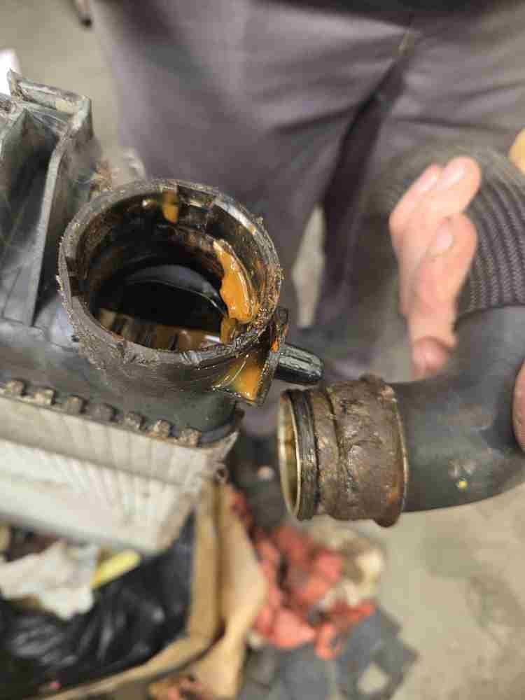

Finally got the old gal back to the garage last Wednesday on a transporter paid by AXA my ins. co.
Garage had a good look to find the leak & phoned to say it was the rad. leaking so about
250 euros to replace it.
Owner phoned again on Friday to say they had found another problem which was a 'special' hose which was leaking causing the rad to 'rot 'out' (my words).
Trouble was the hose was no longer available from manufacturers but he thought he had sourced one elsewhere which should be here next Tuesday (Sept 22) & car should be fixed, so here's hoping.
By the photos he sent me I think the hose is this piece but I'll find out more soon.

After a awful struggle by the garage chaps trying to fit & keep in place the new hose/new bottom rad connection I finally got her back this afternoon.
I was there yesterday afternoon watching them where the clip that held the hose in place just didn't seem man enough to stop the hose blowing off when system presurised possibly because it was a Peugeot rad & unknown (to me) hose supplier as Peugeot part was no longer available.
I left them to it after a while & got a phone call this afternoon saying " it's done & can you collect it asap as we need to free up a lift."
The place was hectic so I didn't get chance to ask the guys what they did but all was well after driving her home & getting things up to temperature so good enough for me ....I hope!
Mme is relieved as she can now take back the hire Pug 208 which she hates 'cos it's got too many gadgets. With the Pug in service again she has no rush to find & buy another car for herself.
The cost of getting the Old Gal back to good nick has risen but still good value to keep her on the road & it's a pleasure to drive once again.

The old gal has been back home for about a week now & Mme has been using her most days.
I was checking for drips for the first few days but given up now as everything dry & reservoir level remains at expected level so all OK.
This is one of the photos our excellent garage owner sent to show the problems. The hose is a push fit with a spring clip to hold it in place.
