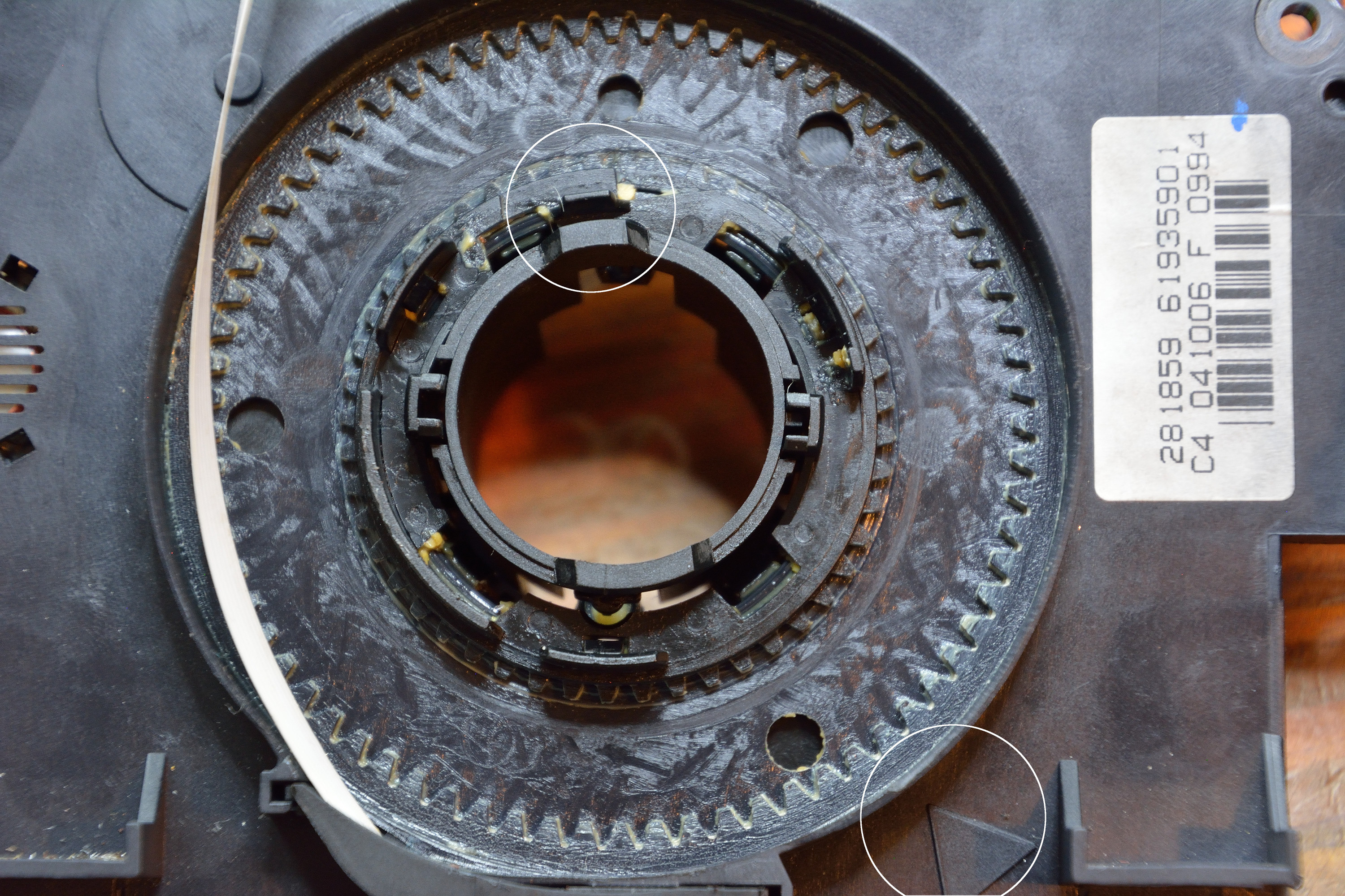

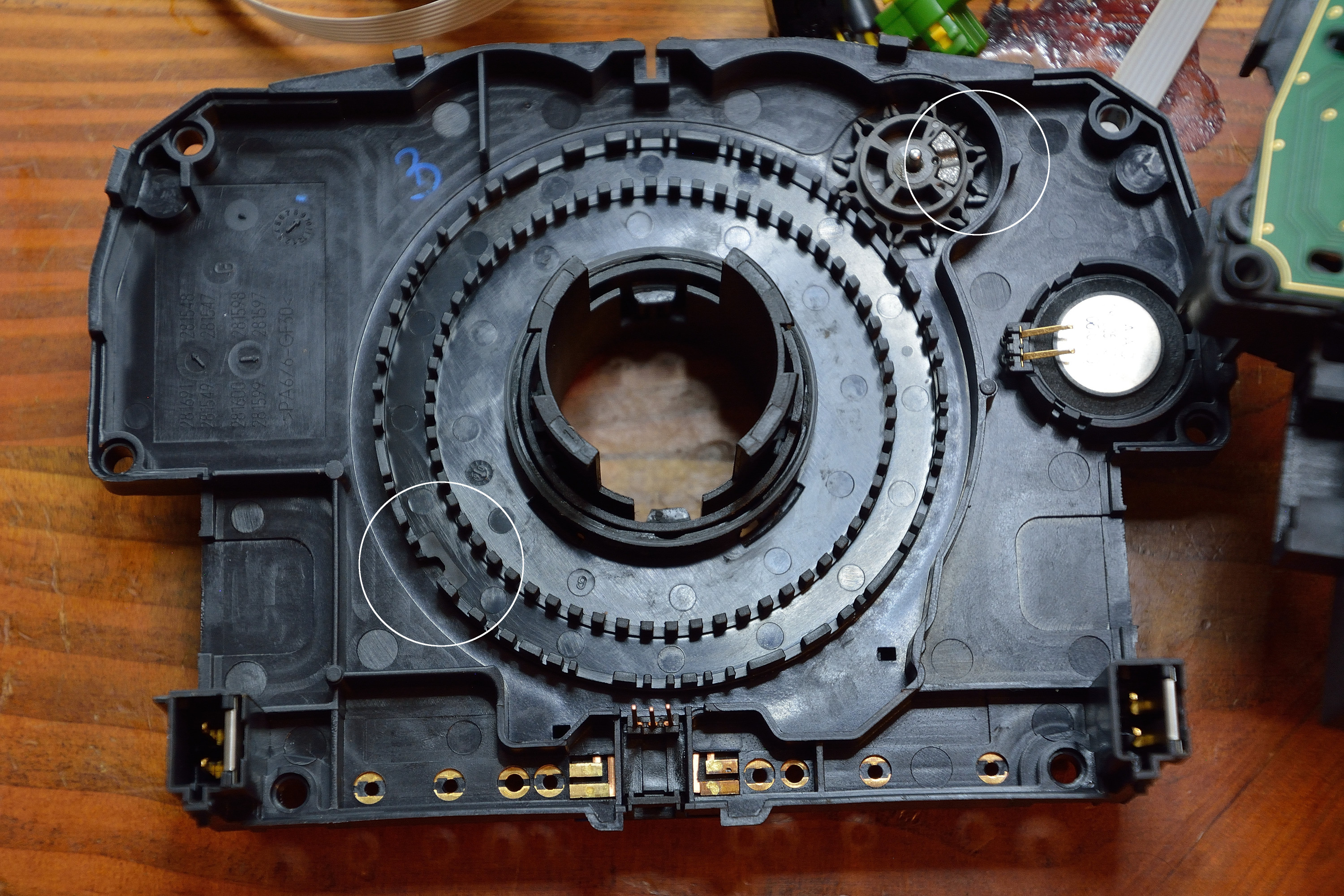

My C5 II had a break in the airbag flex cable of the COM2003 unit. I fixed the airbag cable problem without removing the COM2003 unit and reinstalled it. The airbag issue was resolved, but this time the ESP light came on. The Lexia diagnostic tool showed a fault in the steering angle sensor. I completely removed the COM2003 unit, installed the angle sensor as shown in the picture, and reinstalled it, but the problem persists. The steering angle sensor calibration cannot be performed.
