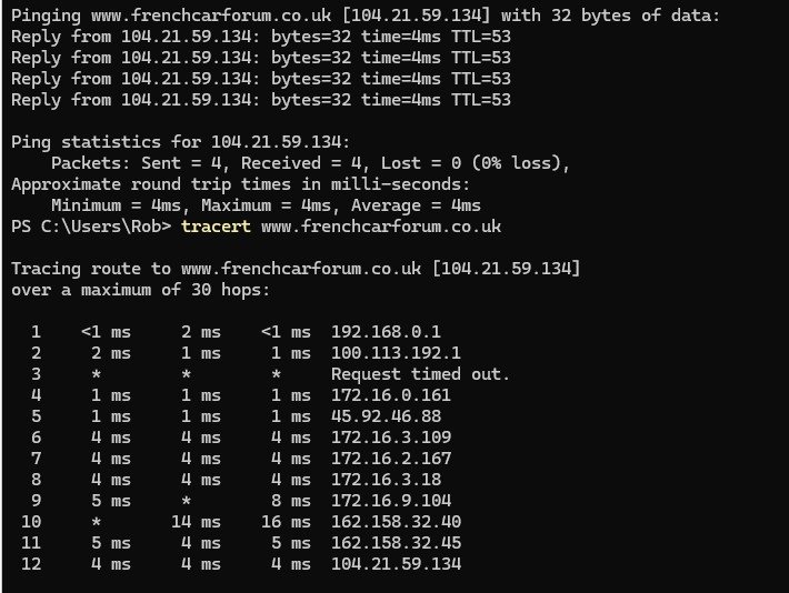

This may be of use to you.
Whilst the ping is great, the actual routing is not.

It might be worth trying the pathping command "pathping www.frenchcarforum.co.uk".

Yes, there is still an issue, but it doesn't seem to be networking-related, and perhaps not in the forum PHP code, leaving the http server software (OpenLitespeed) in question.
It could also be related to Cloudflare, but that seems less likely at this point.
It seems that only http POST is affected, not http GET.
I am working on some diagnostic code, but it may take a while longer.
