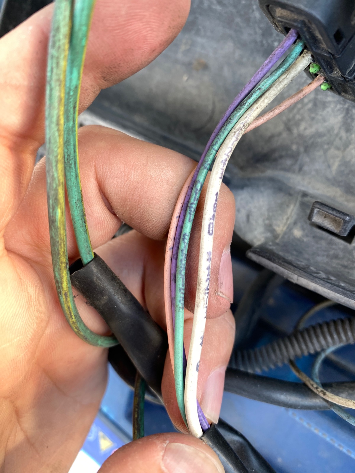

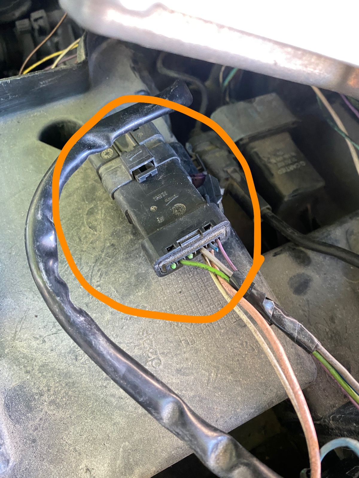

I have one more question: this connector is located under the BSM, and the dark blue wire has been cut. What is the function of this connector? Could you also send the wiring diagram for it? I want to reconnect the dark blue wire.

If you can read the numbers on the connected wires I may be able to identify a diagram with those on it and hence find the connector and then the cut wire. I cannot do it tonight as my system is not available in the evenings but I'll have a look tomorrow if you can identify the wire numbers. :)

The wires from the connector in the photo go to the MAF sensor.

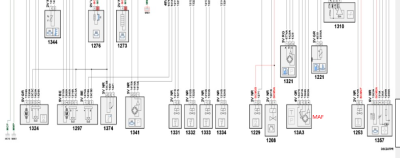

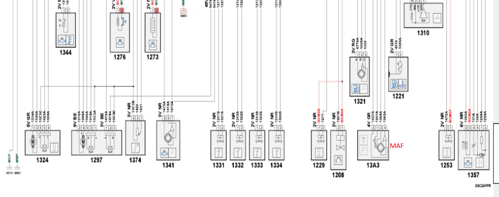

The diagrams are very fuzzy on my system but this is the PDF of the injection system and a print of the bottom showing the MAF sensor. Good luck

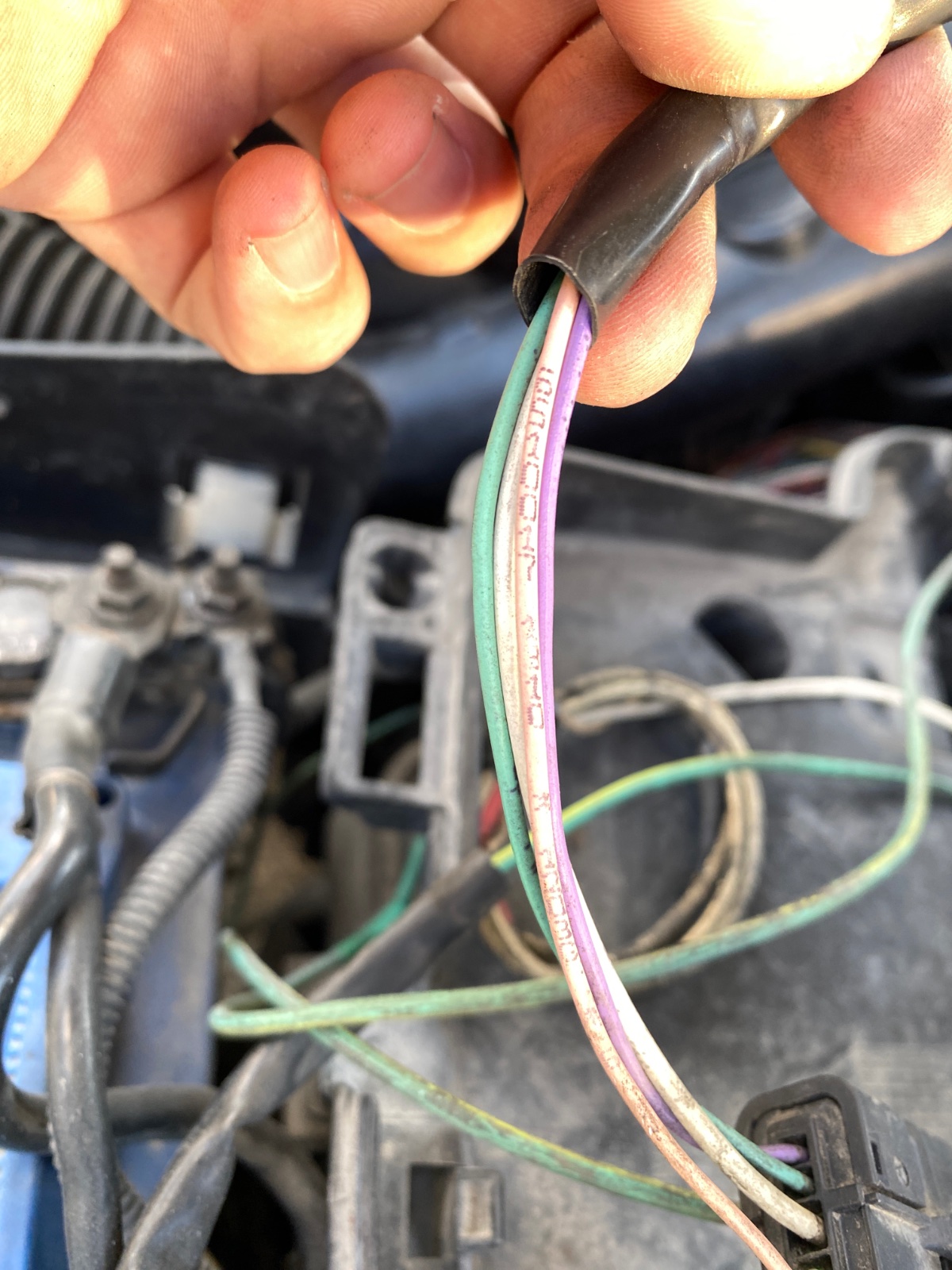

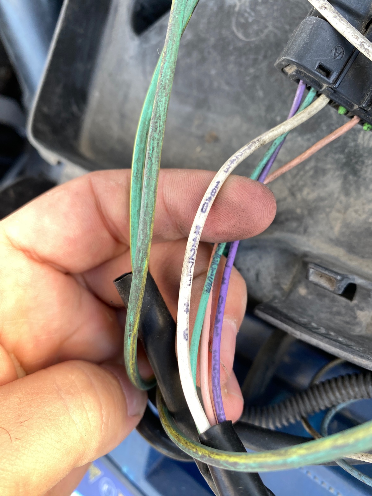

Hello again. I took a photo of the numbers on the cable; I wonder which line these cables belong to?

1410 purple
1810 white
1910 green
1310 cream
