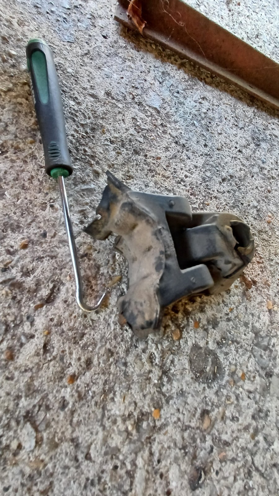

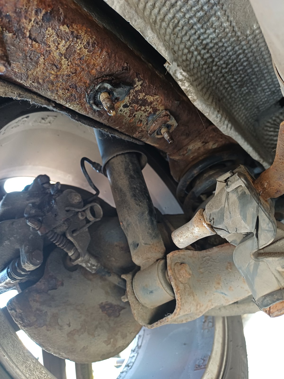

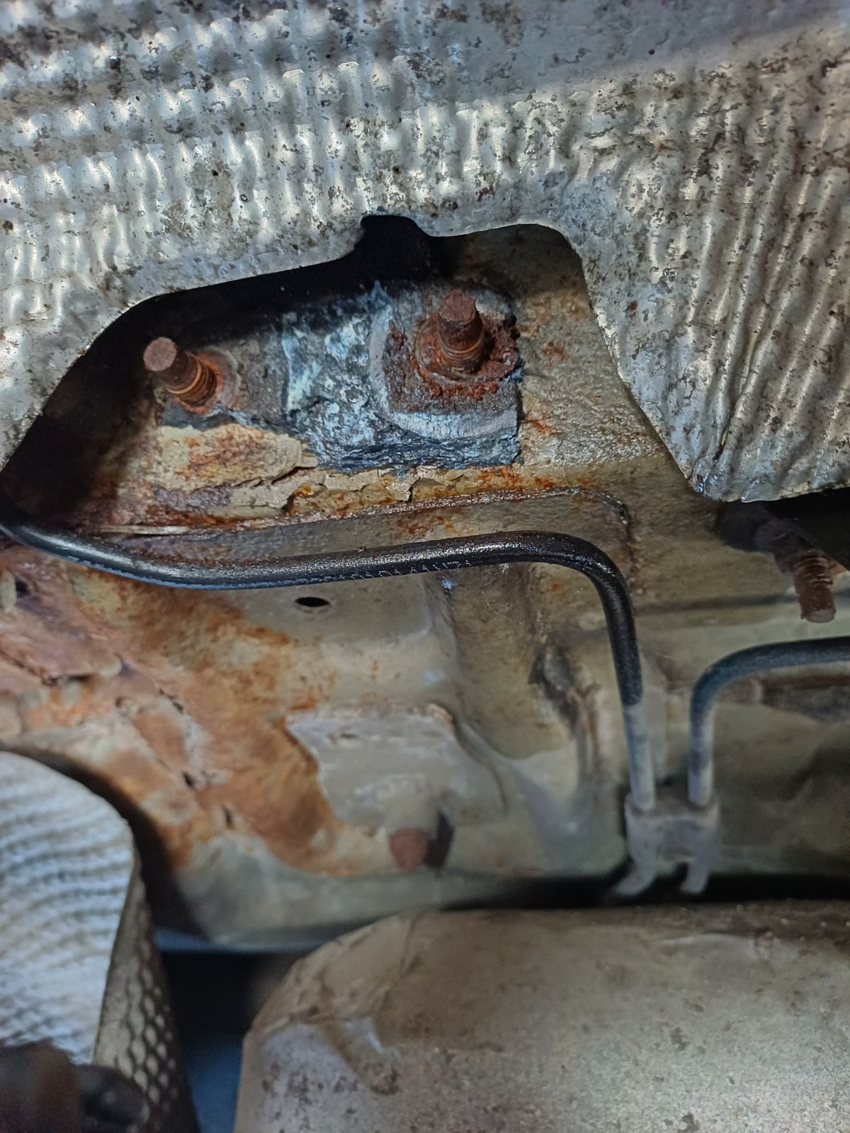

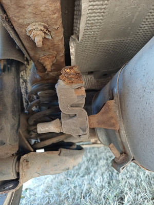

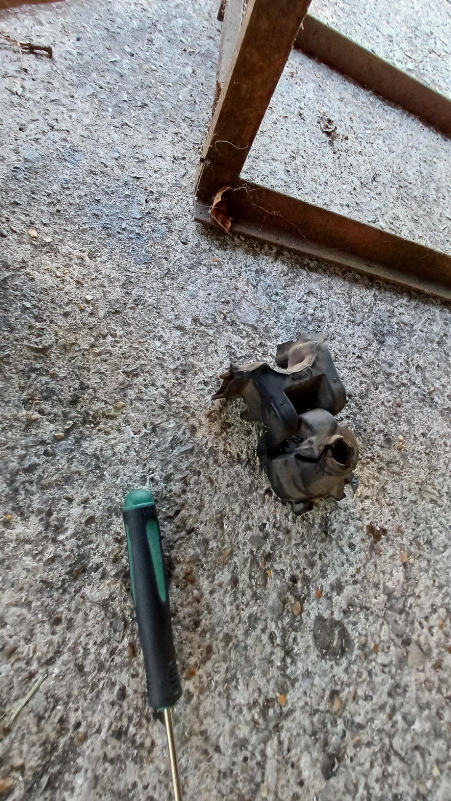

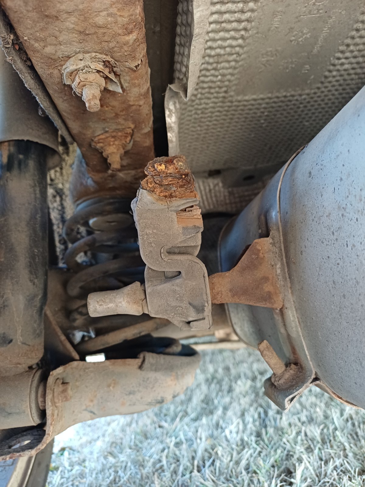

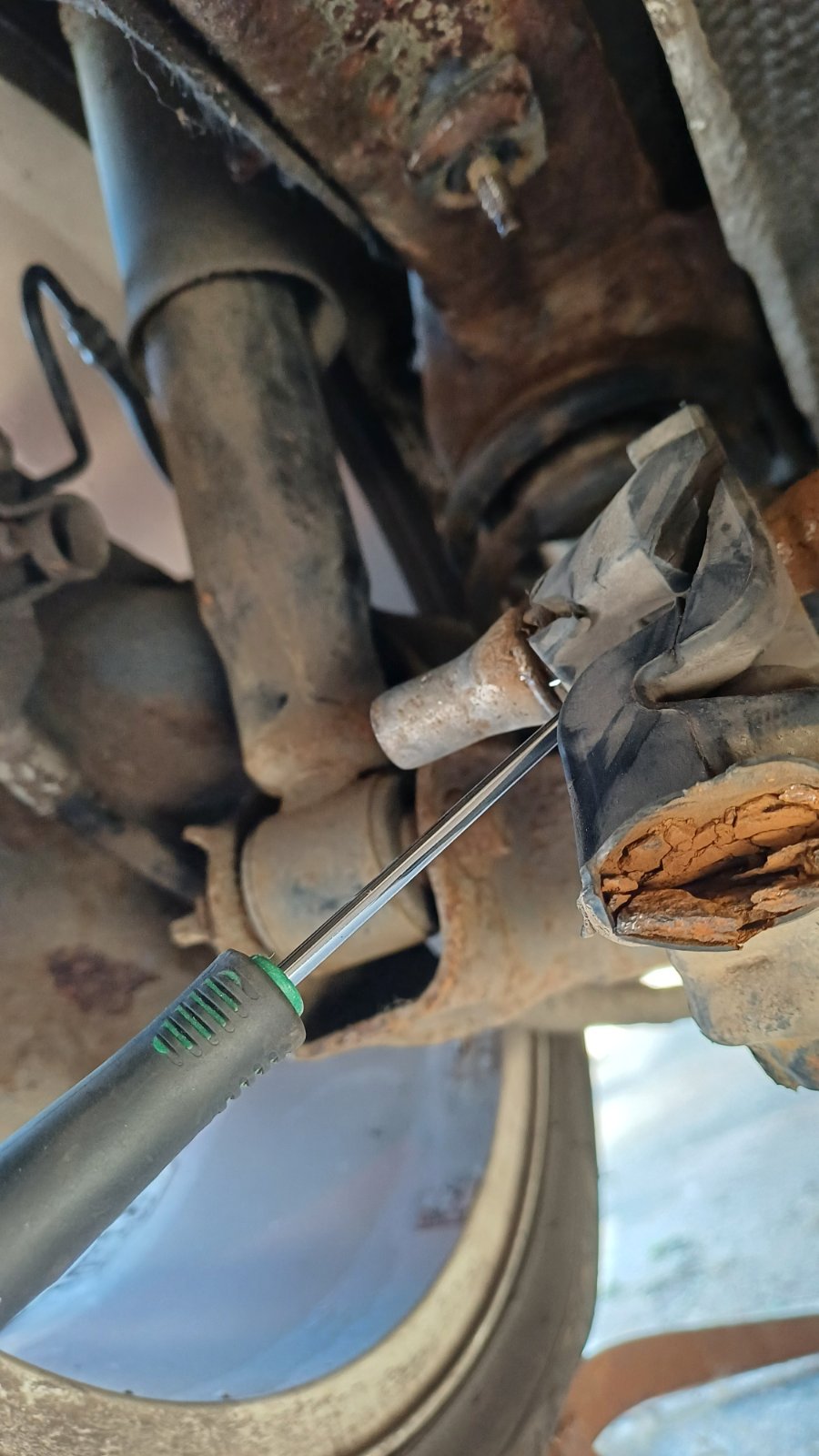

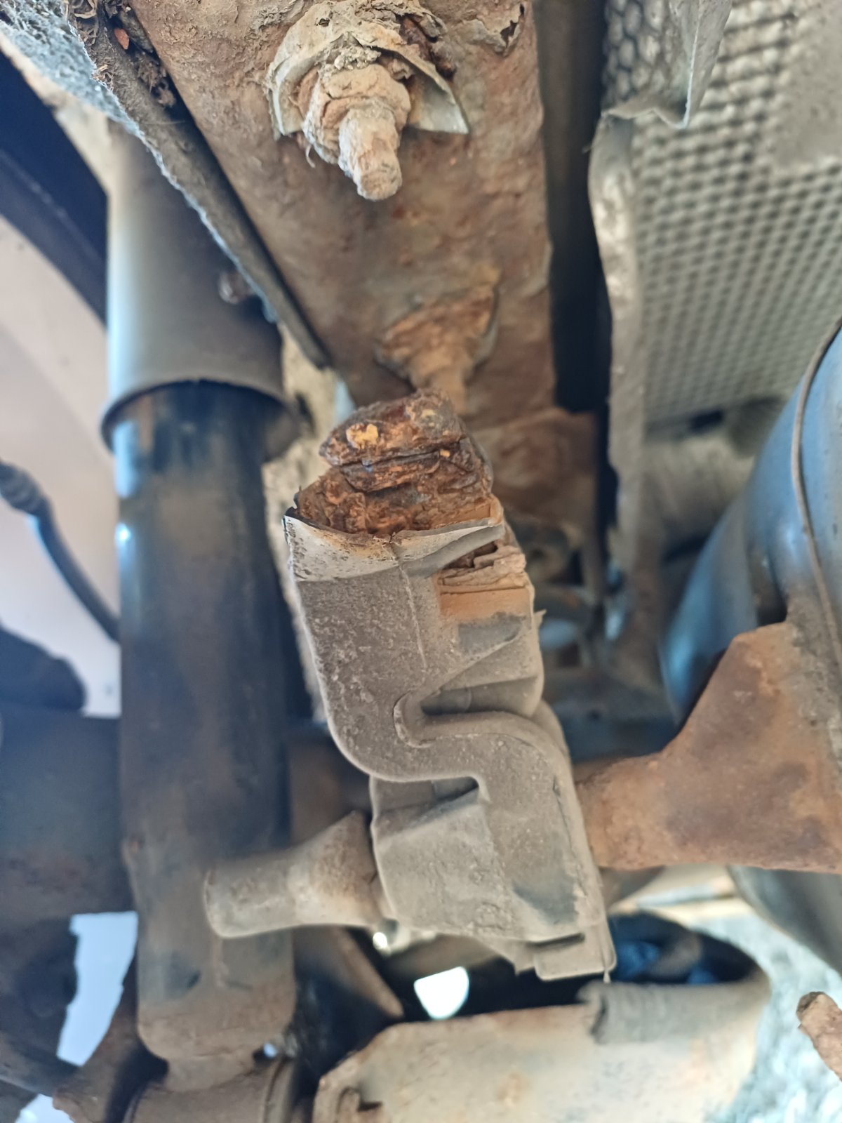

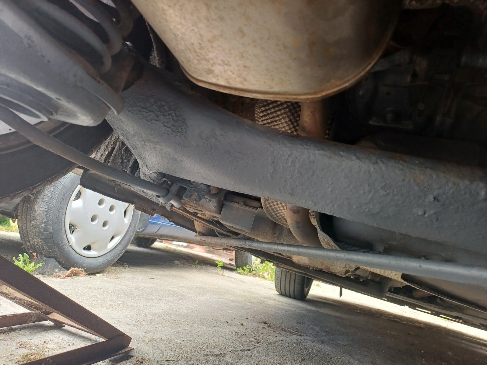

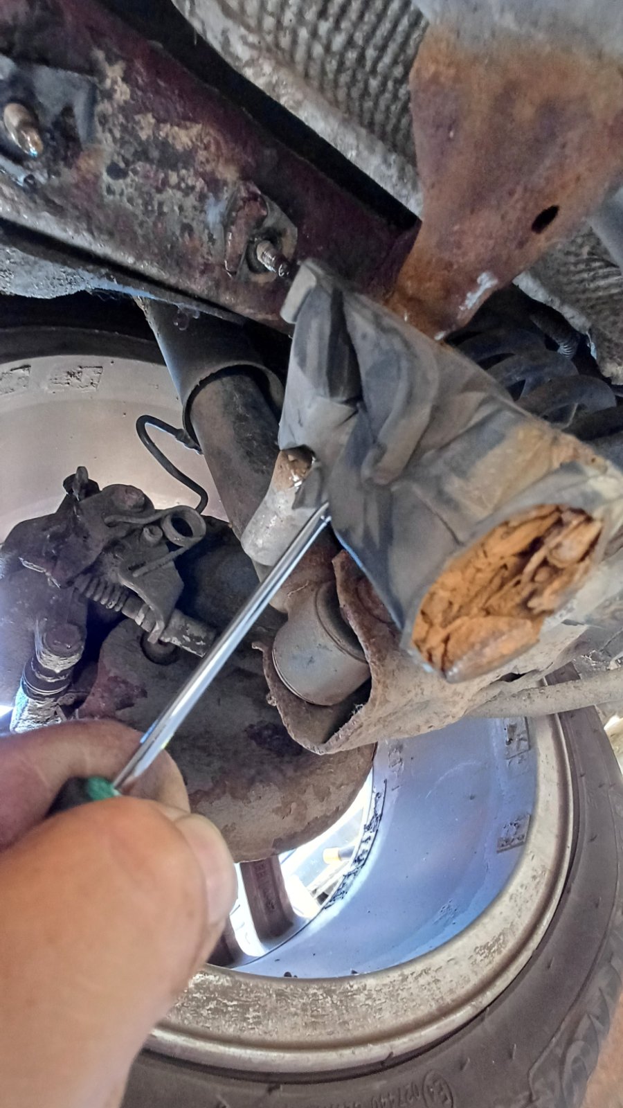

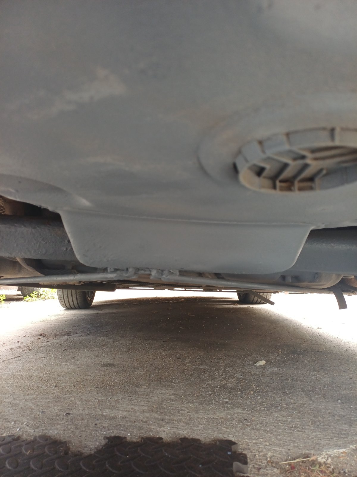

So what i thought was just one hanger snapped off turned out to be both on the rear box so ive cleaned up the area aswell and sprayed some stone chip
Undone the nuts with the rattle gun , less likely to snap as its fast , cut the old rubber bits off there exhaust bits and its all clean and ready for when the 2 new ones arrived Monday. I've also repaired the hear shield too as we all know how these can fail don't we.....
:-D

Caught just in time there Husky - are you cleaning up and treating the full length of that, err, chassis leg section?
I'd give those threaded studs a good wire brush then there's less muck and corrosion for the nut to ride over/through

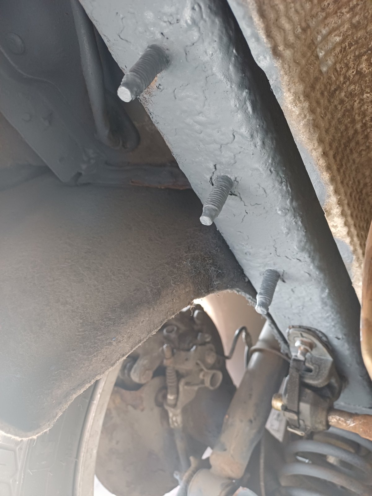

Oh yes there all clean now I will get more afrer shots after these new hangers have been fitted just waiting on the courier. I have wire wheeled lots of surface rust too . I've sprayed plus gas over the bolt threads so when the hangers are put back on the nuts will go on nicely

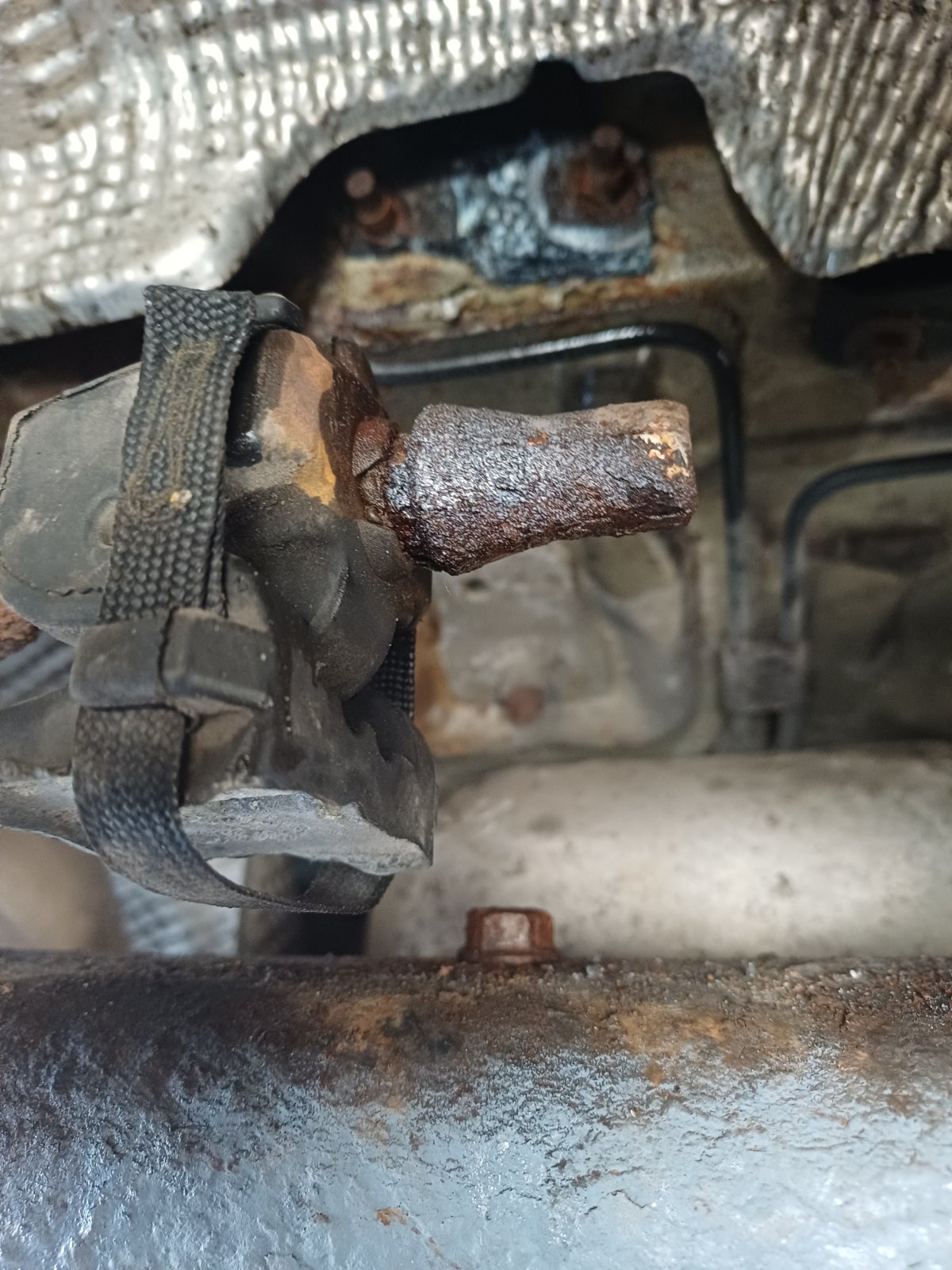

So both hangers / brackets arrived yesterday afternoon and today was a free day for me. Got them fitted was a bit of a faff but got there in the end pattern parts , you know ...

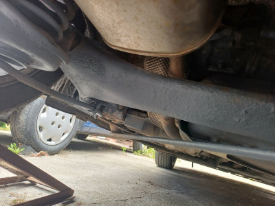

I did more rust proofing too photos to show

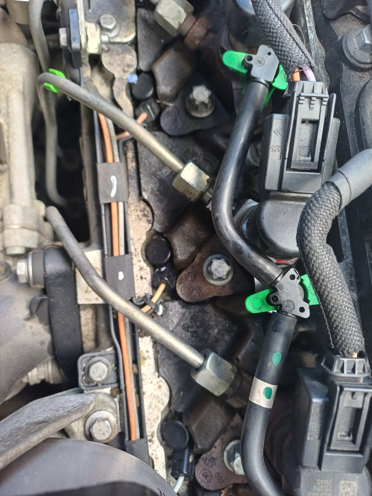

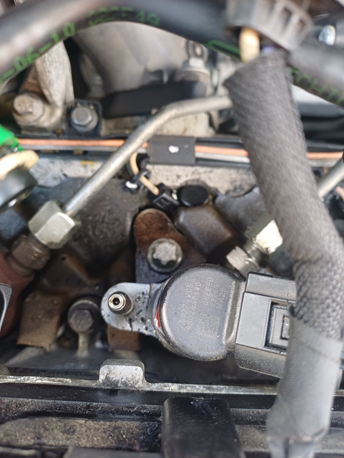

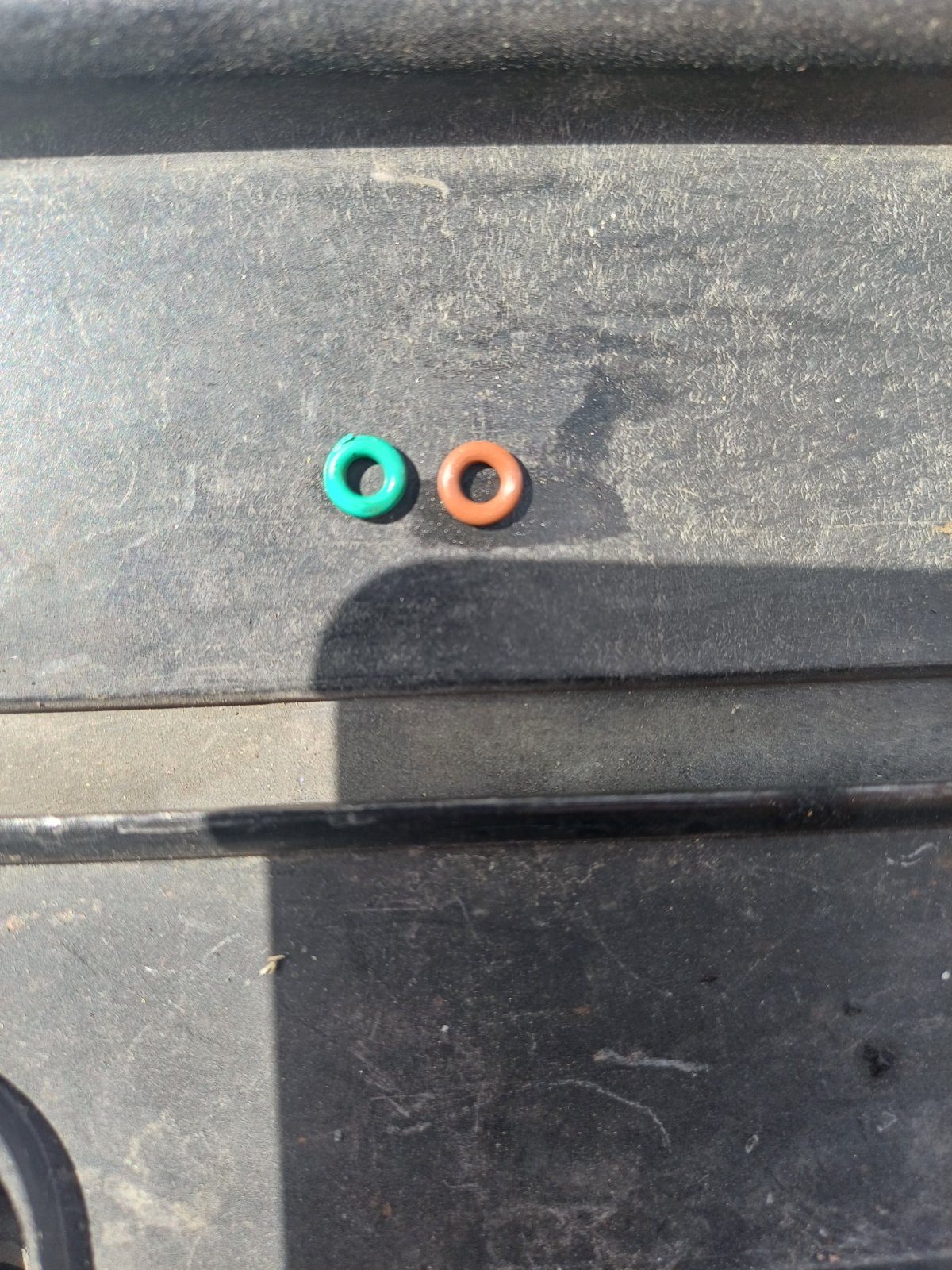

Also investigating the diesel smell lead me to the leak over pipes and one o ring that had split so that got swapped out to. Photos to show...

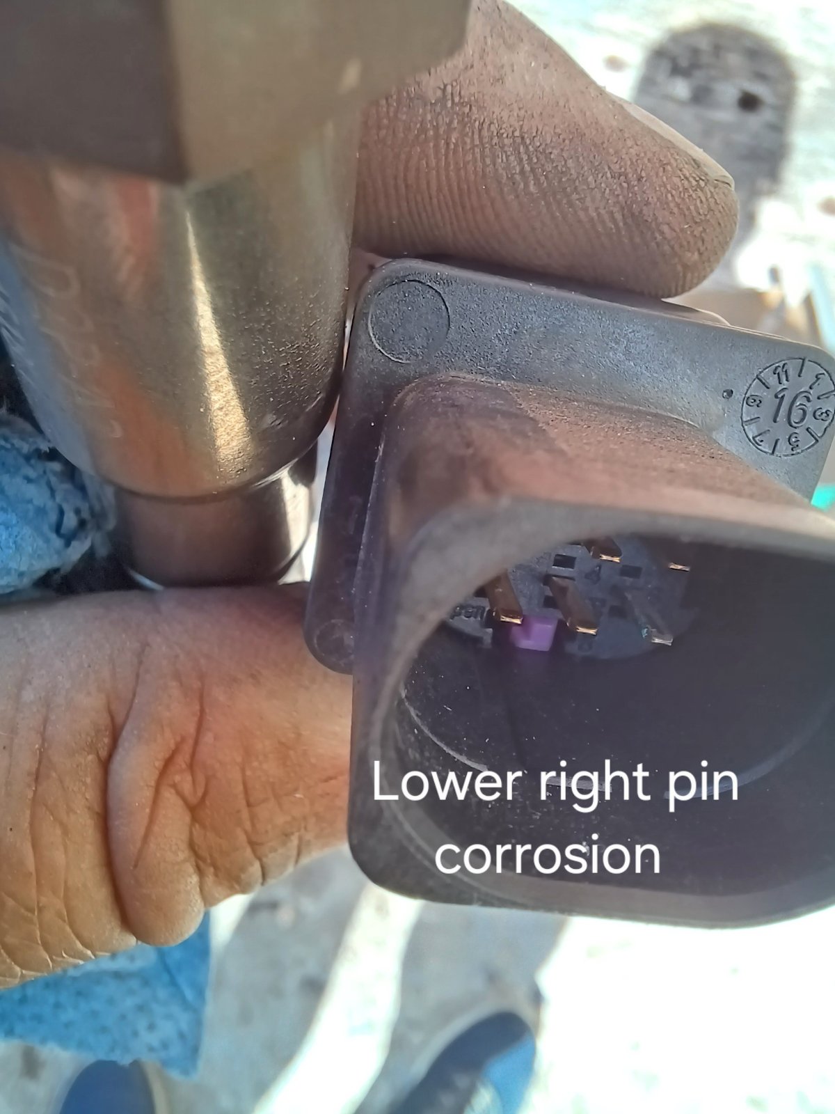

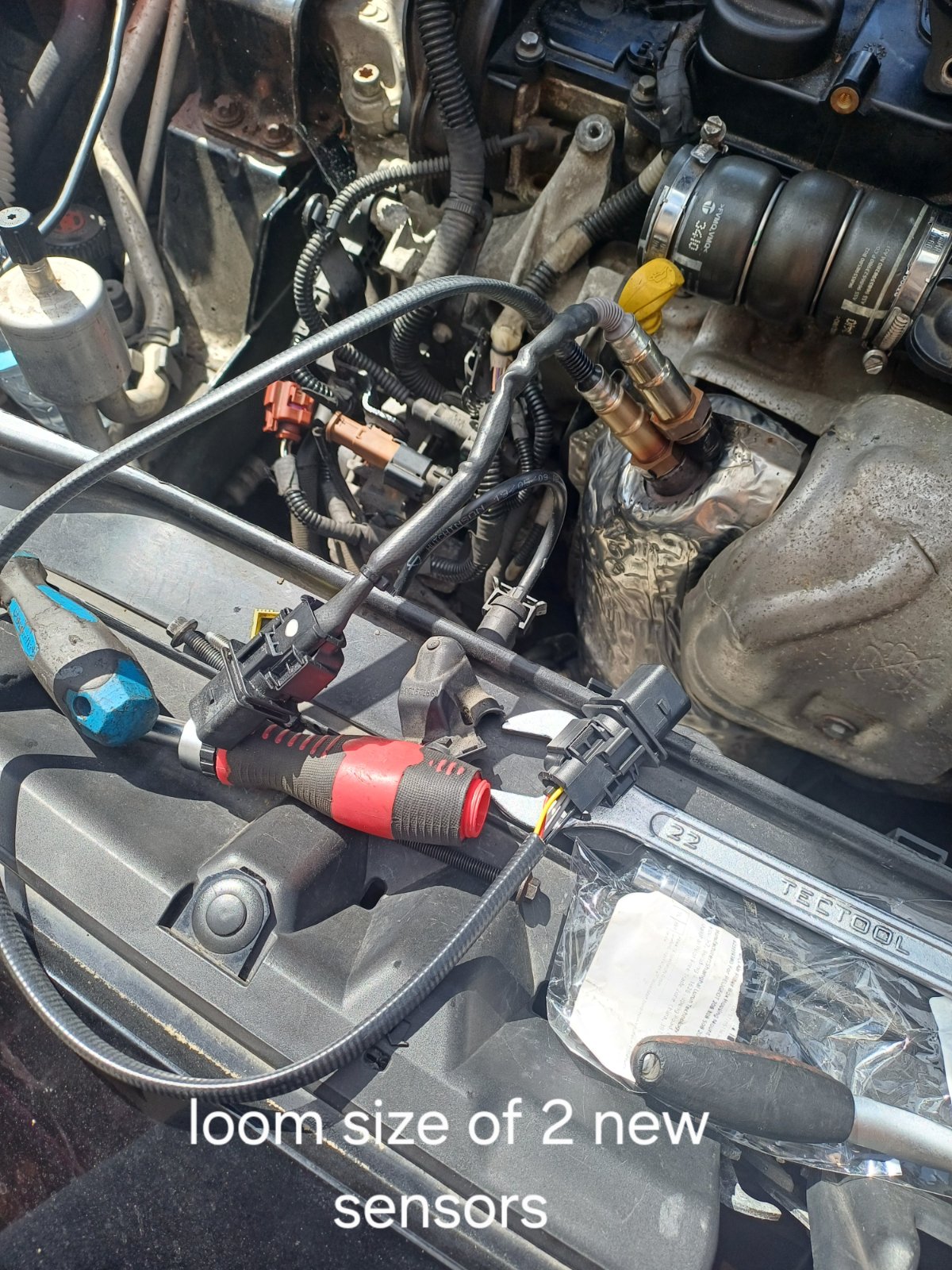

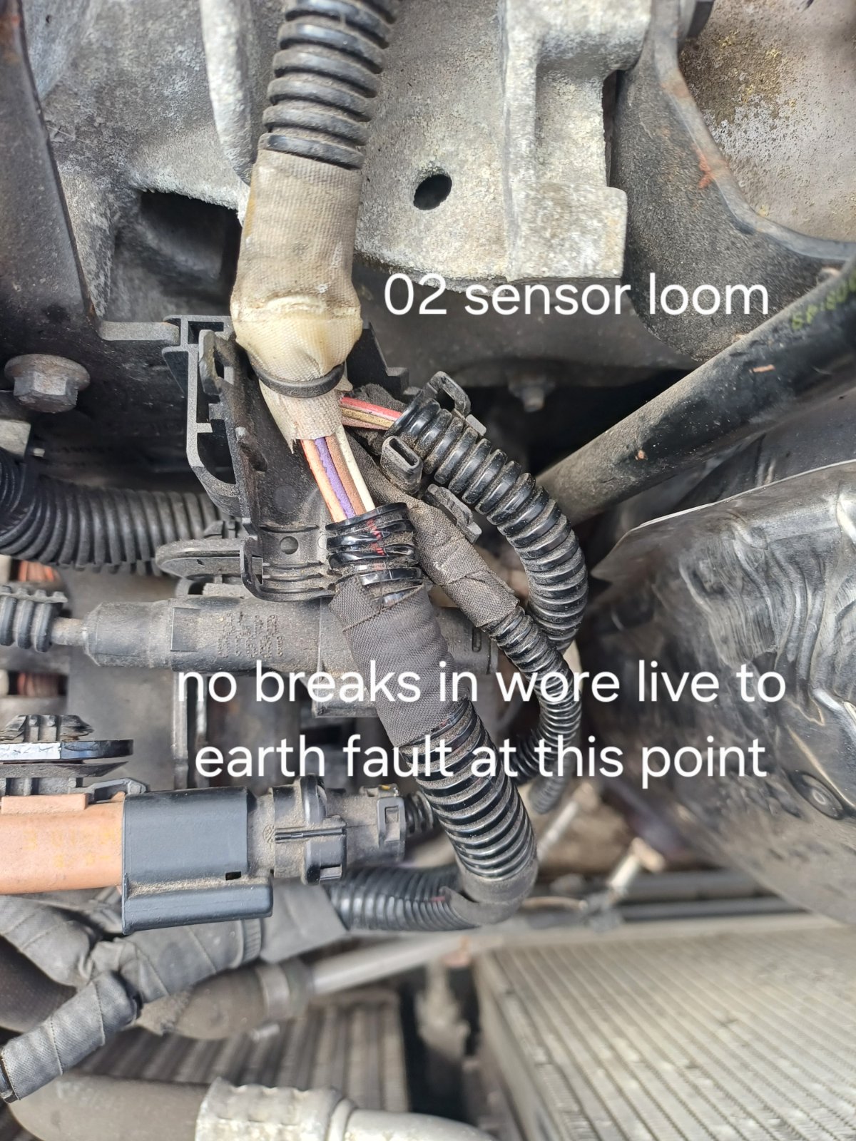

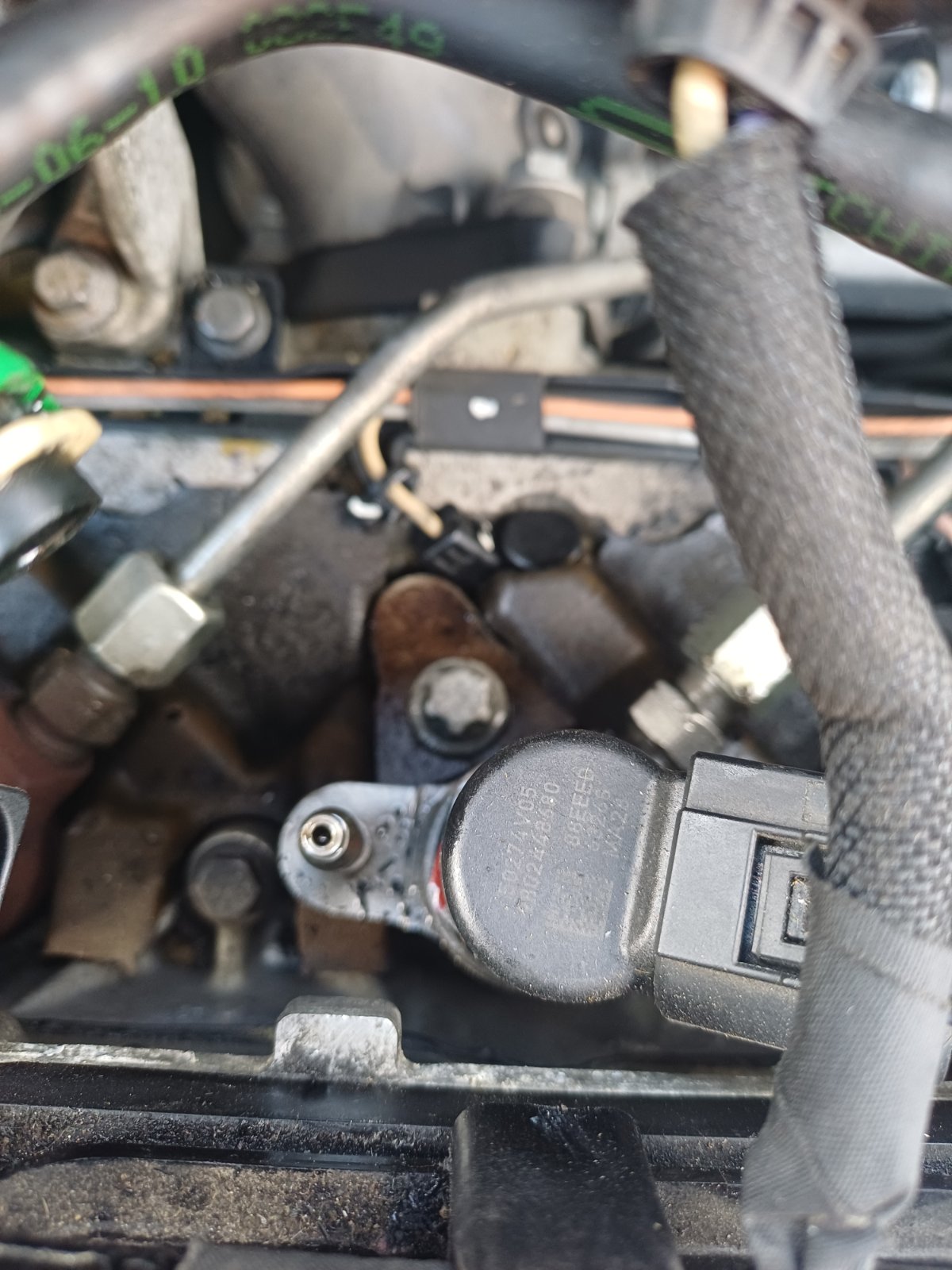

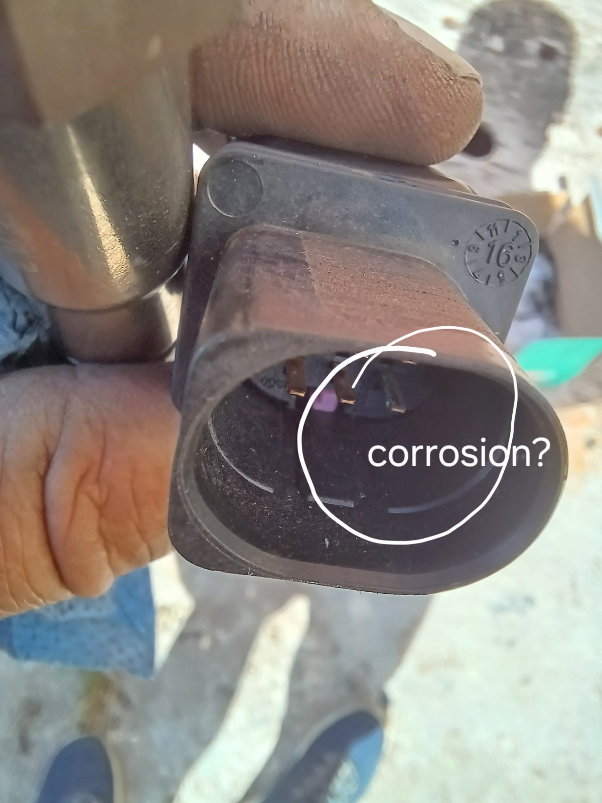

Aswell as another look at the 02 sensor giving a fault of open circuit so I swapped it with another new one , guess what same thing , then compare the old to the new gave me the answer the plug is fatter and 2mm longer so I think its not connecting correctly so that is now left for another day , check out the 02 photos and look at the length of the looms !

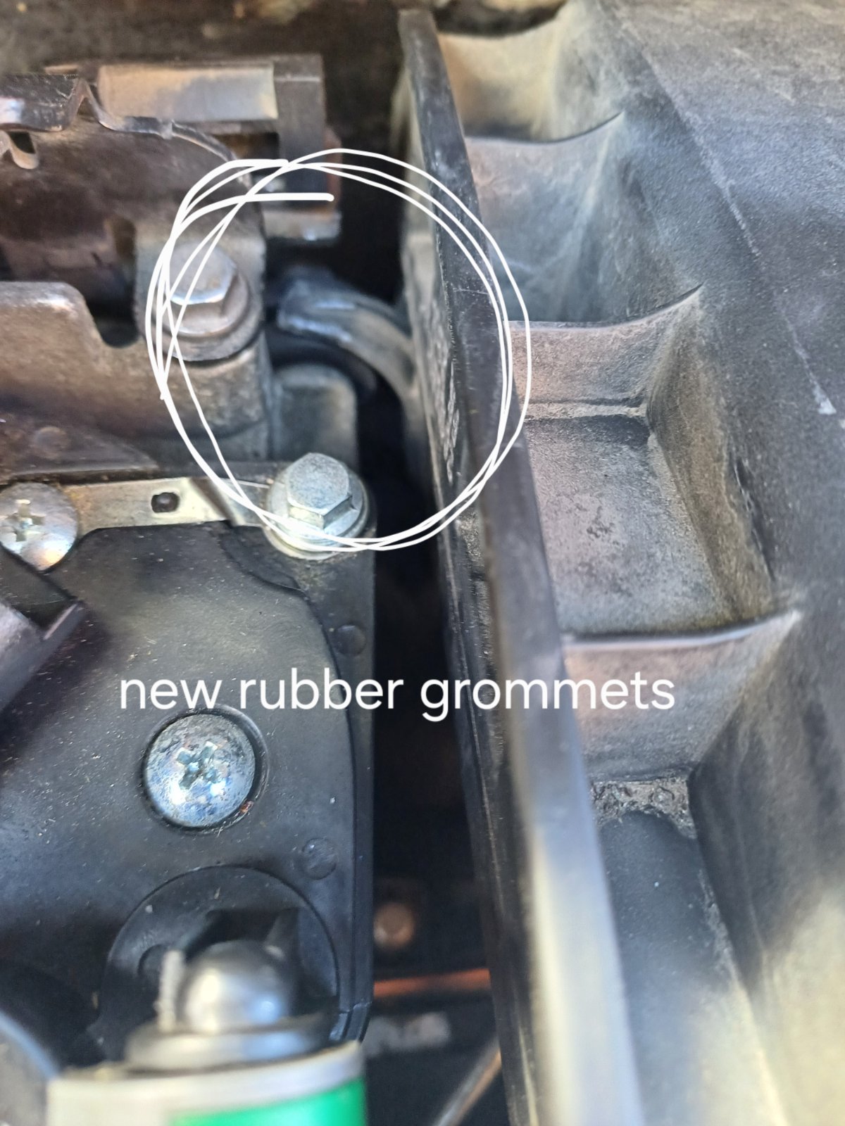

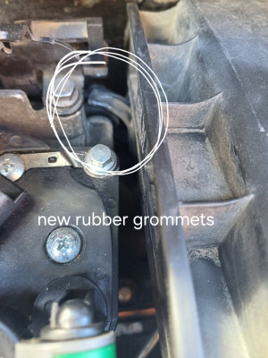

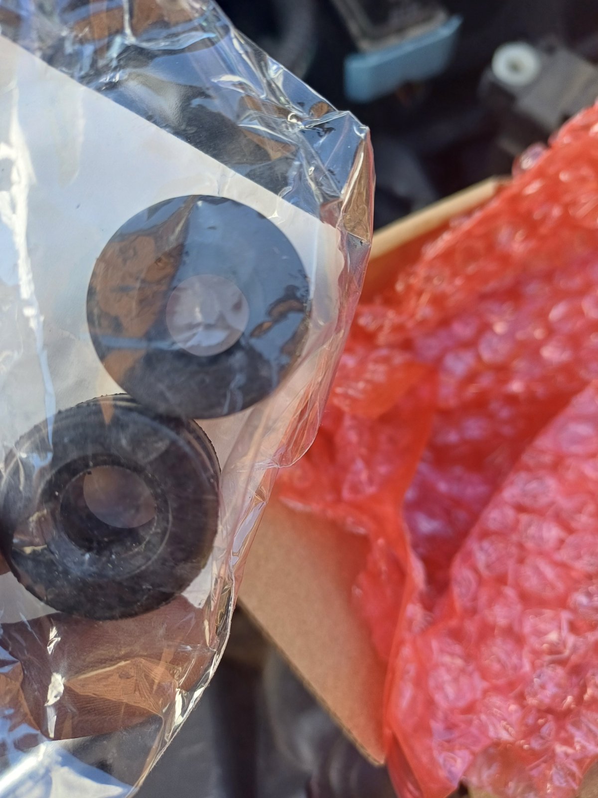

Also fitted 2 new rubber grommets to the air box and glued them with gorilla glue then when it dried box back where it belongs and no more wobble bouncy box !

Always amazes me how much pressure them little rings deal with

Inspection of the cars original 02 sensor shows one pin suffering corrosion the plan is now check the plug again to the car then clean if needed, I'm out in the car now 34 mile run no issues ar all , didn't smell fresh diesel either .. update later.
The original 02 sensor with green stuff...
