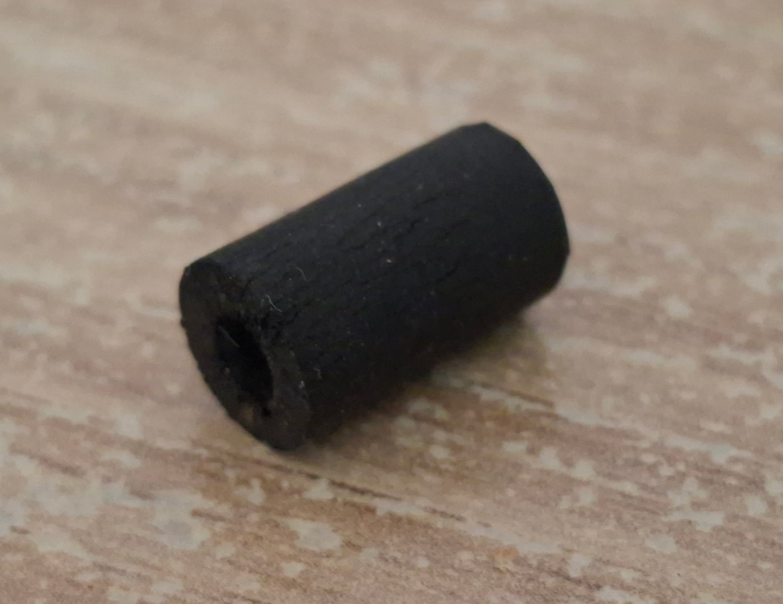

Bluebell had a bit of a stroppy day yesterday...
All of a sudden she cut out at a junction, ran roughly on restart and lacked a bit of oomph... Then it all seemed to clear. Then it kept reappearing at random intervals before becoming fully established until I was forced to keep the choke pulled out a little to keep her running.
It felt like an air leak... And it was... The little blanking cap I filled ages ago to bypass the split diaphragm in the choke pulloff actuator had perished...
Replaced it and all came good :)
This was the last of my stock of old XUD Diesel Injector leakoff blanking plugs... They always had a bad reputation for quickly perishing.

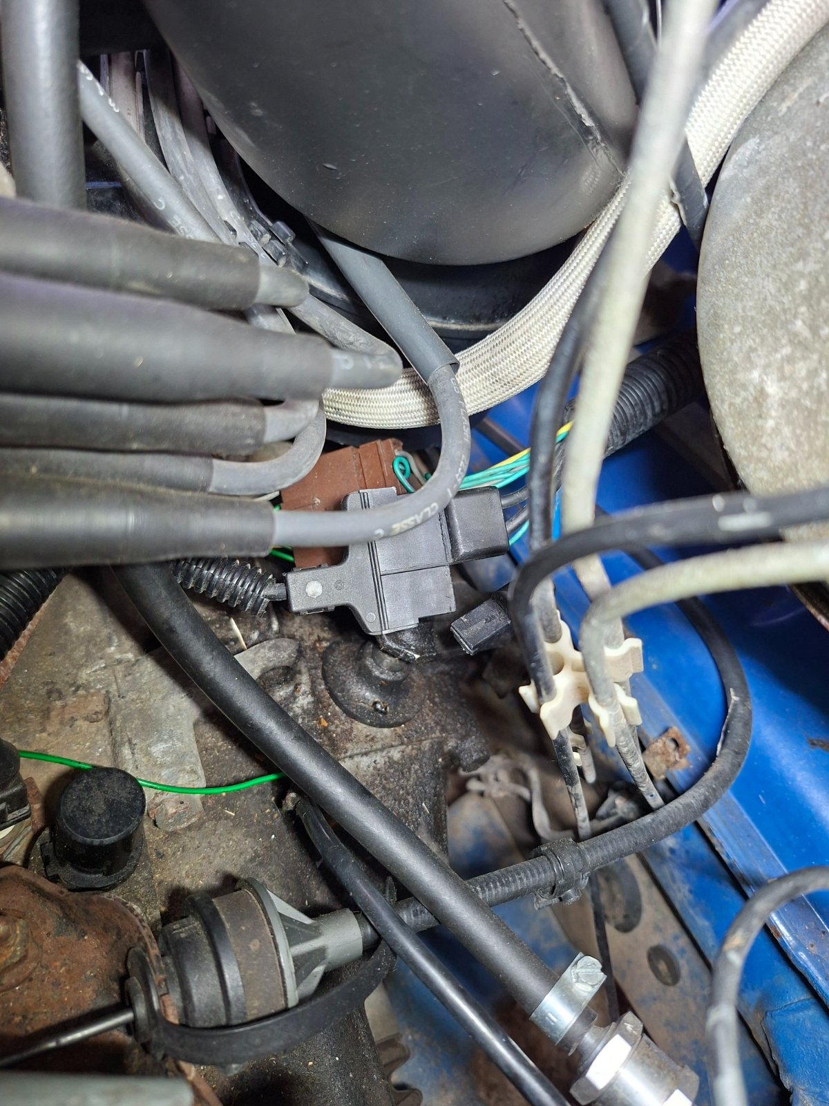

Then on my way home from a great lunch with Mick, the ignition warning light came on. It stayed on for a worryingly long time before going out for a while, coming back on and then going off for the rest of my journey home and was good for a second errand later in the afternoon.
I don't believe it's the (repaired) alternator failing as at the same time as the light came on, the fuel gauge fell to almost zero. It looks like an intermittent high resistance to the dash/instruments. I have a good idea where the problem lies and will be looking late this morning...

I had a look at Bluebell's electrics yesterday and checked and cleaned this large connector block that distributes battery to the ignition switch, instruments and dashboard controls...

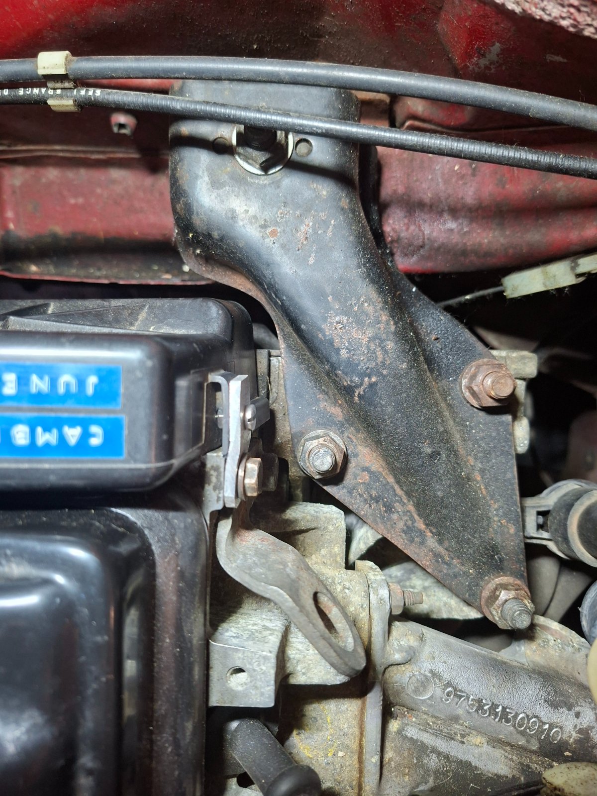

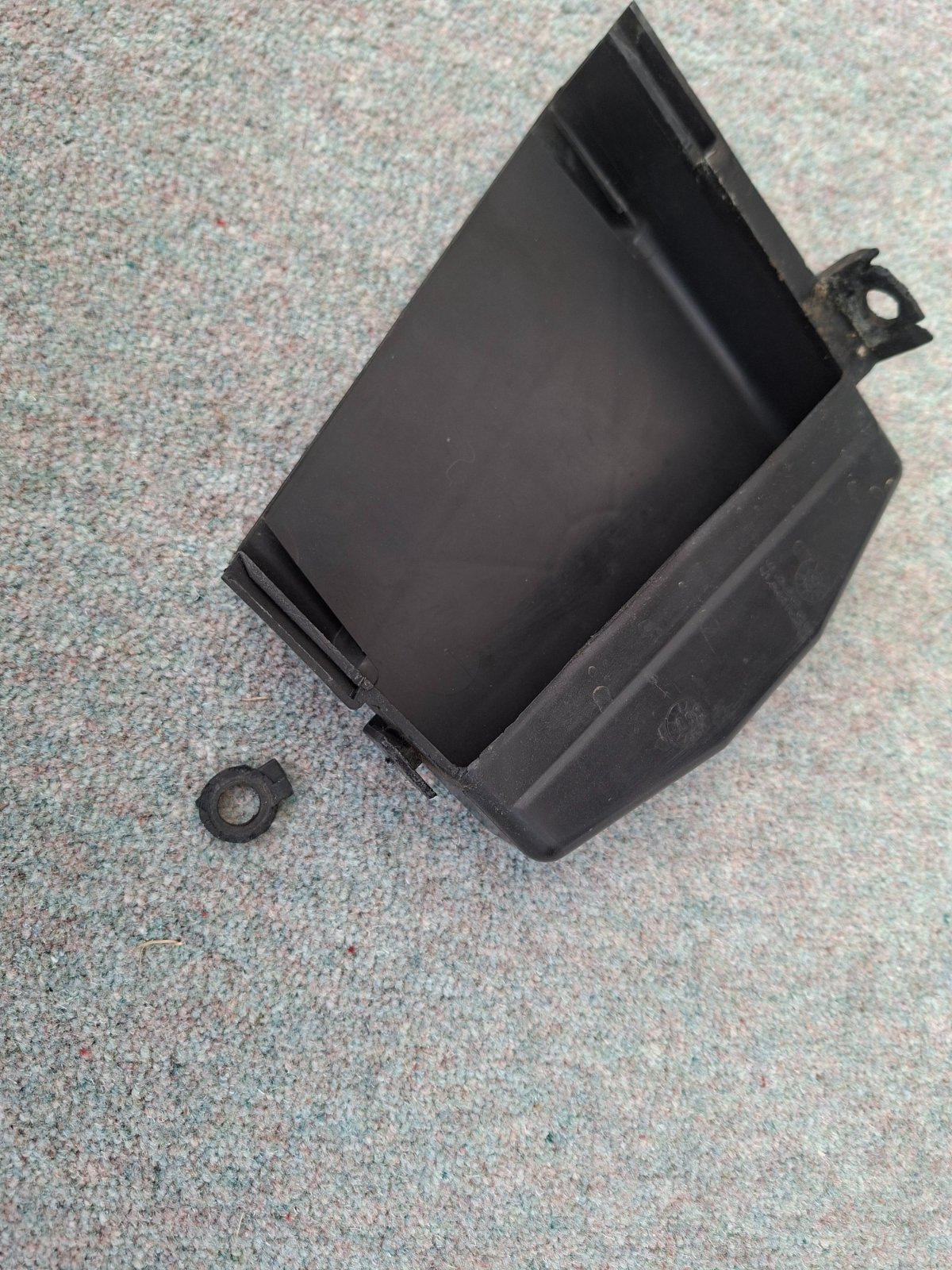

Whilst my bathroom and downstairs loo are under refurbishment, yesterday was an ideal time to get started on Strawberry work :)

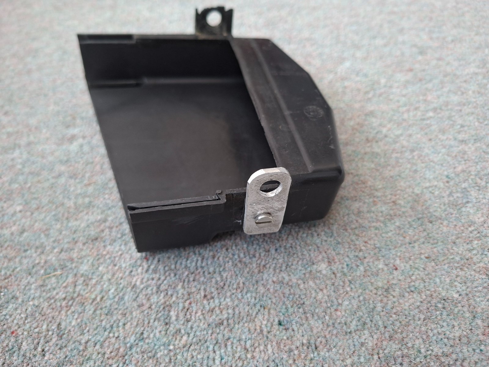

I commenced by removing the cambelt top cover. In doing so I found a broken mounting lug :(
I made a new one from a bit of scrap aluminium. A bit over-engineered but one uses what one has in stock ;)
Test fitment:
That'll be good. And there yesterday's work ended. Ran out of energy and was feeling very dizzy wen lying under the car :evil:

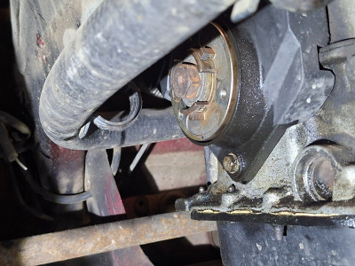

Another AX, another crank oil leak :twisted:
I have a seal in stock and a stock replacement item on order... I've done this job so often now...

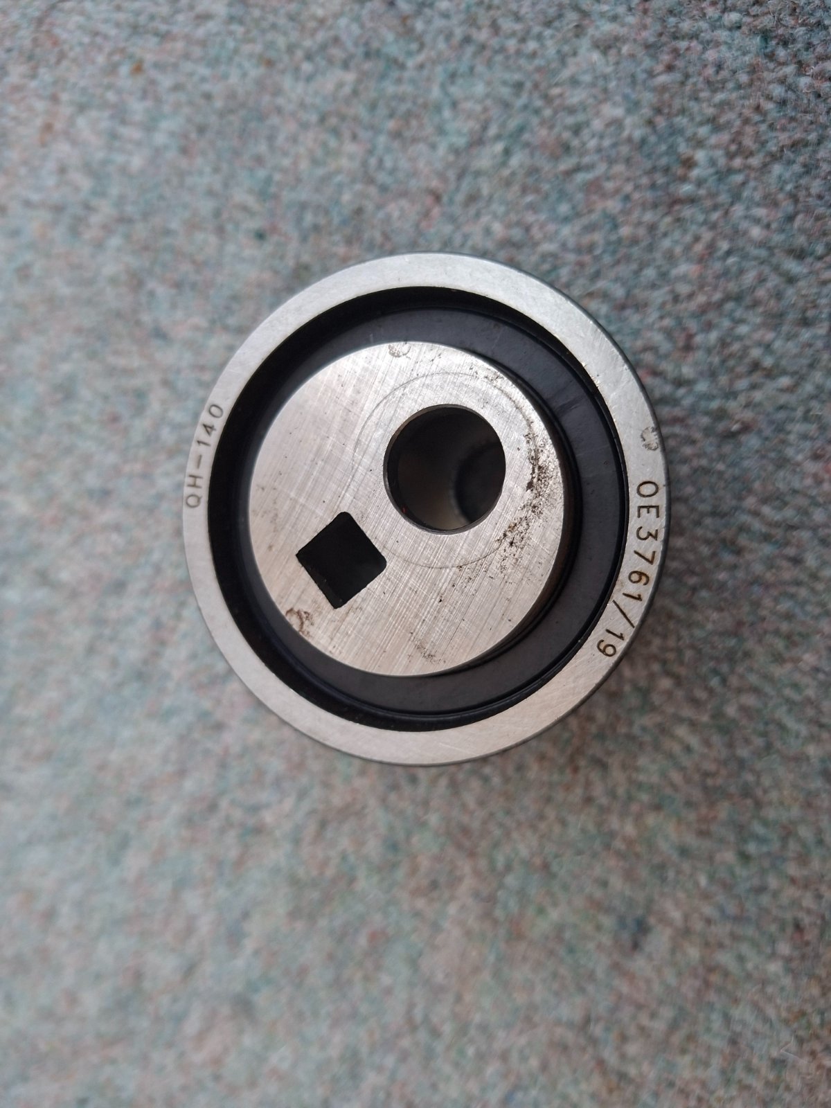

And I find the cambelt tensioner sings like a canary...
No surprise, I've been hearing it for a few months...
