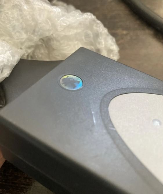

Re: PSA interface
Hello everyone.
The original device has a hologram of a lion.
