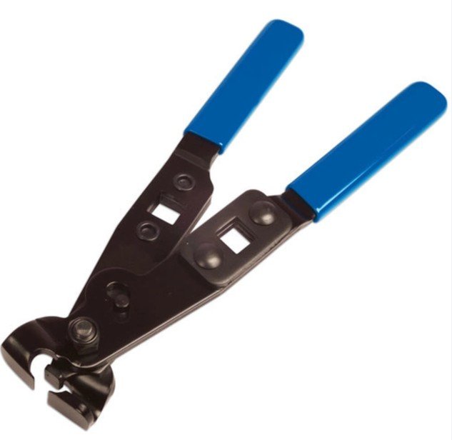

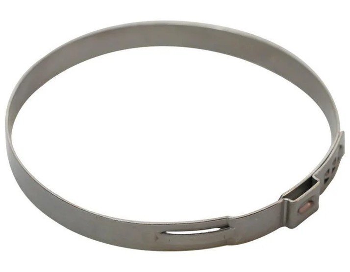

If it's this type of clip then not only should they be squeezed from either side, they should also be dimpled in on the top of the squeezed bit with a special tool.
CV clip
CV clip
CV clip tool
CV clip tool

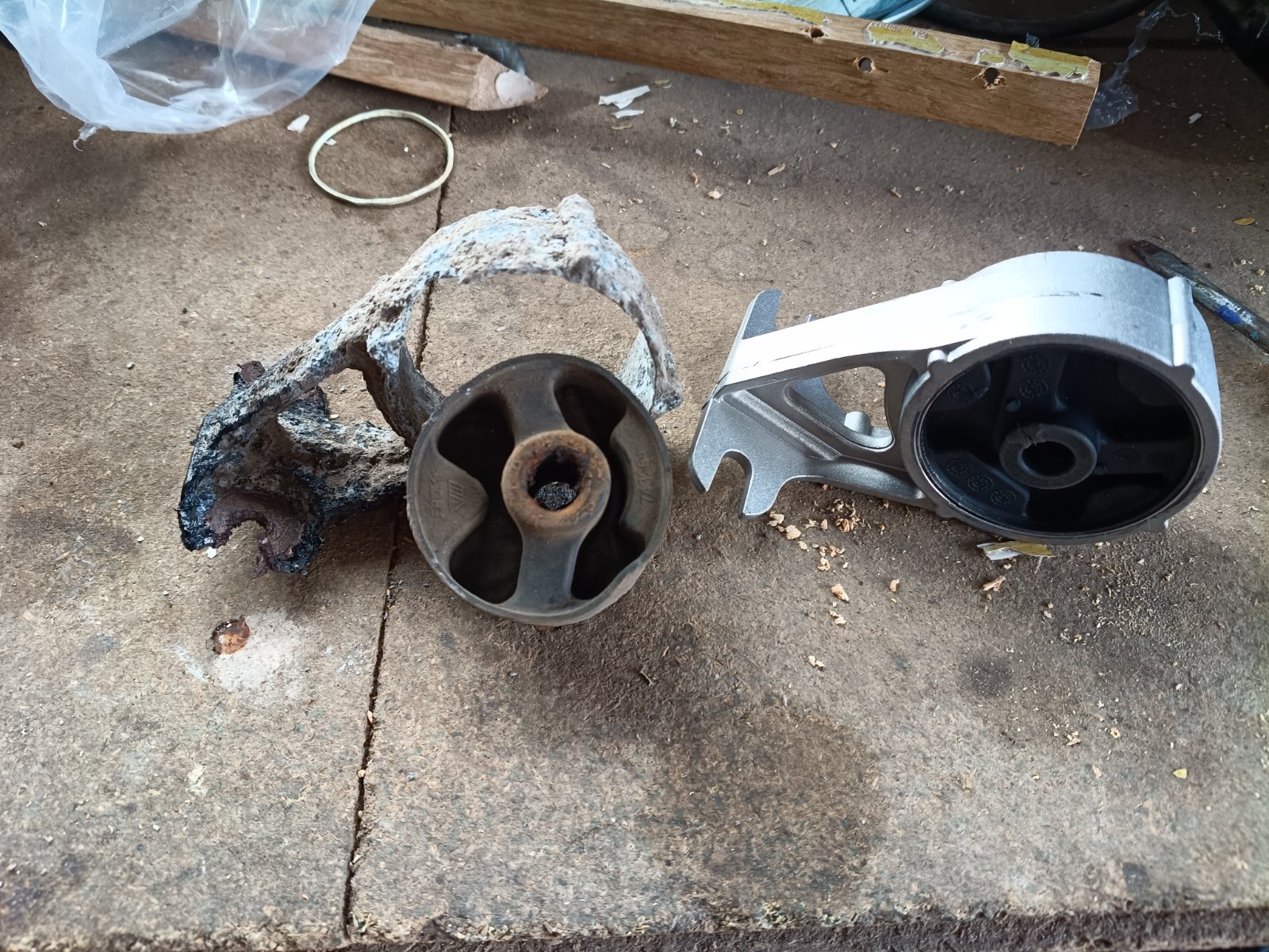

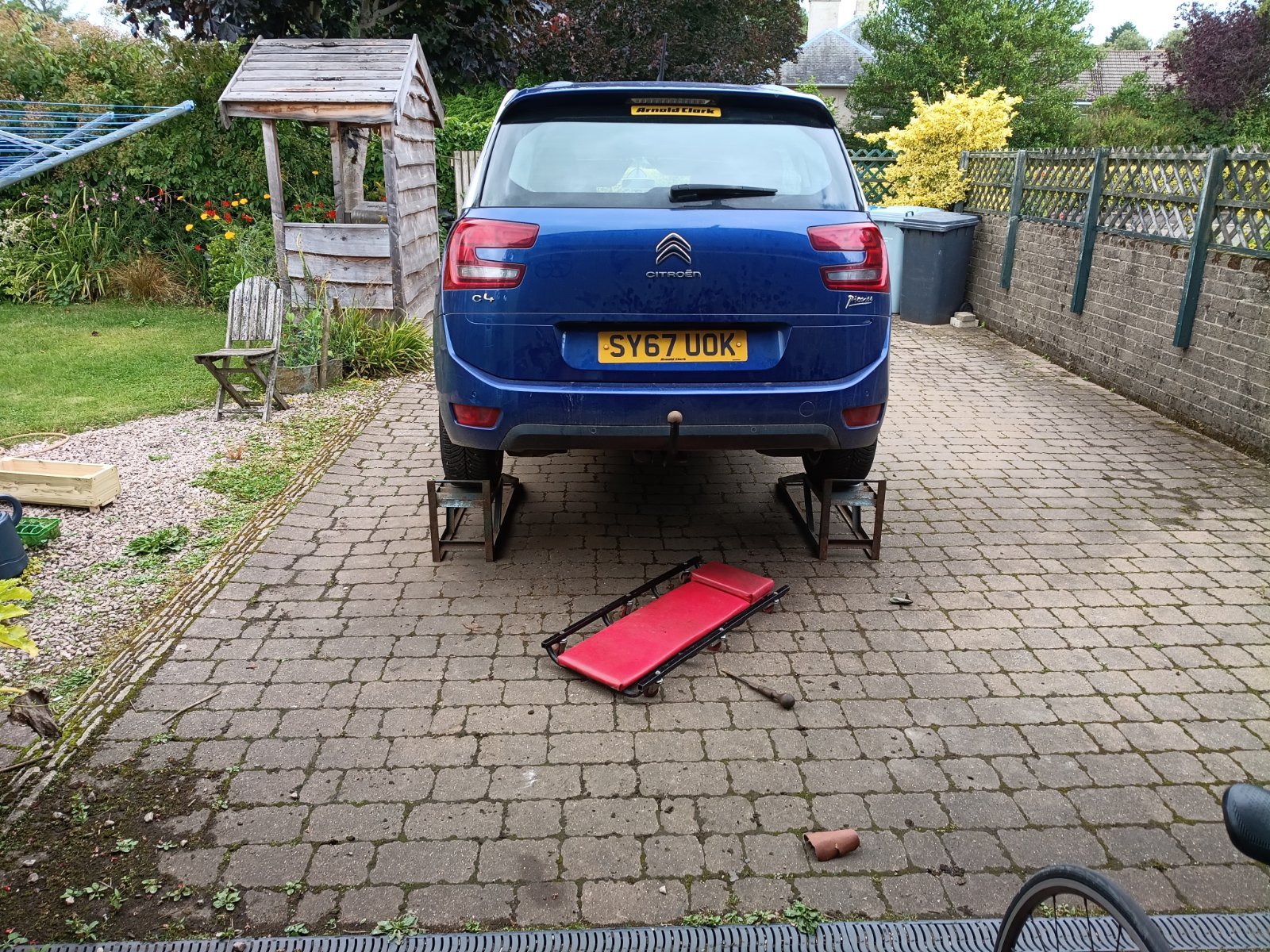

And again :lol:
A bit of rust proofing under the rear - which also showed that the rear exhaust mount is hanging on by a wing and a prayer - it's an ally mount and the salt has dissolved it. Bolts came out no problem however so replacement should be easy, and eBay turned up a replacement for £10!

I never got the hang of driving onto ramps, they always got pushed away and then I was unsure about driving off the end of them.

PaulC5 wrote: 02 Aug 2026, 13:32 I never got the hang of driving onto ramps, they always got pushed away and then I was unsure about driving off the end of them.
Same here Paul... They terrify me. If I must then I need a banksperson to assist me :roll:

The late Alan S used to advocate tieing a piece of old seatbelt to the slope and laying it along the floor, as the car is driven up the seatbelt stops the ramp slipping. I have no trouble with these - they are pretty heavy, and have a high rail at the back to stop you driving over, don't seem to have trouble with driving on them!

Spot the difference :rofl2:
Just a small amount of salt induced corrosion!
Exhaust feels much more secure with the new one in.
