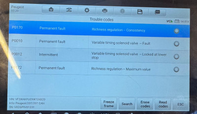

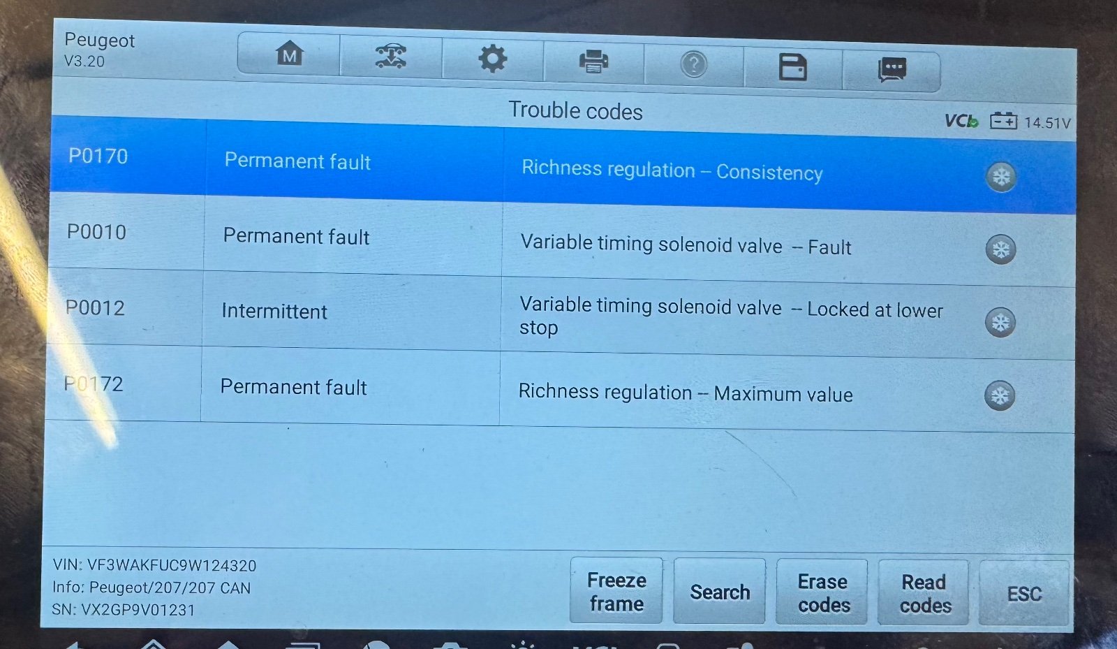

When I scanned the vehicle, the following error codes were recorded:
• P0170
• P0010
• P0012
• P0172
As soon as I start the engine, the only code that reappears after clearing them is P0010.

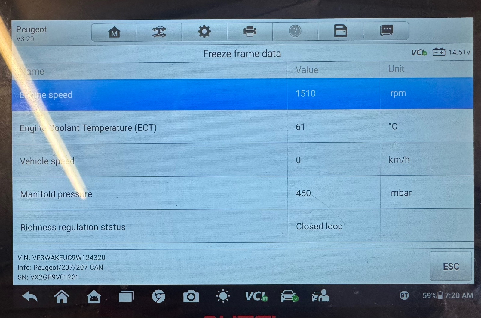

Hi,Does the throttle pedal work? Sometimes if there is no, or incorrect signal, it defaults to a high idle (but you have no codes, so probably not).
What does the freeze frame / live data say behind the codes? Often codes for multiple items are related to loss of reference voltage or earth.
I have now changed all the sensors and the throttle body, but it’s still the same. I have checked the throttle pedal and it all appears to be working as it should in live data. I have attached an image of the freeze frame data

Re: KFU Engine idling at 1600rpm
The coolant temperature there is low, it should be up in the 80-90s when the engine is warmed up. so that may be affecting the ECU idle control.
It’s still the same when it’s up to temp.
Then that suggests the temperature sensor is sending the wrong info to the ECU. Measure the temperature of the thermostat housing and check it is showing 86+. If so then the sensor would appear to be faulty causing the ECU to maintain high revs at tickover. Replace the sensor!!
I replaced it today and it made no difference

Can you give us a bit of a history of the car?
The fuel trims are maxed out so the engine is running lean. Can you look at the upstream oxy sensor (bank 1 sensor 1) graph? If there are no air leaks (you say you did a smoke test) then it might be a fueling problem.
Have you checked the fuel rail pressure? Checked the injectors? What did the old spark plugs look like?
