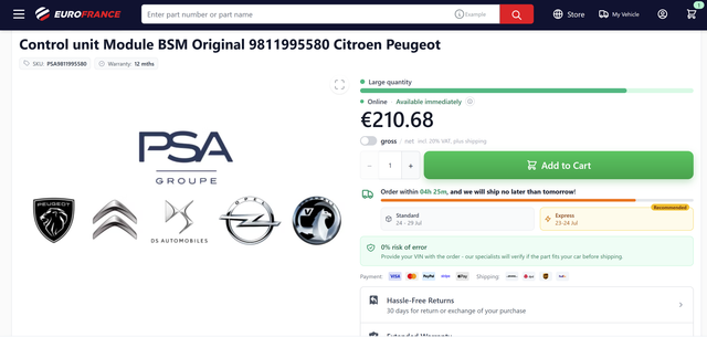

Re: No crank, no start.
Unread post by ASA »
A new BSM is quite affordable. And learning them being quite fault prone, a new one wouldn't hurt in the long run... Does BSM need coding when replacing?
