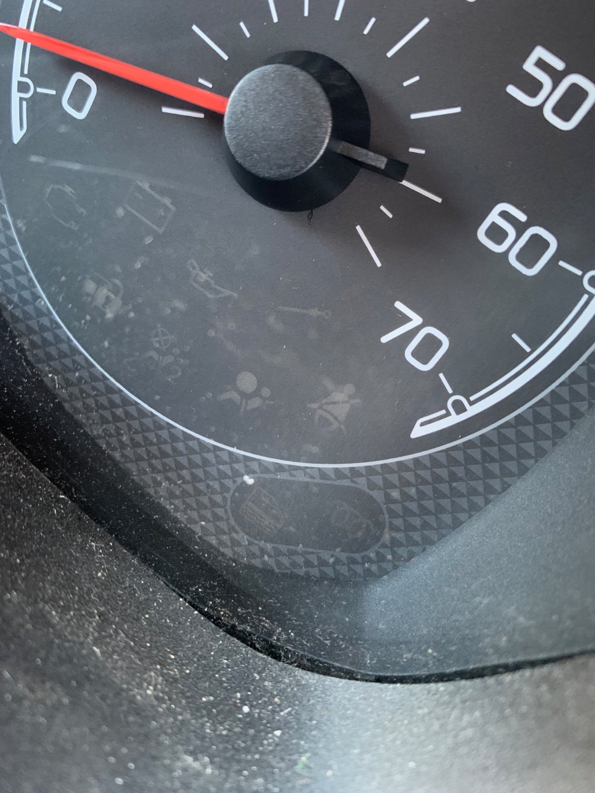

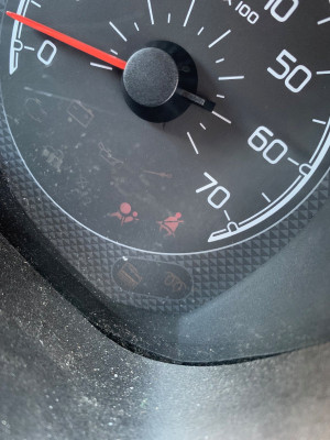

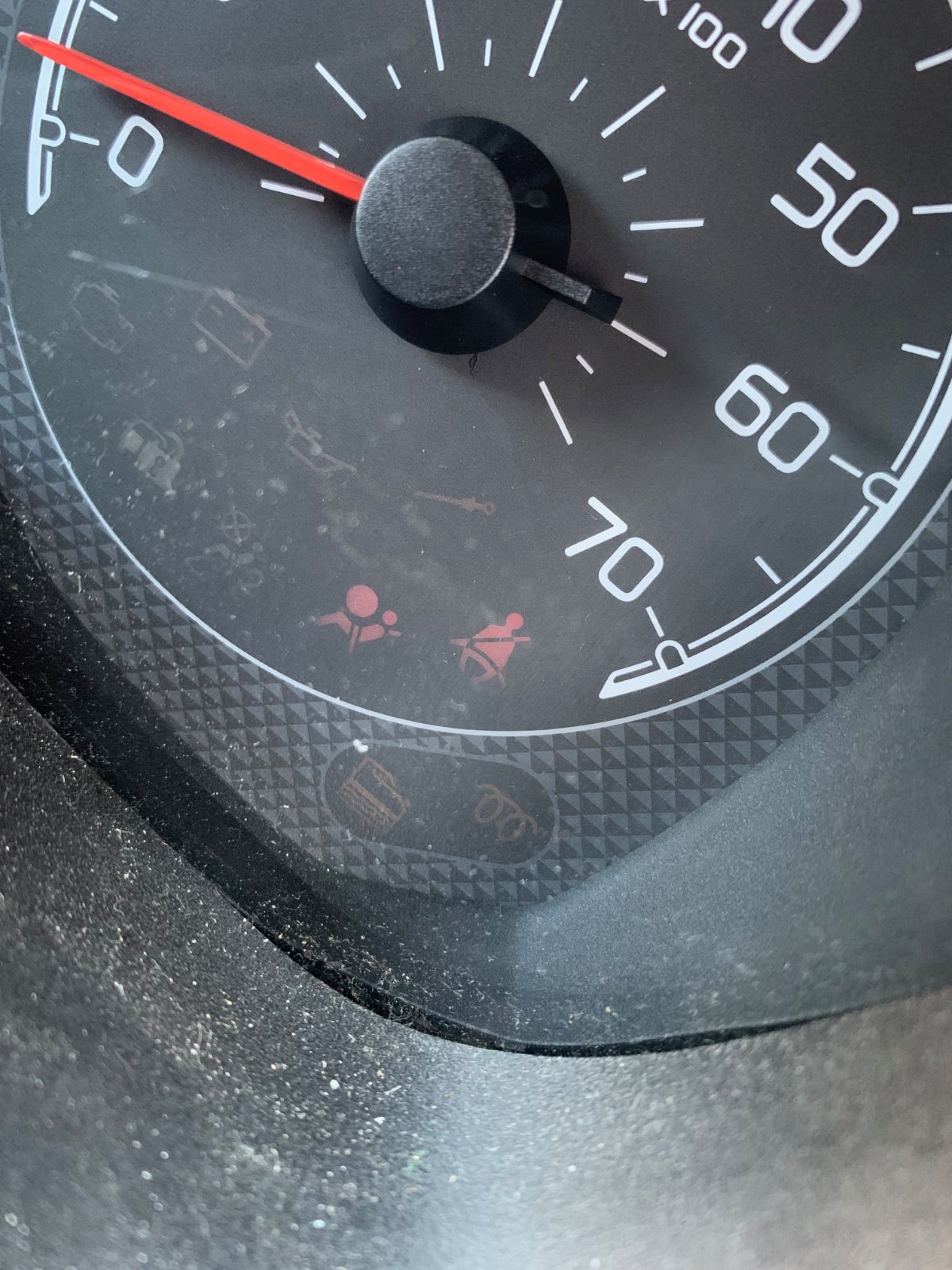

See the two pics, ignition off and faint light on a few on the instrument symbols, after 5 hrs battery is flat, not sure how to find the fault#
one pic battery lead on, the other removed

It would appear that you have something not turning off properly when you switch off. The first thing I'd do is a BSi reset following the procedure in the link below. If the fault is still present after that you will need to isolate which circuit is still active, possibly by removing fuses one by one until the fault clears. Most times this type of failure is due to dampness or corrosion in a connector somewhere so check all the fuseboxes for those issues and see what you find.

I will try BSI what i dont get is they are so separate in their functions, ones airbag , saatbelt clip, fuel empty light doesn’t make sense

I cannot see the fuel low level light in the pictures unless i am not seeing the obvious which is something i am well known for.
Is the AirBag light for the passenger side? Both of the seatbelt/airbag lights are close together so could be light bleed if very faint but could be on a similar circuit for the ECU ?
