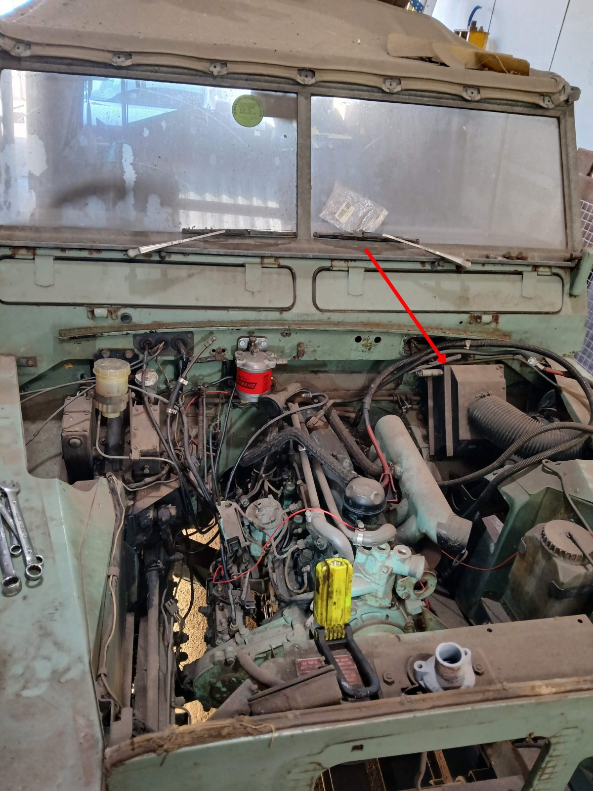

I've probably got to do the heater matrix on my Land Rover at some point. On the plus side - it's very easy to get at. That's it arrowed on the right hand side in the engine bay.......
Land Rover heater matrix - own work
On the minus side - it's all rather pointless as it was only ever rumoured to put out slightly warm air in the winter months :lol:

The Landy looks super awkward, you've got to lean over stuff :wink:
