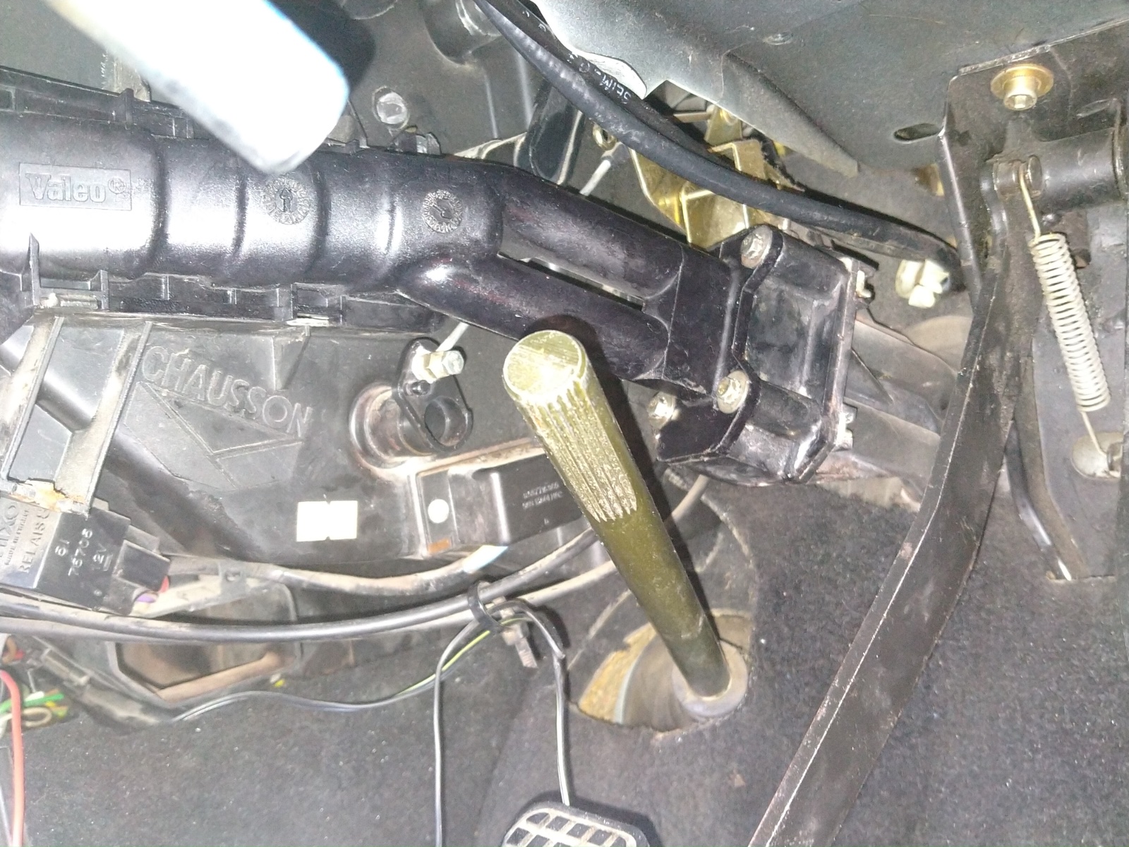

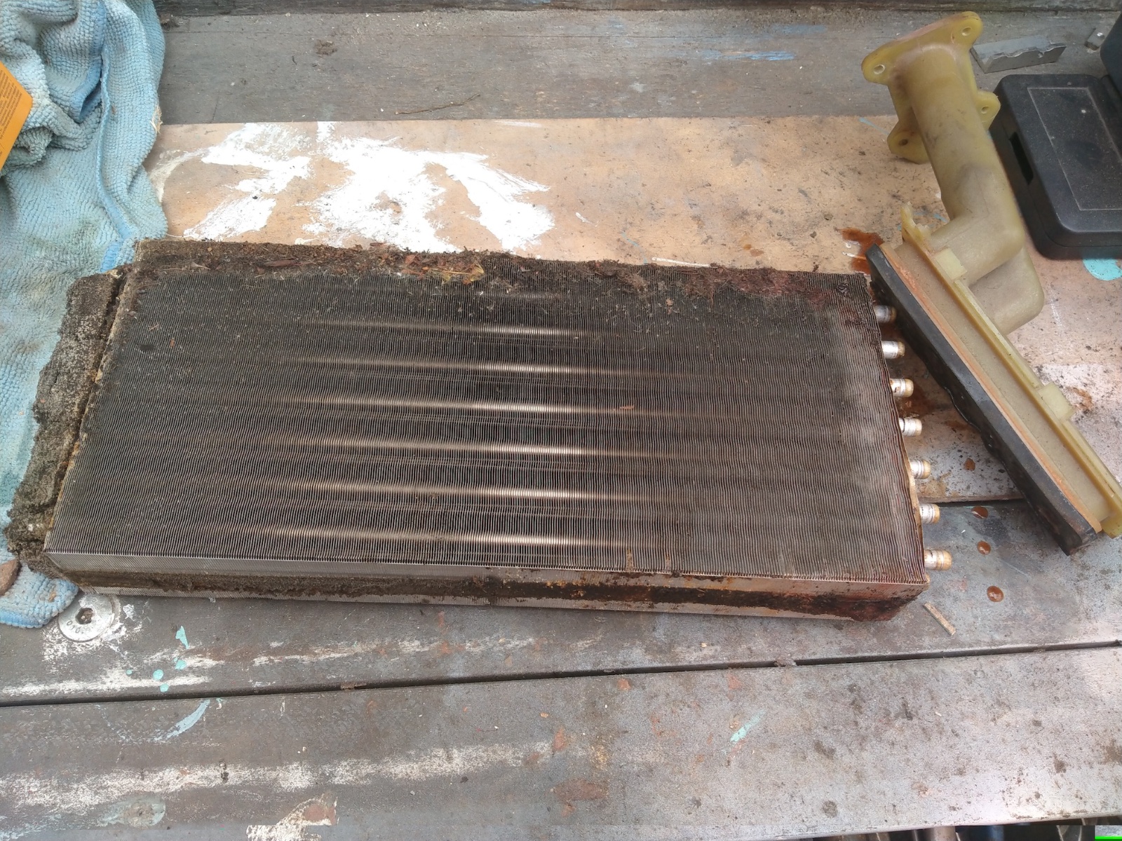

I didn't really fancy laying on my back in the front footwell of my BX during some of the hottest days of the year but a dribble of Evans waterless coolant coming out of the centre console heater vent suggested a leaky heater matrix. I managed to find a Valeo matrix on eBay and ordered seals from Chevronics so no excuses to delay any longer. The lower dash trim needed to be removed, three self tappers and a bolt, to gain access to what lay beneath and subsequently I found the steering column joint needed to be removed the get the matrix out along with a bit of metalwork bending out of the way. There are four long very thin bolts holding the matrix to the heater valve three of which are pretty easy to reach (it it wasn't for the fact I'm bigger than the foot well so twisted at an awkward angle) but the fourth is an absolute pig. Once I'd found and removed a couple of self tappers holding the matrix in the housing I gave it a tug, and another, then...........
I guess I found the reason for the leak

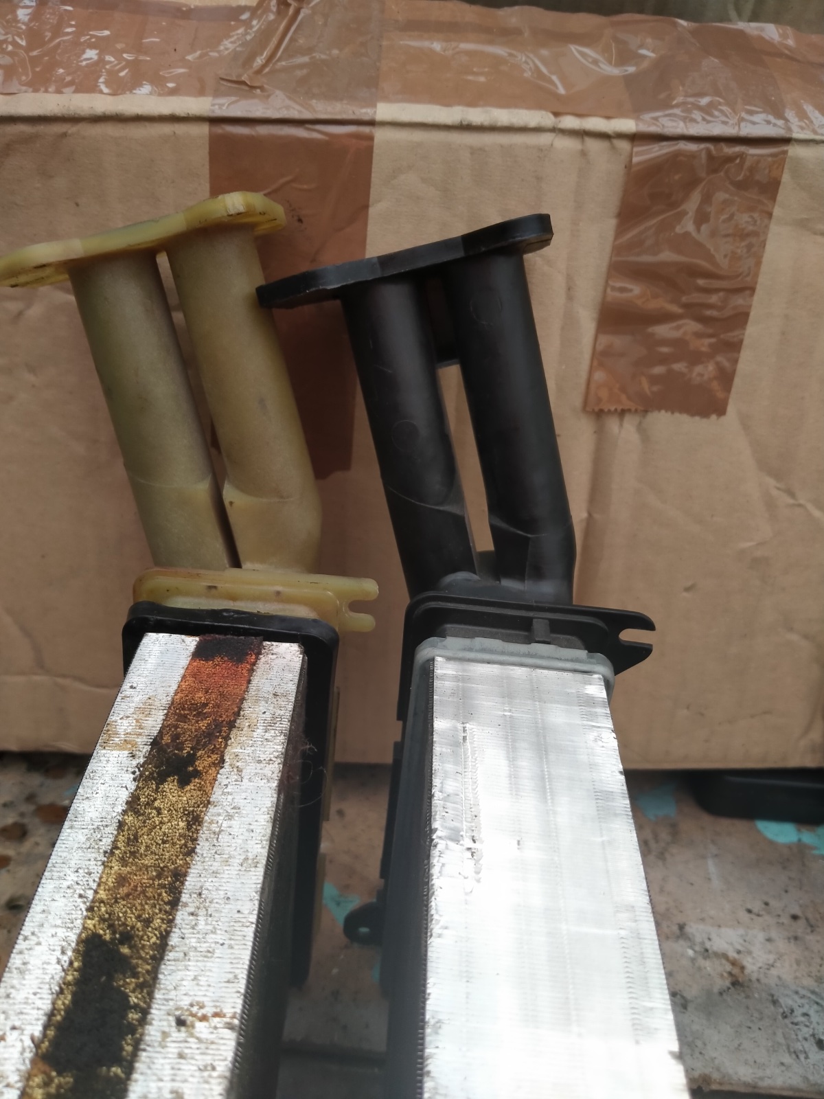

I offered new to old and all looked OK
But when it was time to fit the new I ran into a problem, the matrix pipes just wouldn't line up with the heater valve (1/2" difference in height) and nothing fitted to the car had moved it was all solidly mounted. So a but of brute force and ignorance followed and the two faces where prised over each other with a greased scraper blade and the matrix was eventually pushed home and bolted up, yay. Time to test it so refilled with coolant and checked the joint - it was pi$$ing out, I must have dislodged the two 'O' ring type seals when forcing the two faces together :?
