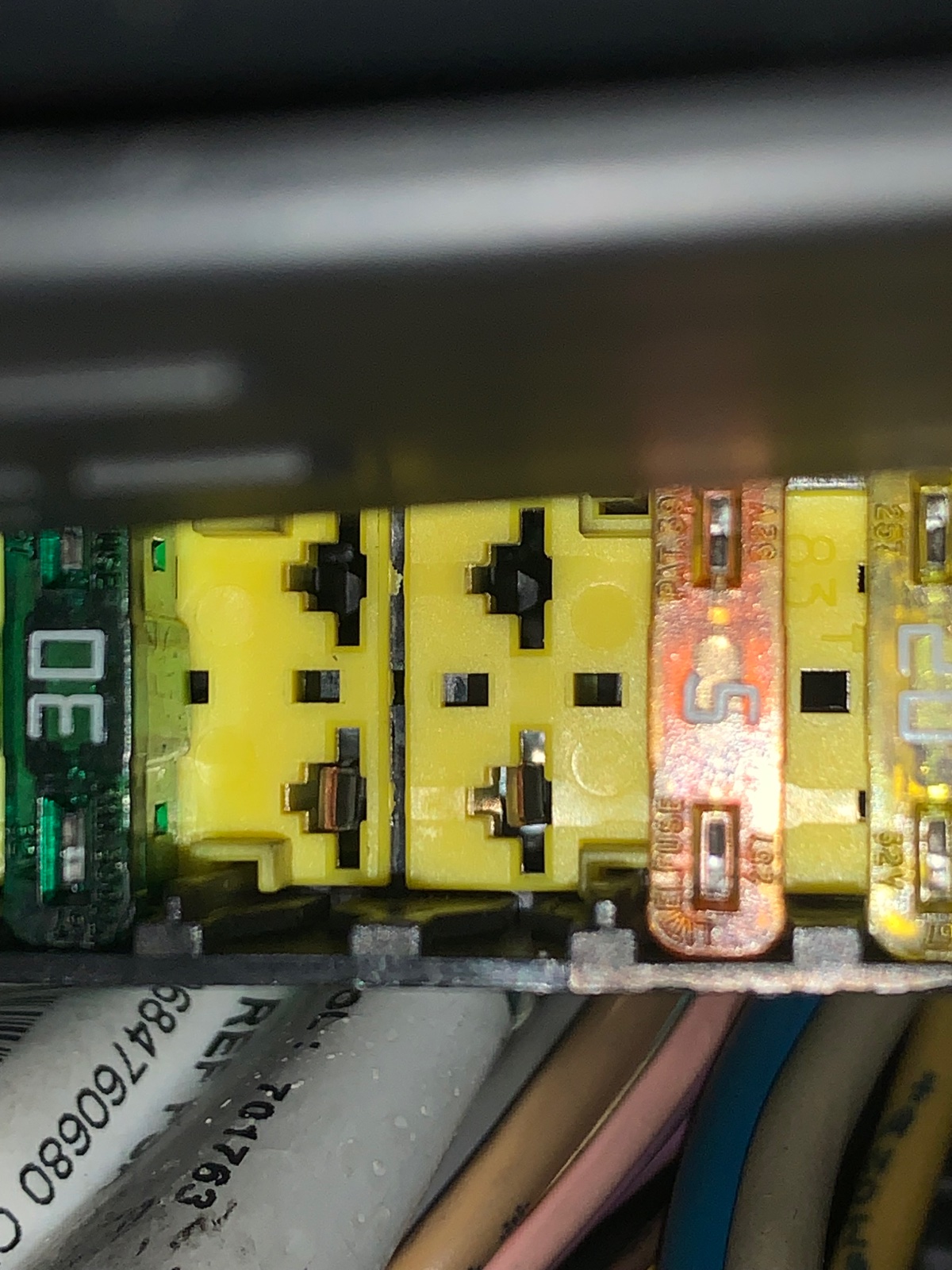

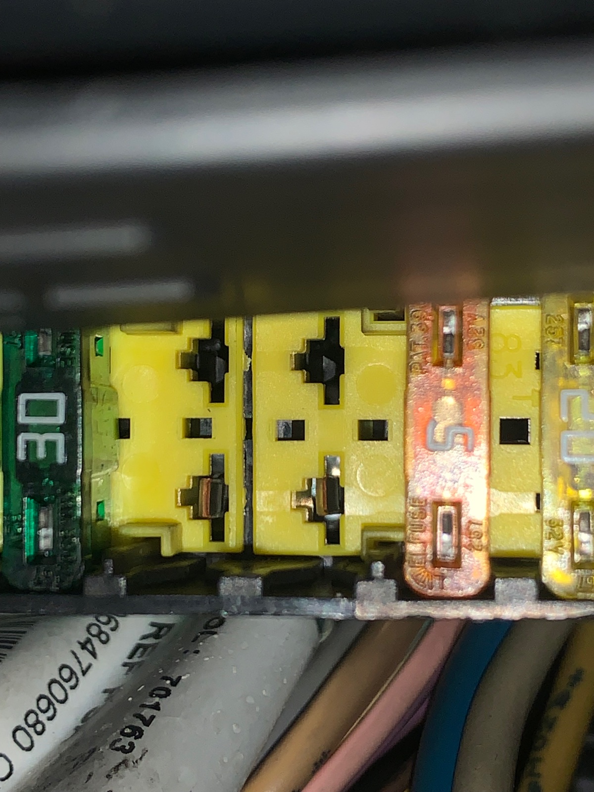

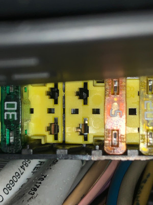

MikiHN
- Posts: 5
- Joined: 26 Nov 2025, 18:29
Re: Citroen C5 2010 seat replacement, wiring diagram needed
Need help about this..
. I activated the function for the electric seats through diagnostics, brought one cable that was missing in the compartment near the driver's seat (cable from BSI to the seat). But the seats still do not work. Later I saw that I did not have a fuse for the seats. But in the place where the fuse should be there is only one foot for the fuse (+) and there is no other one at all. So the fuse cannot be inserted. Does anybody know where other cable go? Because without other,I can’t install fuse..
wurlycorner
- Posts: 2177
- Joined: 30 Oct 2012, 22:37
- x 272
I would assume that this wire was left out of the loom on your car, because it wasn't originally fitted with the seats.MikiHN wrote: 10 Feb 2026, 11:41 Need help about this... I activated the function for the electric seats through diagnostics, brought one cable that was missing in the compartment near the driver's seat (cable from BSI to the seat). But the seats still do not work. Later I saw that I did not have a fuse for the seats. But in the place where the fuse should be there is only one foot for the fuse (+) and there is no other one at all. So the fuse cannot be inserted. Does anybody know where other cable go? Because without other,I can’t install fuse..
If the terminal that you do have in the fuse holder is +12v (check with a multimeter) then you are missing the side that runs from the fuse to the seats and will need to make that up/install it yourself.
If the terminal that you do have in the fuse holder is not +12 (check with a multimeter) then you are missing the side that runs from the batter to the fuse holder and will need to make that up/install it yourself.
Iain
CX DTR T2 Safari (silver)
Iain
MikiHN
- Posts: 5
This one has 12v, I already checked it with a multimeter.
