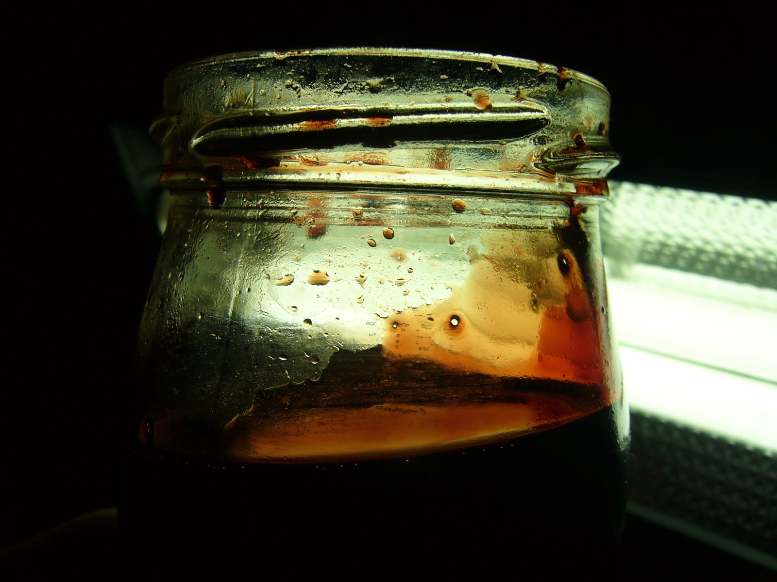

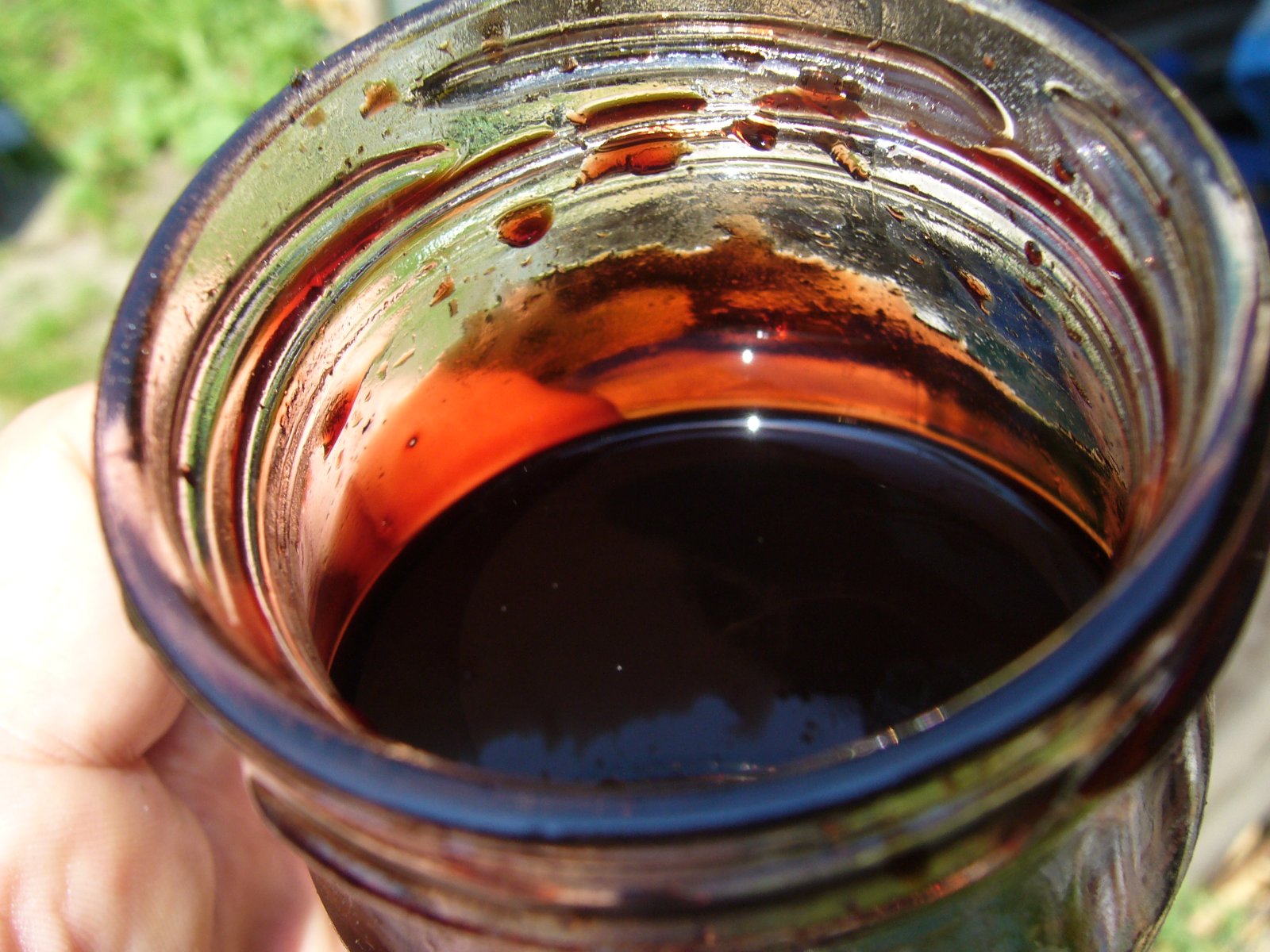

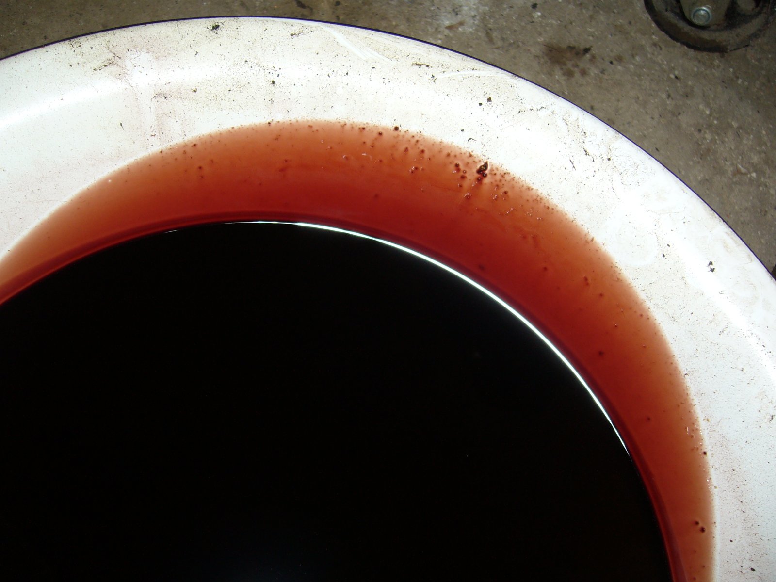

I have a question, has anyone encountered this before?
TU5JP (NFU) engine, I change the oil regularly every 10,000 km including the filter. I use Total Quartz 9000 5W-40.
It has happened to me several times that the drained oil is not the classic black, but has a distinct reddish-brown to reddish colour (see photo). When I drained the oil and a little of it got on my hand, it almost looked like I had blood on my hands.
I wondered if someone before me had used some kind of oil additive (some are red) and since a small amount of old oil always remains in the sump, it could also colour the new one. But I'm not sure.
What surprised me the most - after the change, I poured new oil, started the engine only for a moment to check the level and after this short run, the new oil on the dipstick was clearly reddish.
On other cars I've serviced, new oil usually stays light amber for a long time after starting, so I'm surprised.
Has anyone else experienced this with a TU5JP/NFU engine? Is this colour normal, or could it indicate an additive, oil reaction, or other problem?
Thanks for all the experiences.

You certainly have some sort of contamination there. It could be as you suggest the result of an additive, it could also be an unwanted mixing of coolant and oil if you have an oil cooler for example which has a leak. Another red fluid around is power steering fluid but I can't really see how that might mix. I would suggest you try a full engine flush with proprietary flushing oil on your next oilchange and see if that clears it up.

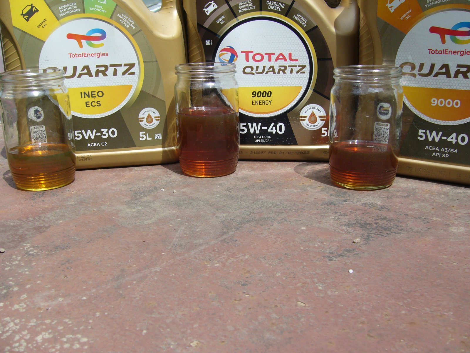

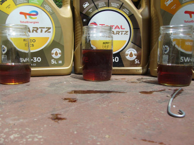

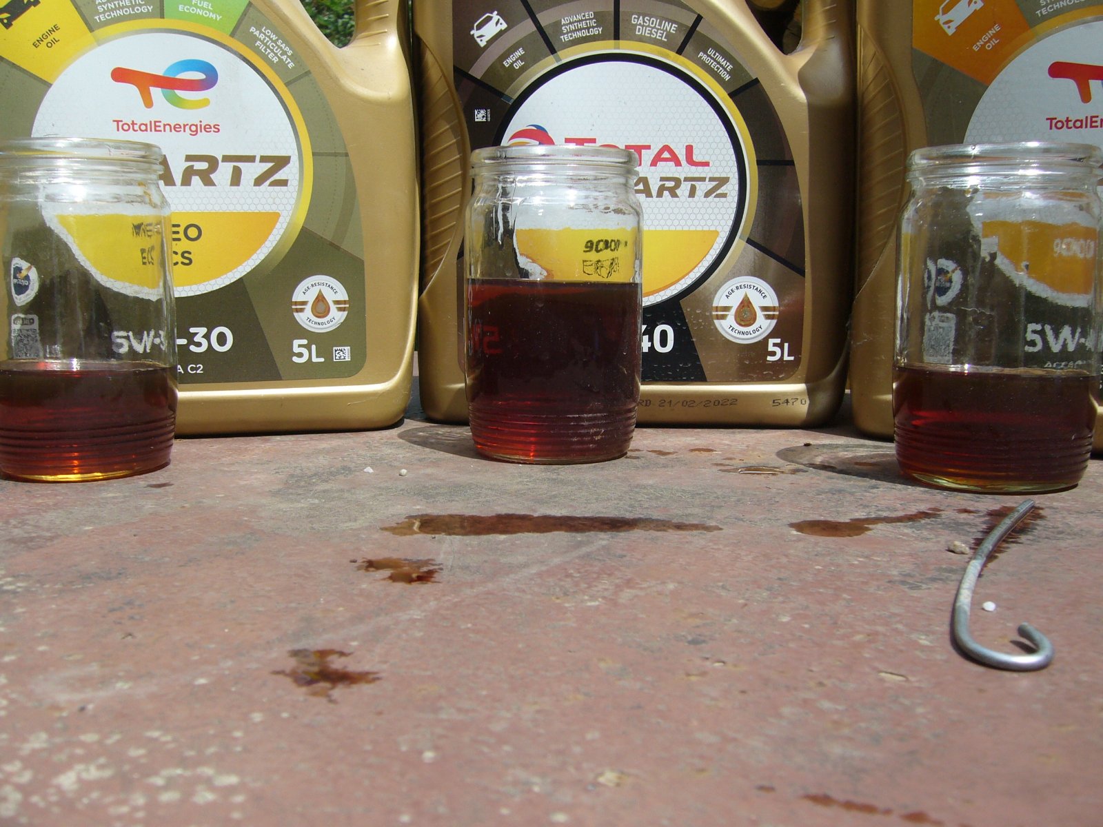

I did another small experiment that I thought might be interesting.
The first photo shows three fresh oils straight from their original containers:
Total Quartz INEO ECS 5W-30
Total Quartz 9000 Energy 5W-40
As expected, all three have the normal light amber color.
In the second photo, I added exactly 20 drops of the used oil from my TU5JP (NFU) engine to each fresh oil sample. Even with such a small amount, all three fresh oils turned a very similar reddish-brown color.
This seems to indicate that the fresh oil itself is not responsible for the color. Instead, the used oil contains something with a very strong coloring effect that immediately changes the color of any fresh oil it mixes with.
The question is what exactly causes this. Is it simply a normal chemical change in the oil's additive package (antioxidants, detergents/dispersants), dissolved engine varnish, oxidation products, or something else?
I have contacted an oil analysis specialist recommended by TotalEnergies and sent him all the details along with these photos. As soon as I receive his professional opinion, I'll post it here.

That's incredible. The fact that just 20 drops of used oil can change the color of fresh oil so dramatically suggests the coloring compounds are extremely potent.
My guess would be that it's a combination of oxidation by-products, dissolved varnish, and contaminants that remain suspended thanks to the detergent/dispersant additives. Color alone isn't a reliable indicator of oil condition, so it's not surprising that a small amount of used oil can dominate the appearance of a much larger volume of fresh oil.
I'm particularly interested to hear what the oil analysis specialist says

As illustrated when doing a diesel oil change with filter. Despite the new filter and doing one's best to get as much old oil out as possible, the new oil is very soon black again!Kelly001 wrote: 04 Jul 2026, 10:41 That's incredible. The fact that just 20 drops of used oil can change the color of fresh oil so dramatically suggests the coloring compounds are extremely potent.
From the photo, that almost looks like used Dexron ATF... Compare with what you might see in a power steering reservoir...soundlovers wrote: 01 Jul 2026, 14:43 It has happened to me several times that the drained oil is not the classic black, but has a distinct reddish-brown to reddish colour (see photo). When I drained the oil and a little of it got on my hand, it almost looked like I had blood on my hands.
