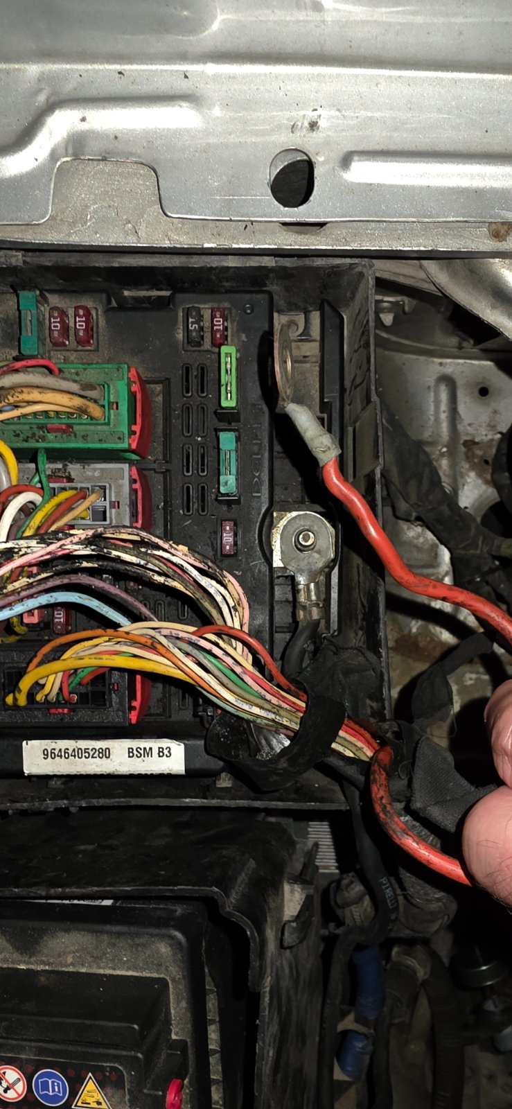

I think i found suspect for drain.
I've spent whole day, disconnecting relays and fuses, searching for drain cause.
After whole day, just before dark, i found out that my mehanic connected BLACK wire from + on battery onto bsm module, and RED wire which comes from main power cables from engine bay onto bsm's black connector.
After i unscrewed that 8mm nut and pulled out red cable, my + lead on battery dont make sparks anymore when i reconnect it. So, 99% that there is battery drain cause, but now queston is, where the hell goes that red wire??? Does anyone here has similar car (2004 xsara) with same bsm type, to take a picture so i can see where those cables must go? Only pictures on web are those of bsm's for sale, with wires being cutted or disconnected. My concern is only that red one with round plain washer ending, where the hell it goes, if not on that 8mm threaded rod where is black one + from battery connected?
It's dark now, and i have no conditions for further investigation, and i need picture of properly connected bsm so i can continue tommorrow morning.
Tnx.

Does anyone has access to electric scheme of this exact combo so i can have info where the hell this red wire goes?
It's supposed to be + and to be attached together with that live + black below on picture which goes directly from battery, but in my case, back in few days, that red wire is - out of sudden (wth).
So i need wiring diagram of combo with that red wire (all i found on internet is without it) so i can found where the other end of it is attached so i can found cause of my problems.
Tnx.

If you look the bundle of wires you'll see that they all have identification codes printed on them. Does this thick red wire have a code printed on it? If it doesn't then it's more than likely to be something a previous owner has fitted. Colour of wires is absolutely no clue as to its function.

Paul-R wrote: 01 Jul 2026, 19:20 If you look the bundle of wires you'll see that they all have identification codes printed on them. Does this thick red wire have a code printed on it? If it doesn't then it's more than likely to be something a previous owner has fitted. Colour of wires is absolutely no clue as to its function.
It has but is blured. I would say BB3 but i'll scrap tomorrow more insulation arround it to try to find non blured code. It goes in same bundle with bb5a red thick wire.
I've just found some wirind diagram on internet, and they both are supposed to be + on preheat control unit, bb3 on it from battery, bb5 (mine is bb5a...), goes from preheat control unit onto 3 relays at the radiator, for powering radiator vent.
