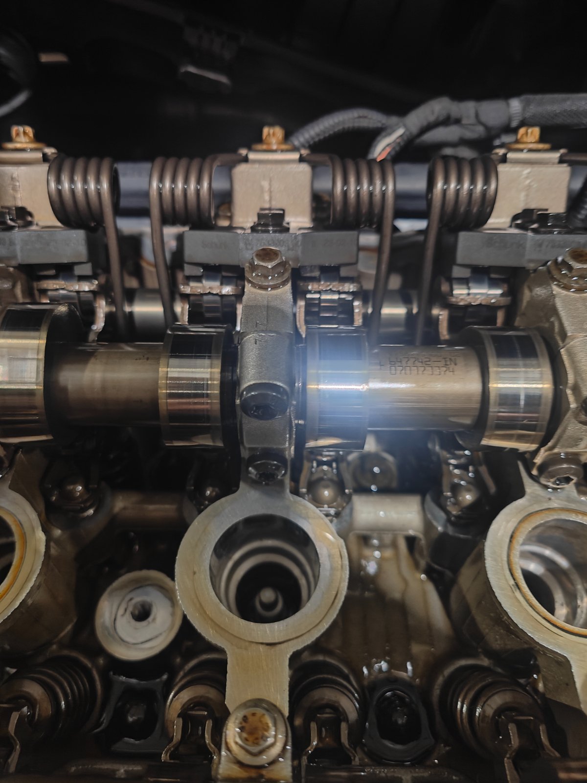

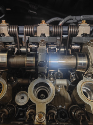

Hi there I'm wondering if anyone can help me by sending the camshaft tappets removal procedure on the 5fw engine. I have attached a picture.
I need to replace the hydraulic lifters. Remove those springs etc.

Thanks for the link but that is a different engine without the springs

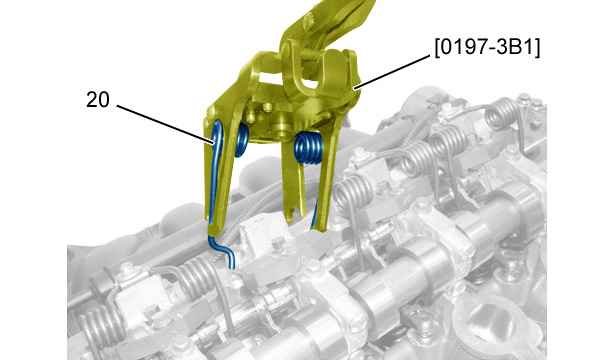

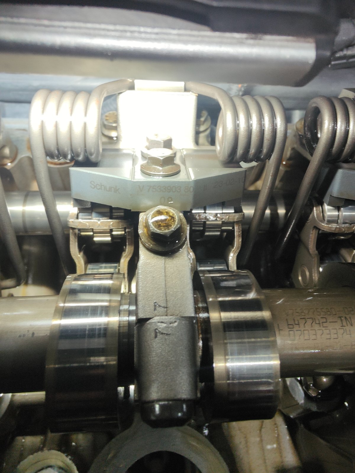

Removing and (especially) refitting the variable valve lift springs requires a rather special tool:

Here is a guide to using the tool:
Here is a link to the official instructions (in Russian): https://citroens-club.ru/applications/c ... p?id=92169
