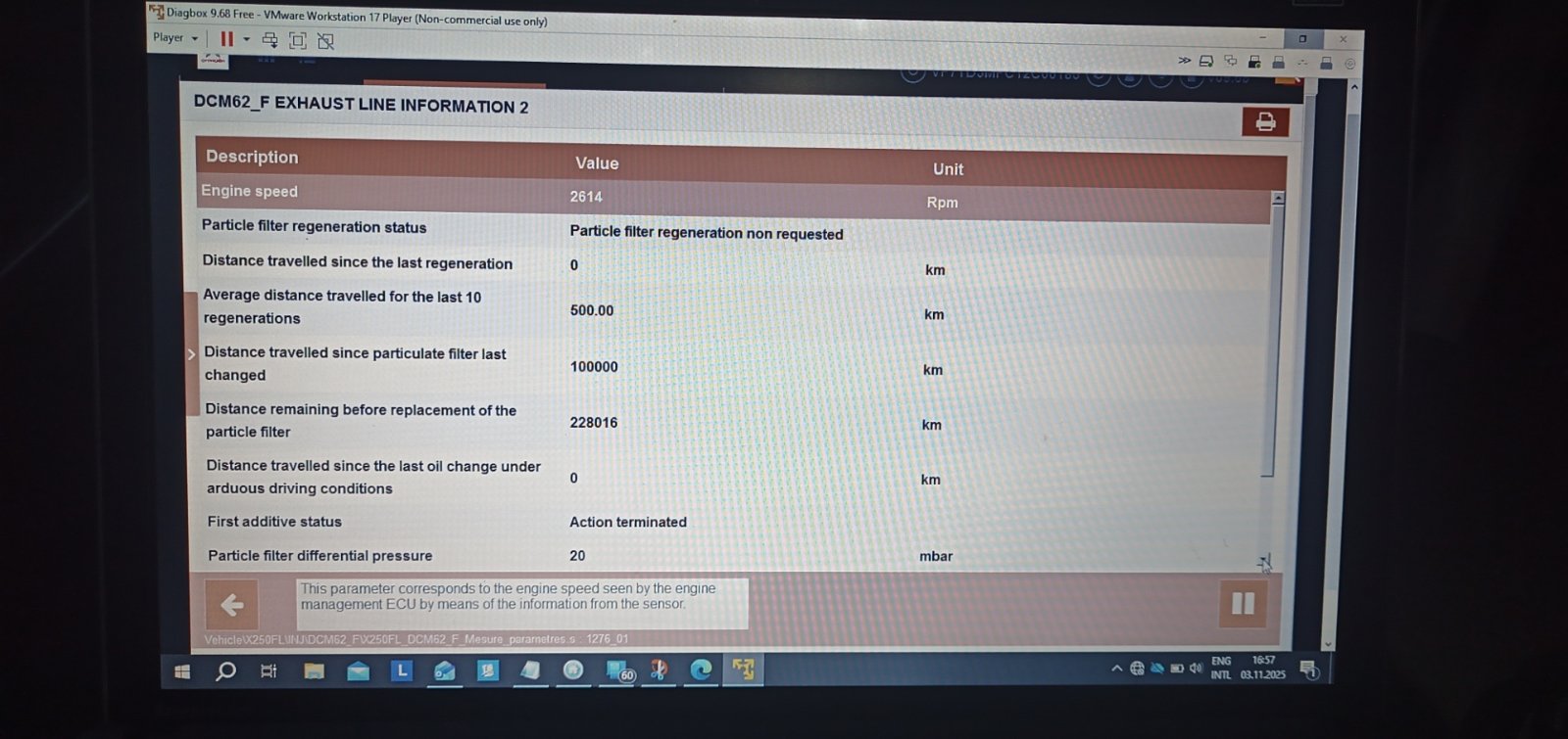

I was testing again today the additive pipe priming process, set the Diagbox to run the tank replacement procedure, the same message appears (First additive not started) but the pump was ticking in two rounds of about 3 minutes regardless of the Diagbox response. Then I reset the additive quantity again (refill procedure) to show 2620000 ml.
After starting the engine and let it run for a few minutes, I heard again the ticking of the pump shortly after ignition off. Only for about three seconds.
And it's first time I see the message "First additive status: Action terminated" instead "In progress" in Exhaust Line Information 2 page (see attached)
Thats good news, I guess. Bad news is the high differential pressure (25 mbar at idle with EGR at 30% and 50 mbar with EGR closed). Next stop, DPF deep cleaning.
