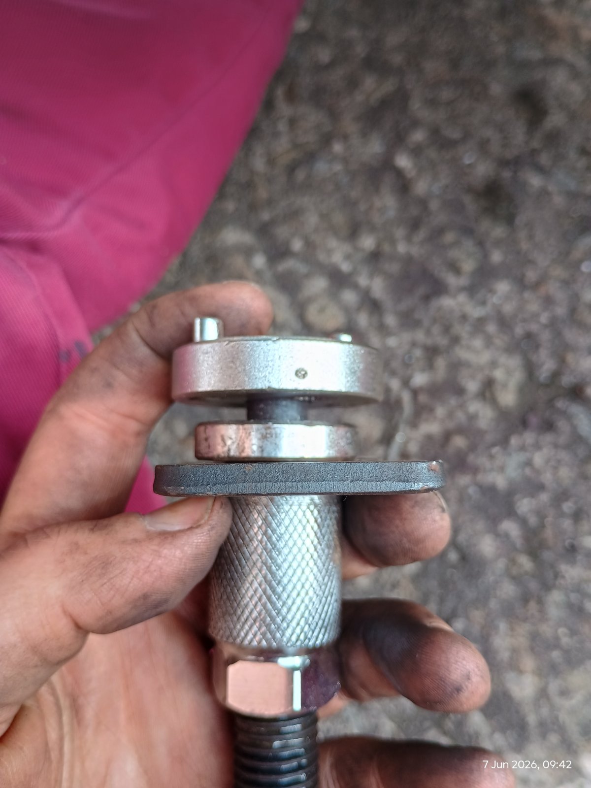

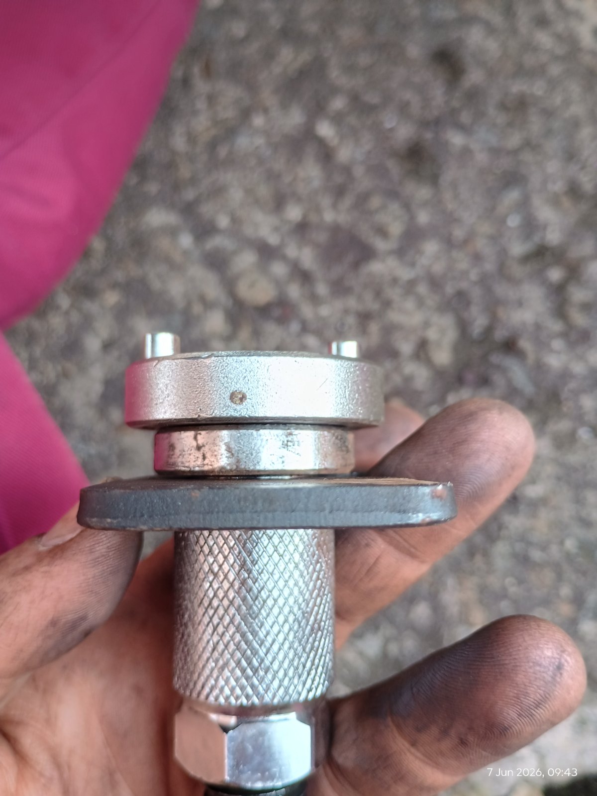

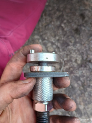

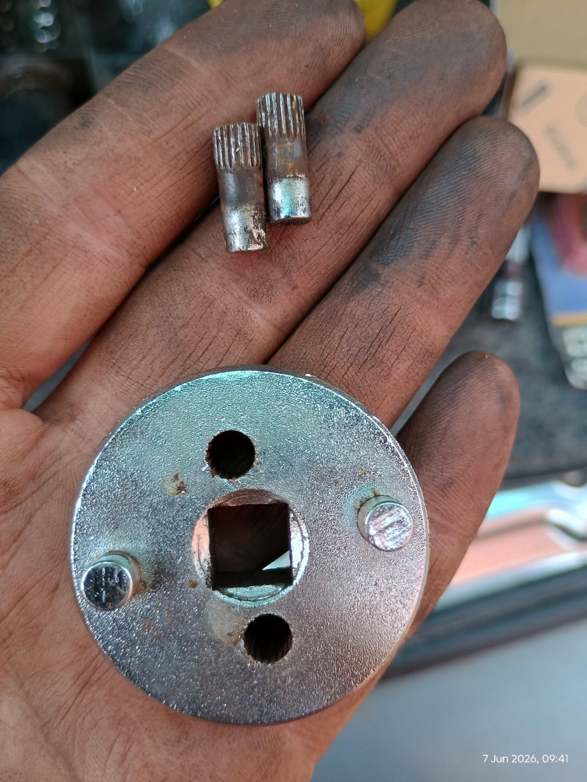

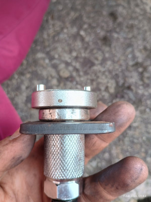

A few pictures, still on with this task
  • wind back tool modified/ made less universal as too thick to get it in place
Two pins driven out of the tool's head:
D
D
Allowed it's minimum position to change from approximately here
C
C
To here:
B
B

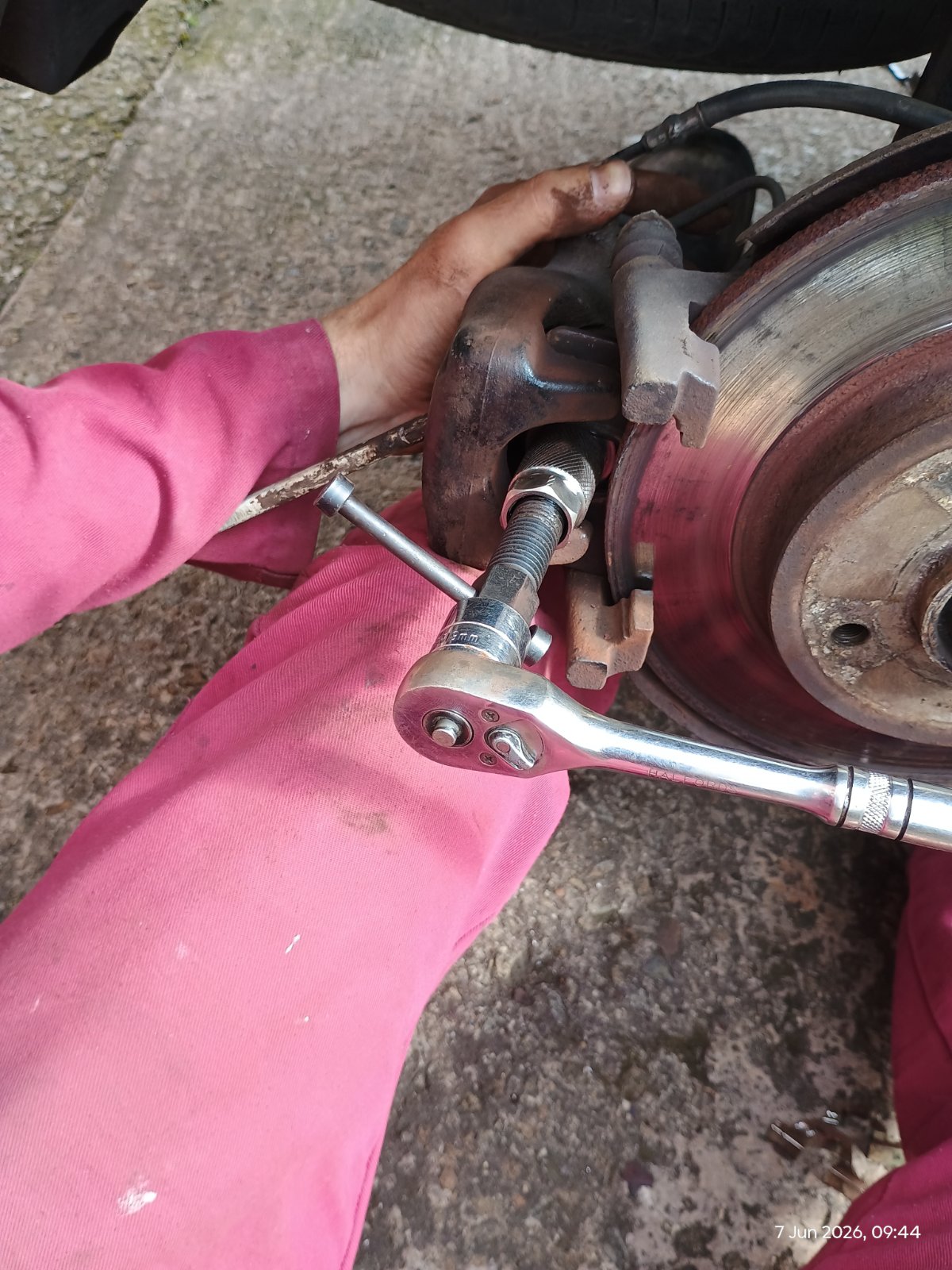

The little cross bar on the tool gave insufficient leverage, to 19mm socket and breaker bar, plus long screwdriver through caliper to steady it, let me drive the piston around and back in.
A
A
