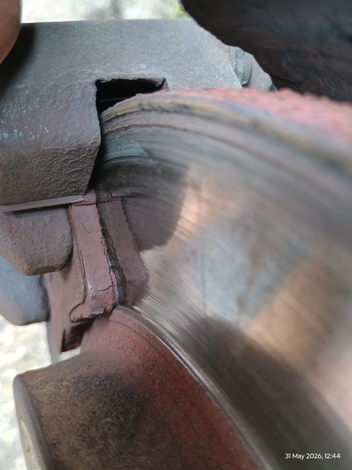

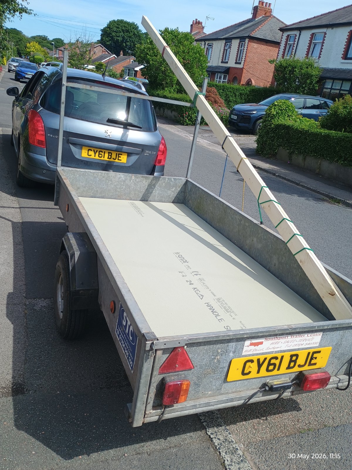

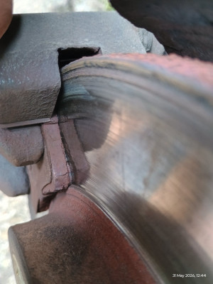

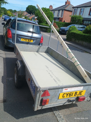

Grey 308 earning it's keep, second trailer job from yesterday (3 sheets of plasterboard, 1 sheet of 50mm polystyrene, 2 lengths of 4.8m 22x100 (4"x1"))
And it repaid us by a subtle scraping noise!
Spoiler: show
Rear pad, or lack of

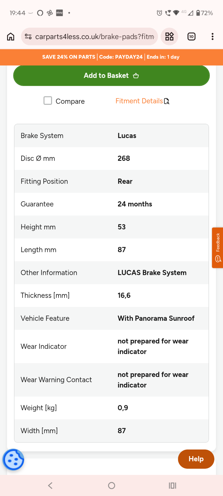

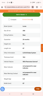

Hmm, so there's 249 and 268mm diameter rear brake disk options. What I wouldn't have guessed is what differentiates between the two sizes!
Vehicle Feature
Vehicle Feature
Bigger disk for the glass roof. I guess it's more weight, but surprised if it makes that much difference as to need bigger brakes! :o

Car Parts 4 Less, order to pick up (from Euro Car Parts branch) should be ready on Wednesday morning, so likely grab it on the way back from the office.
Just cheap pads, I'd pick decent quality for the front but less picky for the rears. £18.69 with the current "PAYDAY24" discount code.
