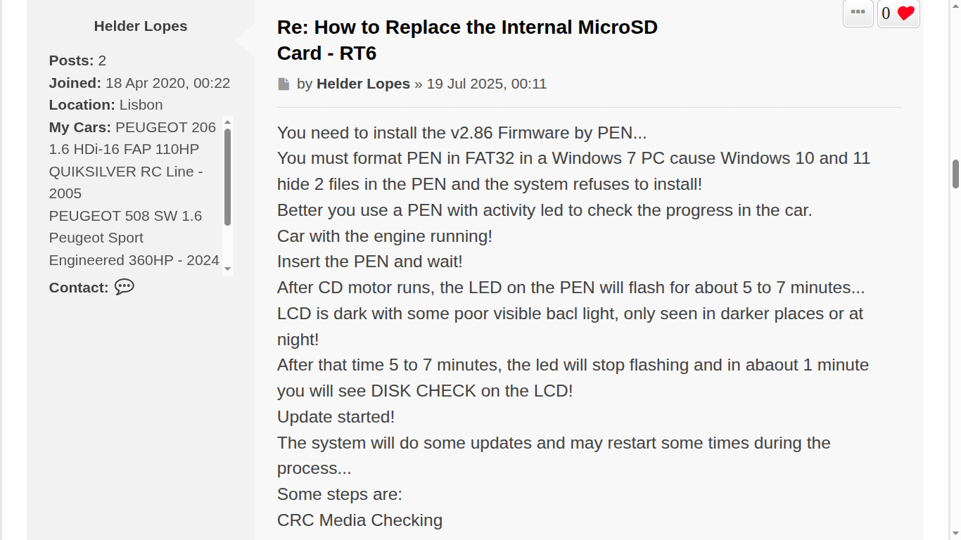

Hi Helder, do you still have all the software and could share? Im looking for older version up to RNEG 2.84 I have updated mine to 2.86 and my cluster cant see unit. I also seen you had problems updating, so make it sure your card size is not bigger as original one, however if its biger you can re format and and allocate size which your unit can support, as I had this problem with my RT6 unit. However my unit as unit working fine its just on the cluster my radio says always off and im getting fault U1F37 87 via thinkdiag....

Who is this Helder? It's not a user name here.
