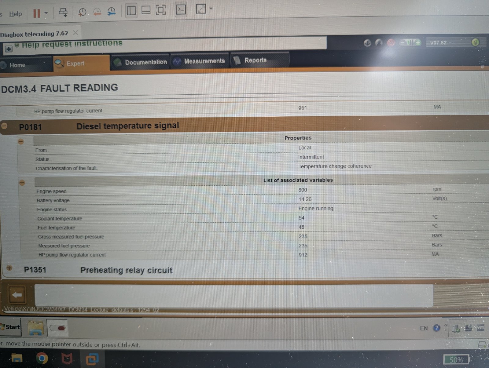

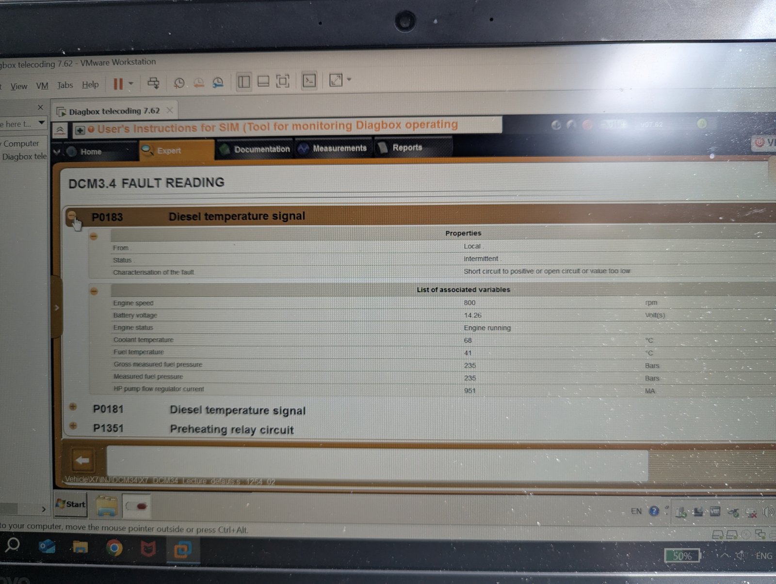

Re: C5 X7 cutting out
I'm in diagbox now and have found the fault codes, is this the freeze frame data you were talking about?PaulC5 wrote: 01 Jun 2026, 21:51 Before you delete the codes look at the freeze frame data and note it down. These are the values of sensors when the last fault was stored. They may give a clue as to what happened. This data is deleted when the codes are deleted hence why it should be noted first.
I do not know which engine you have but on our 2007 C5 2.2 hdi the fuel pressure regulator was attached to the bottom of the hp fuel pump. I was going to change it but access was too limited, needed long thin torx/allen bits (cannot remember which) but I swapped the car before doing anything. To see it I needed a mirror/torch and to see what part number it was I took a photo of its reflection in the mirror. PF Jones sell the parts as new and also at a lower cost reconditioned.
P0181 coolant at 54c and fuel at 48c seems a little wrong.. I would expect that coolant would be significantly higher than the fuel temp?
