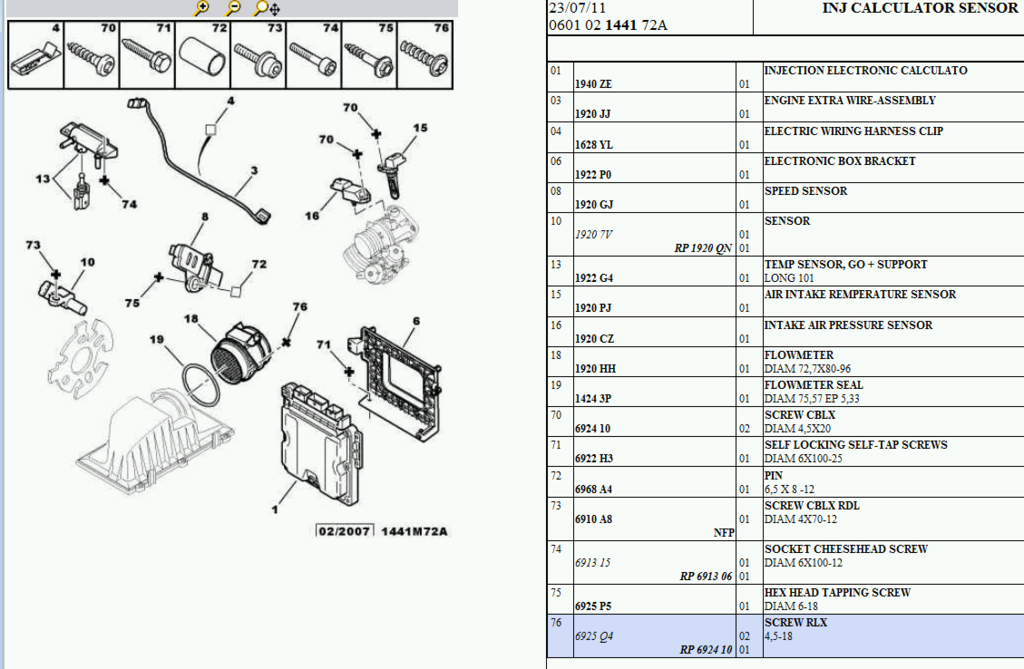

I can't help with a photo as I sold my 2005 C5 2.0 HDi Exclusive - but if yours is the same engine, here's a diagram of the injection calculator sensor - if this is the sensor you are referring to it's number 10:

Different engine then, but hopefully somebody will be able to get a pic for you.

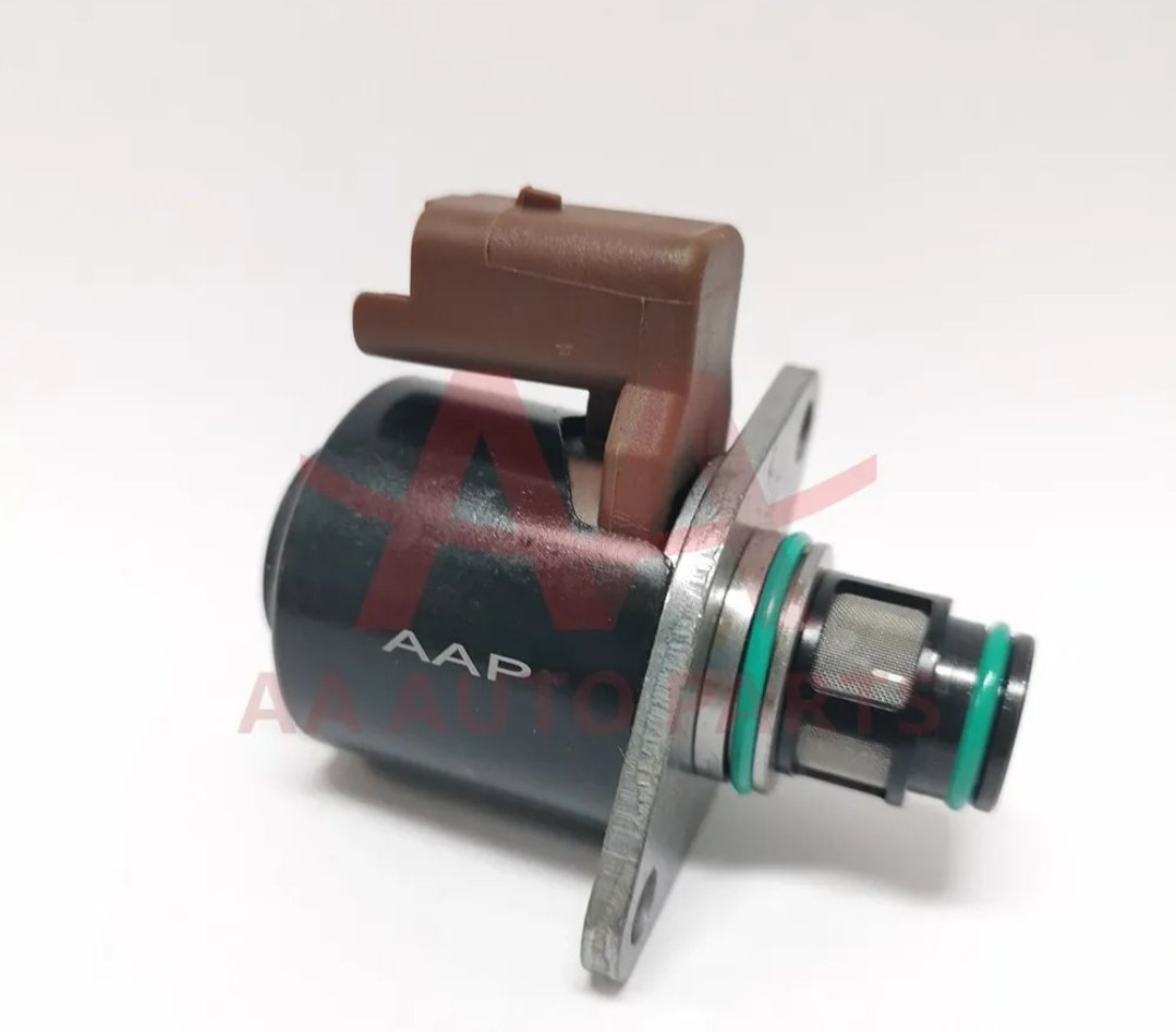

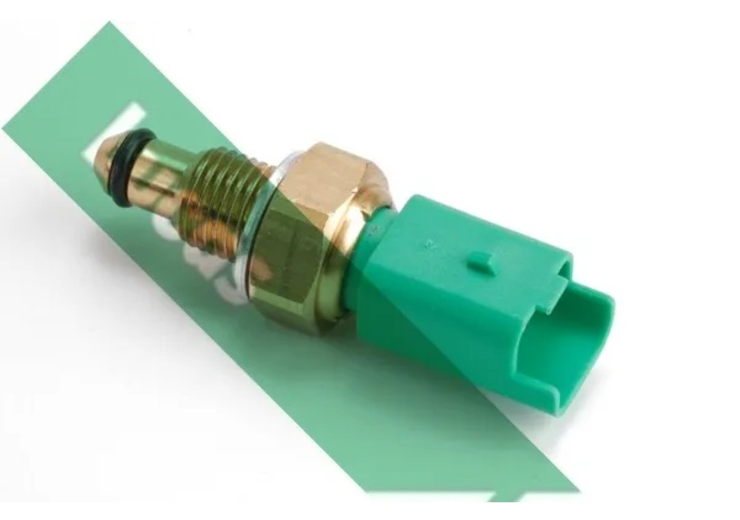

P0181 p0183
These are known fault and there is a tech bulletin on Peugeot service box
Caused by faulty worn fuel pressure regulation valve / suction control valve on high pressure pump
Need to replace the pressure regulation valve and temp sensor on high pressure fuel pump together
This is on the RHR DW10BTED4 ENGINE
Often a metallic rattle knock can be heard on take off from fuel system and this is sign of the failure. Part numbers needed are

Hello, I think I'm facing this exact issue with my 2009. built 308. It's also with a 2.0HDi, 100KW. I managed to find the fuel pressure regulation valve. However, when I type in the part number for the temperature sensor, all I get are water temperature sensors with that same part number, 1920NH. Are those interchangeable in this case? They look the same as the one on the picture you provided, here's the link to the part. The site is in Serbian though:
https://www.prodajadelova.rs/senzor-tem ... log-as2156
I'd be super grateful if you could clear this up for me
