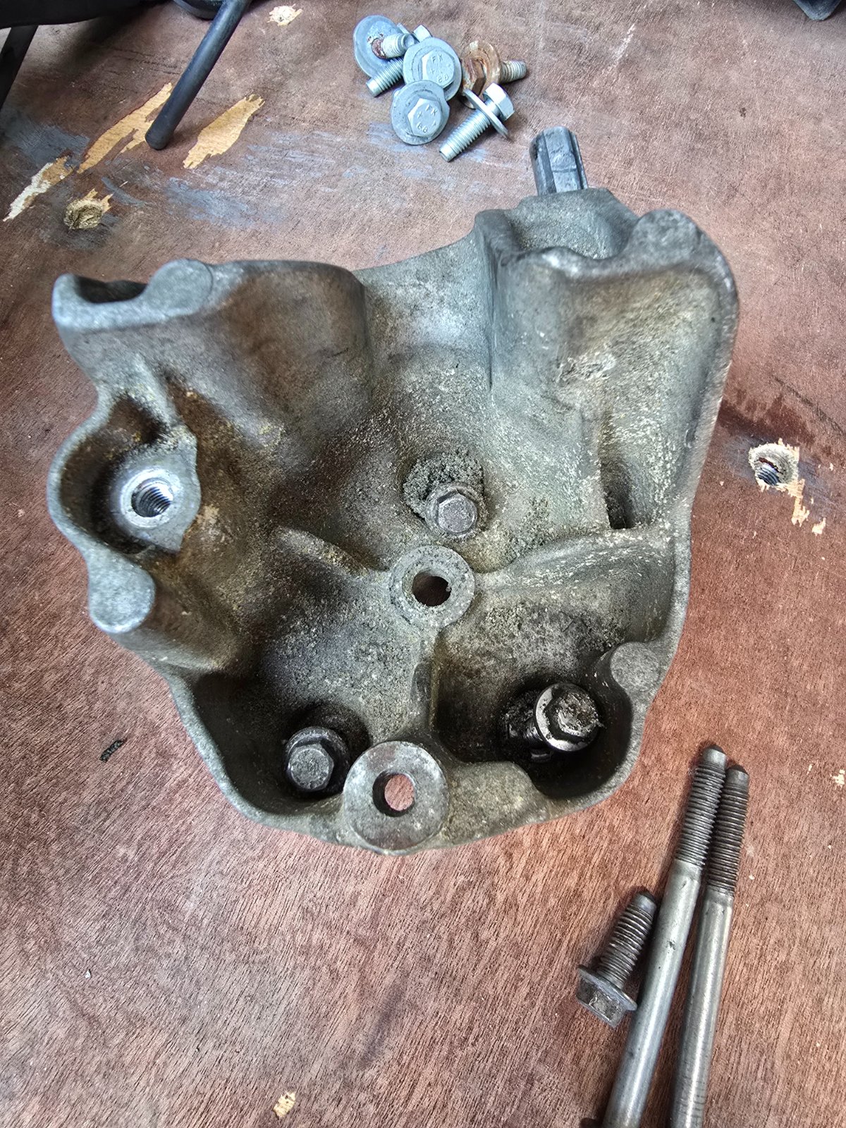

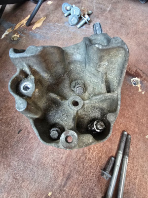

Trying to identify this, it fits in the alloy housing pictured which is above the HP pump on the 1.5HDI where the fuel filter used to be sited..check valve? Been googling all afternoon..

Please sir, may we see the other side?
I'm going to guess "vacuum reservoir". Where did the pipe connections lead?

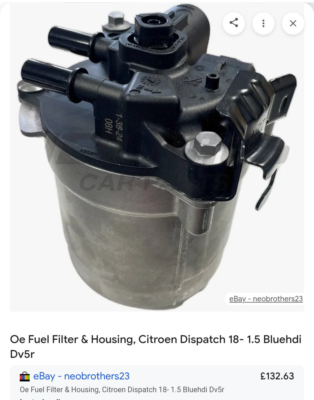

mickthemaverick wrote: 28 May 2026, 20:08 Does this give you a clue?
https://www.ebay.co.uk/itm/316264419792
Hmmm, I'm not sure if it does, Mick!
I googled "dv5r fuel filter" and get different looking thing-a-ma-jigs!
E.g.
- Posts: 21343
- x 8156
Re: What is this ?
The reason I posted that ebay offering Matt was that, besides looking the same, it is for a 1.5HDi which matches the car in question. I wonder if the designs differ according to the engine they are fitted to?
- Posts: 5364
- Joined: 25 Apr 2022, 09:03
- x 2367
Re: What is this ?
Yes it's a good visual match - I didn't explain myself well - I wonder if the vehicle dismantler has identified it incorrectly.mickthemaverick wrote: 28 May 2026, 20:28 The reason I posted that ebay offering Matt was that, besides looking the same, it is for a 1.5HDi which matches the car in question. I wonder if the designs differ according to the engine they are fitted to?![]()

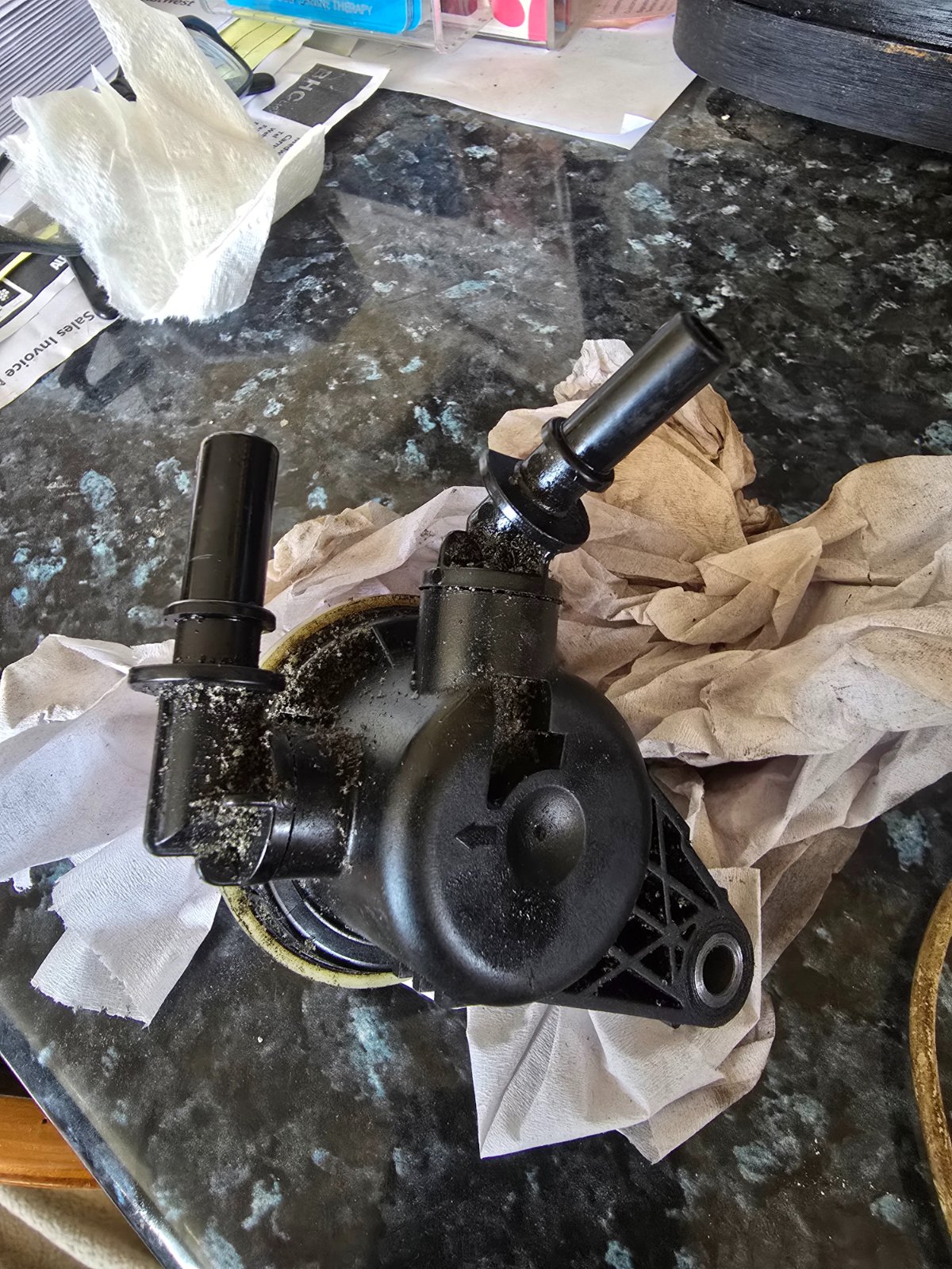

On the other related topic about this part I posted this reply. Also if it has been put in instead of the fuel filter then there seems to have been a bodge.
I did a google lens search (right click of mouse on the picture) on your picture and it came back with something very similar on ebay listed as a fuel tank valve with part number 9831640680 https://www.ebay.co.uk/itm/277130841856 It could well be a check valve as you suspect.

That filter is for cars with the main filter above the HP pump. My Partner has its 'main' filter beside the tank. Mick may be correct in that this small unit I posted the picture of appears on ebay as pt no. 9831640680. Fuel tank valve?? Or it may be a last chance filter..either way I think I need to replace it before the HP pump..?MattBLancs wrote: 28 May 2026, 20:24mickthemaverick wrote: 28 May 2026, 20:08 Does this give you a clue?

Re: What is this ?
https://www.ebay.com/itm/135172450376
Thats the fella..£32.34 from Arnold clark. They have it as a damper.

These are all ads from sellers who gave new names for that part: Fuel Filter (wrong), Damper (maybe), Valve ( maybe). But on this page (https://rrr.lt/en/used-part/att41102-98 ... -regulator) it seems that finally the right name is associated with the function. I don't know how it can regulate the pressure, it seems to me that it is rather a non-return valve that prevents the fuel from returning back. In this problem, that part is probably defective and should definitely be replaced, because that will determine if it is defective.It is cheaper than the HP pump and is easy to change.
