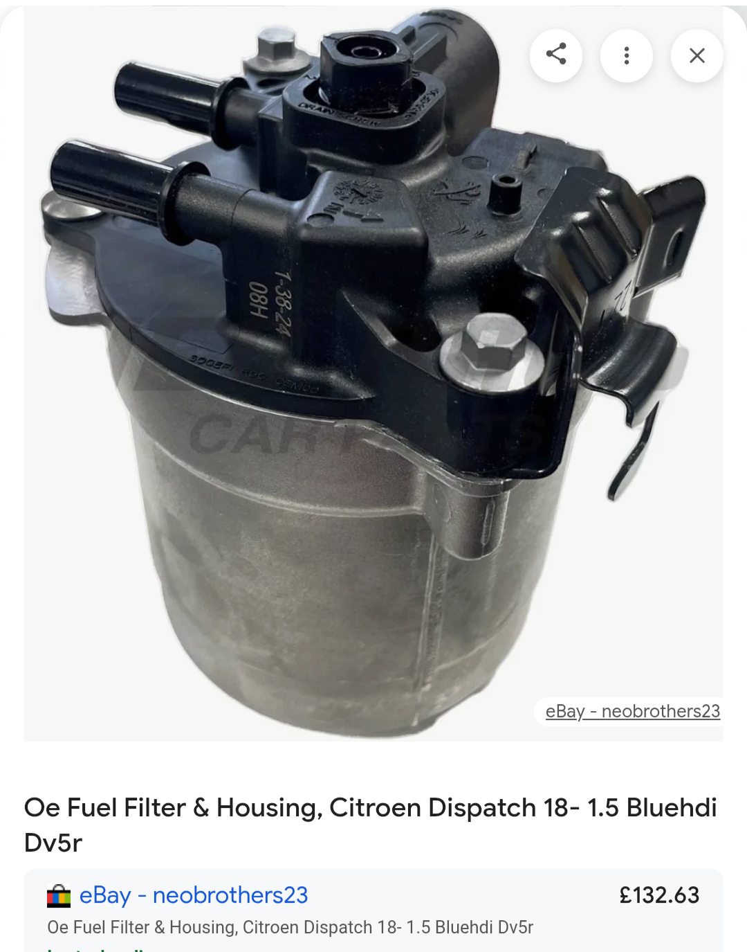

Hmmm, I'm not sure if it does, Mick!
I googled "dv5r fuel filter" and get different looking thing-a-ma-jigs!
E.g.

Re: What is this ?
Yes it's a good visual match - I didn't explain myself well - I wonder if the vehicle dismantler has identified it incorrectly.mickthemaverick wrote: 28 May 2026, 20:28 The reason I posted that ebay offering Matt was that, besides looking the same, it is for a 1.5HDi which matches the car in question. I wonder if the designs differ according to the engine they are fitted to?![]()
