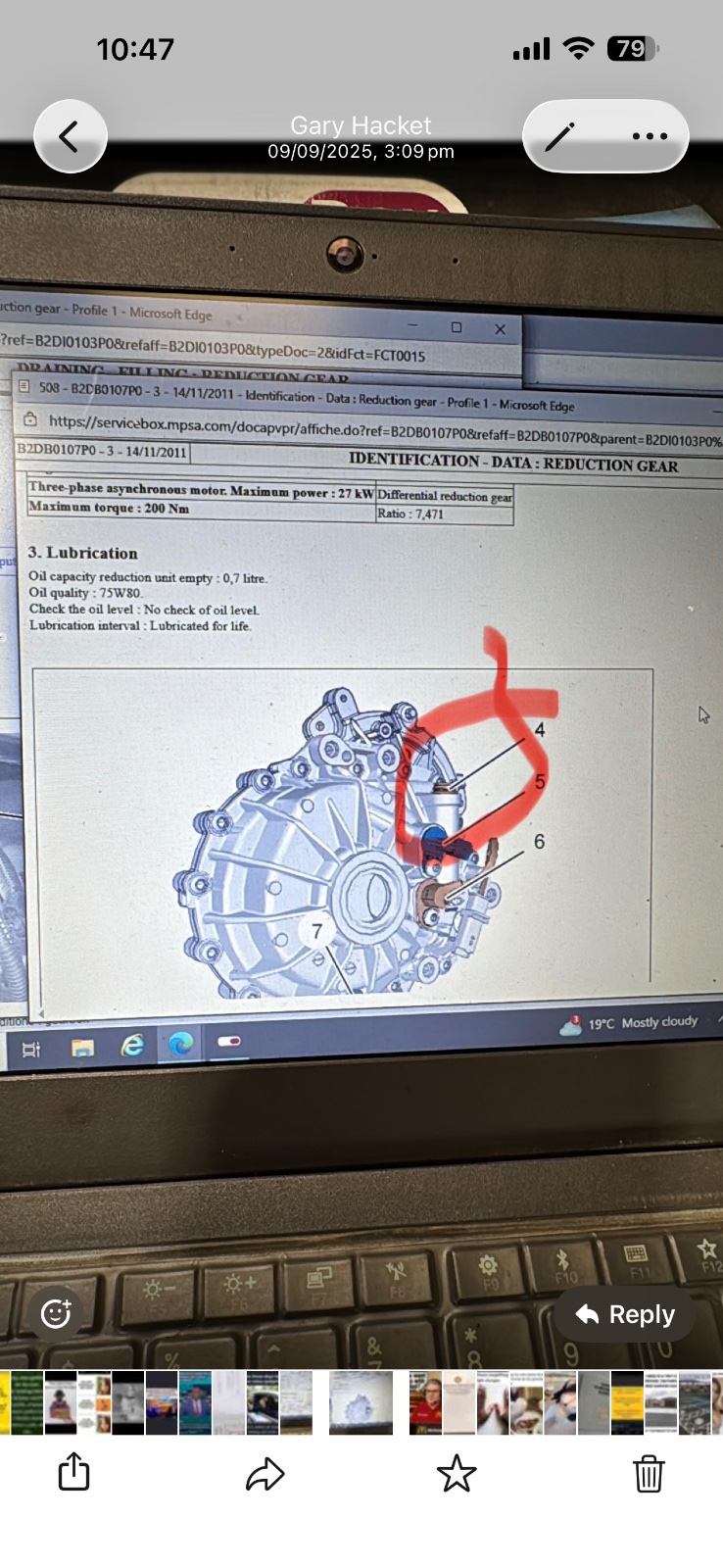

Hi you can’t really see the breather it’s at the top of the reduction gear, you can only just see the pipe from the breather I will send you a pic of the reduction gear from diagbox!!

Mick I posted a photo of where the oil breather is, and that is where the oil is coming from on this 3008 hybrid4, a short rubber pipe attaches to the top of that breather and goes up above the reduction gear and oil weeps out of the rubber pipe, do you have any ideas, I would greatly appreciate your help!!
