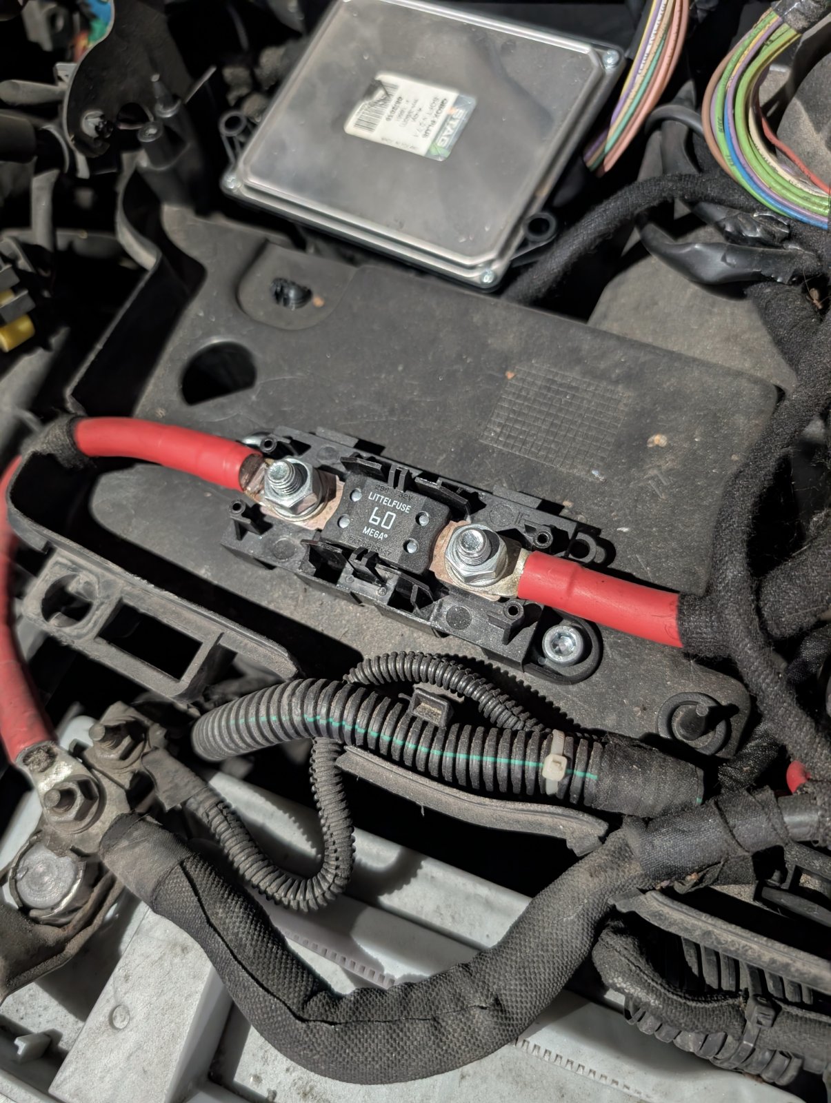

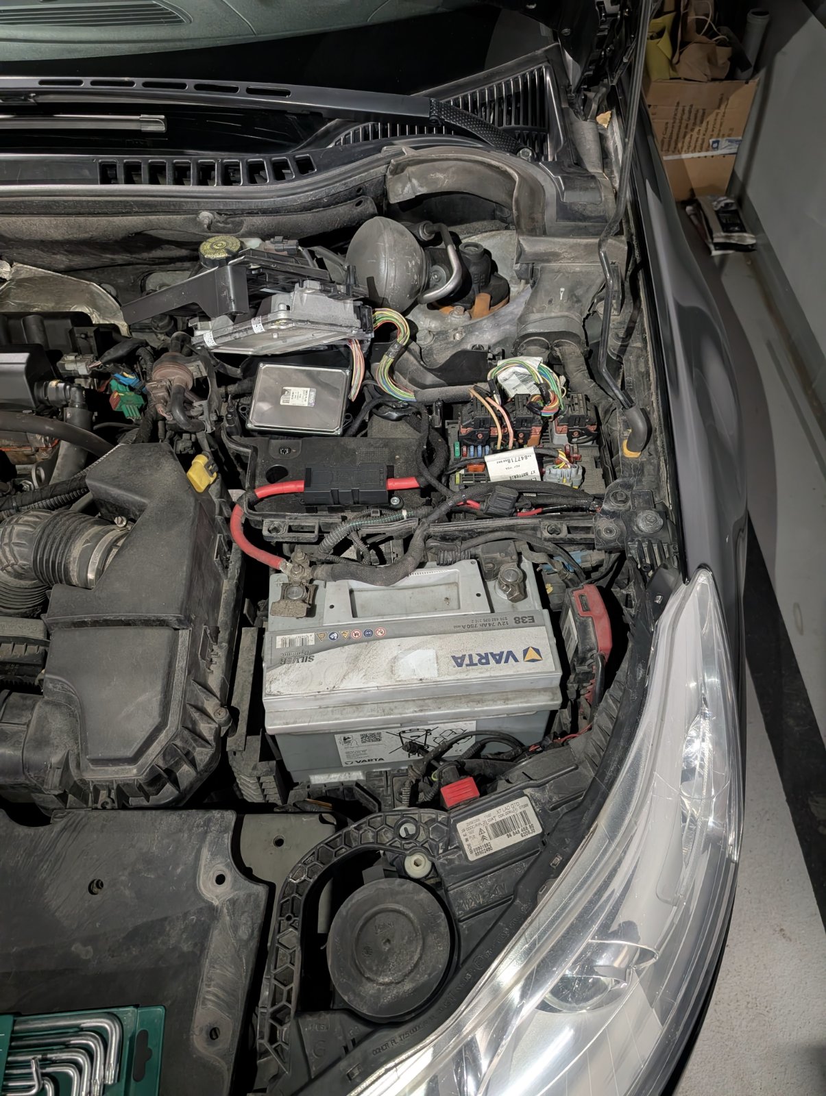

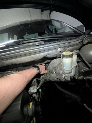

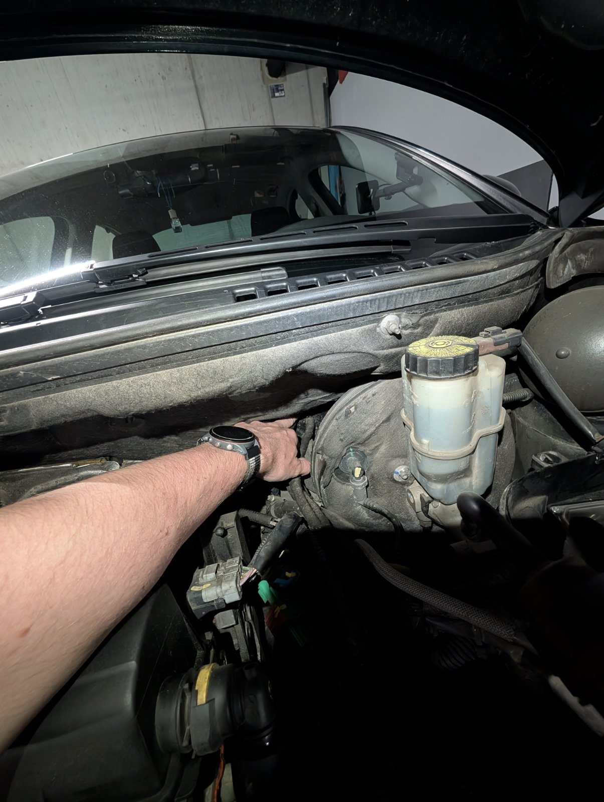

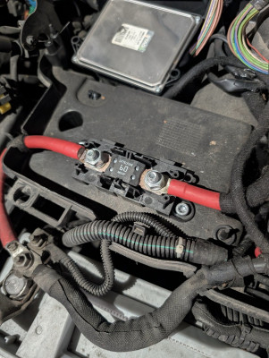

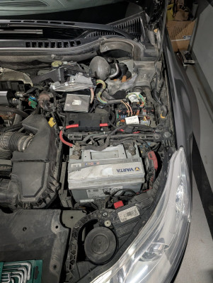

My car is Left-hand-drive, 2.0 petrol.

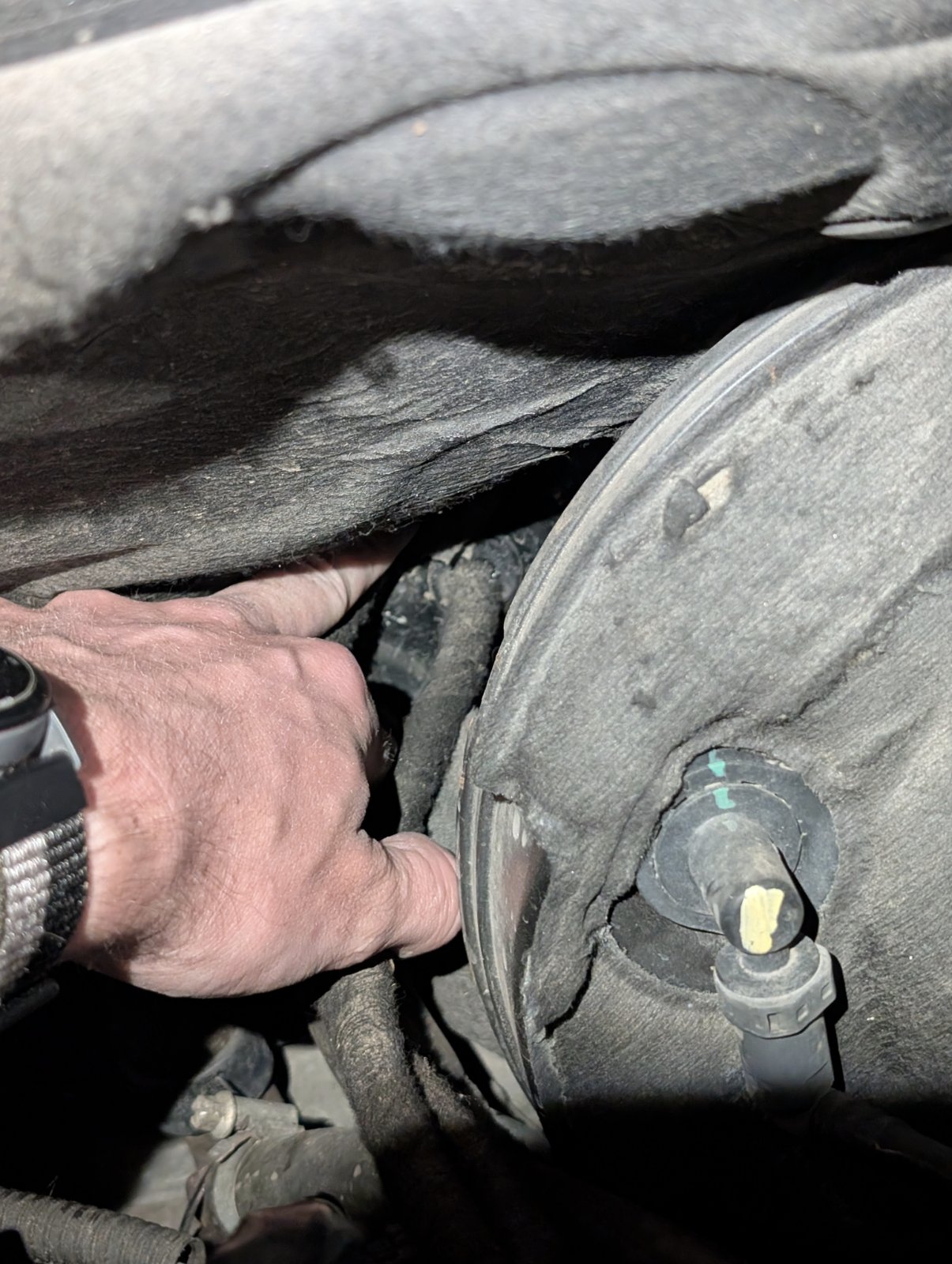

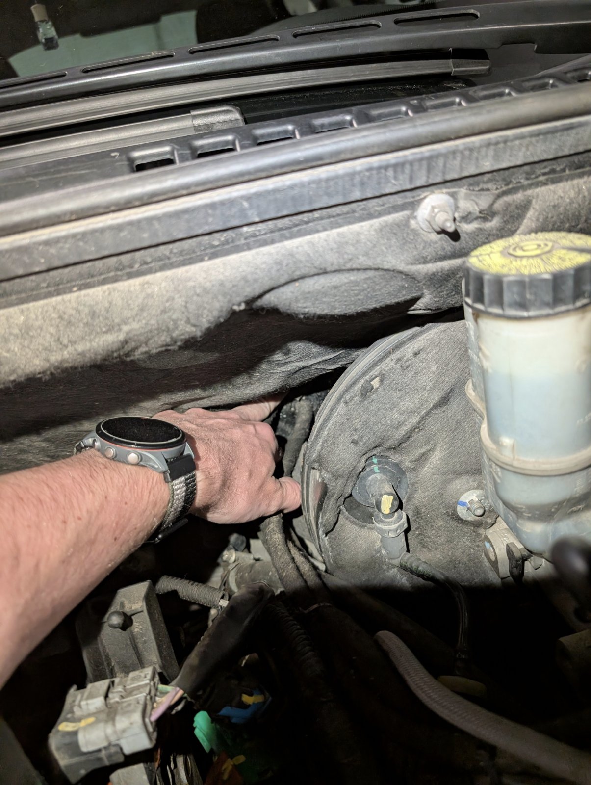

Take a look: the cable I'm holding with my thumb is the one leading to the amplifier, you can see how it enters the firewall grommet.

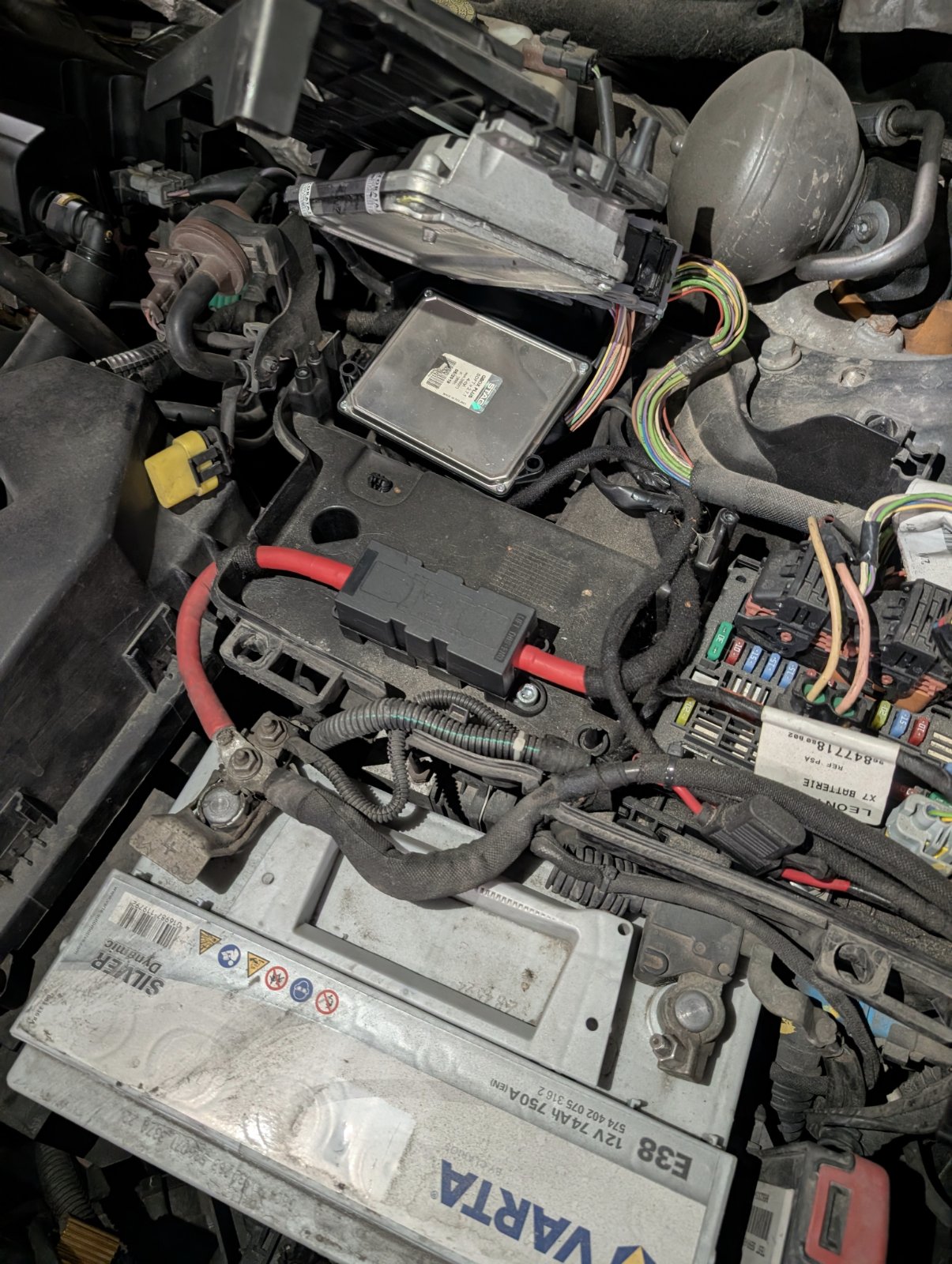

I also took pics of how I installed the fuse, maybe this brings any value to you (in the ECU compartment, I've removed battery cover and the ECU cover to take the pics)
I don't remember if I had to drill, I think the grommet is quite thick so its not really possible to pierce it with a needle, maybe try removing it with pliers first to take a look.
