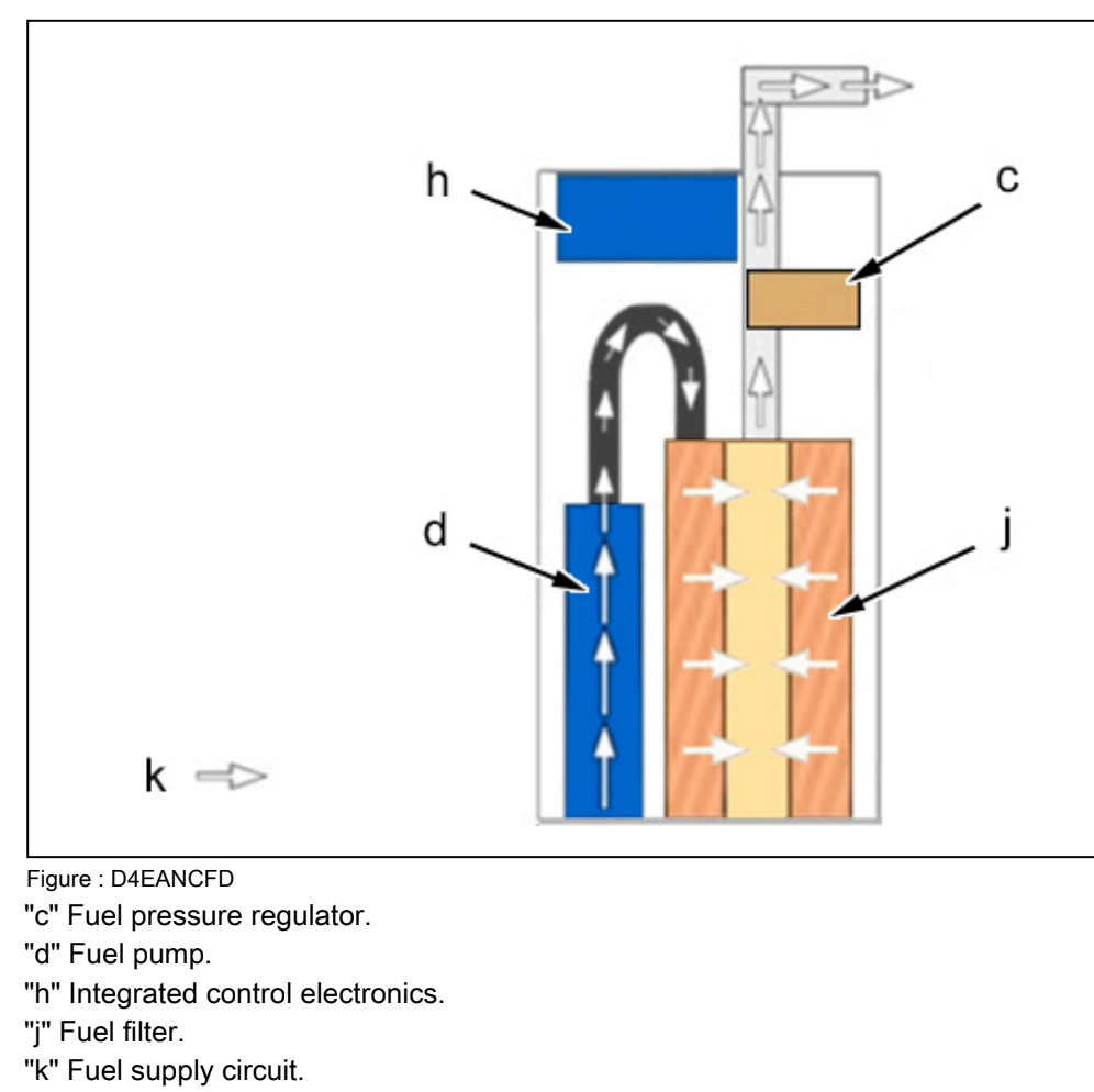

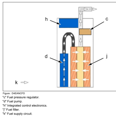

For anybody else reading there is no external fuel filter(can be on models in regions with dirtier fuel).
But there is 2 of them in the low pressure fuel pump in the tank, but on this models/hybrid and hybrid4) the tank need to be lowered for checking and replacing the low pressure(5.2 bar) fuel pump
One suction mesh in the bottom of the suction tube/pump and then a built in fuel filter inside the pump that cant be replaced.

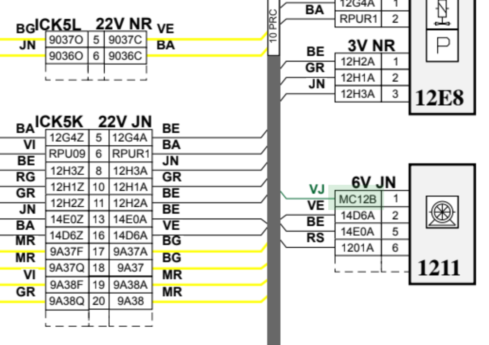

I want to validate the integrity of the cables running to the low pressure fuel pump.
So Im trying to find this 2 connectors:
ICK5K 22V JN(Yellow) Its the connector for signal cables(pwm for running the pump and system info line)
ICK5H 22V BE(Blue) Its the connector for the supply
These connects between the 10PR(Main) and the 10PR(Rear hybrid?) looms i think, please correct me if im wrong.
Please give me some hints if you know the locations.
Please also give me some poniters on good values for the fuel pump( I guess grounded and unlimited ohms is bad for all these except earth
I have checked and verified the earth point MC47 its located on the left side on the inside of the door sill. The most front one is the MC46 and the last one is the MC47

The contacts are located under the back seat together with ICK5Y(black).

After measuring in the socket and measuring the fuel pressure the car started and ran fine, so either it was some dirt or oxidation in the socket or it will start acting up again when it gets warm.
I will keep it under observation for a while and if it works i will put it under bad connection.
It can also be the cables that have some kind if damage under the car, but i ave to wait and see.
Will not drop the tank just now any ways.
