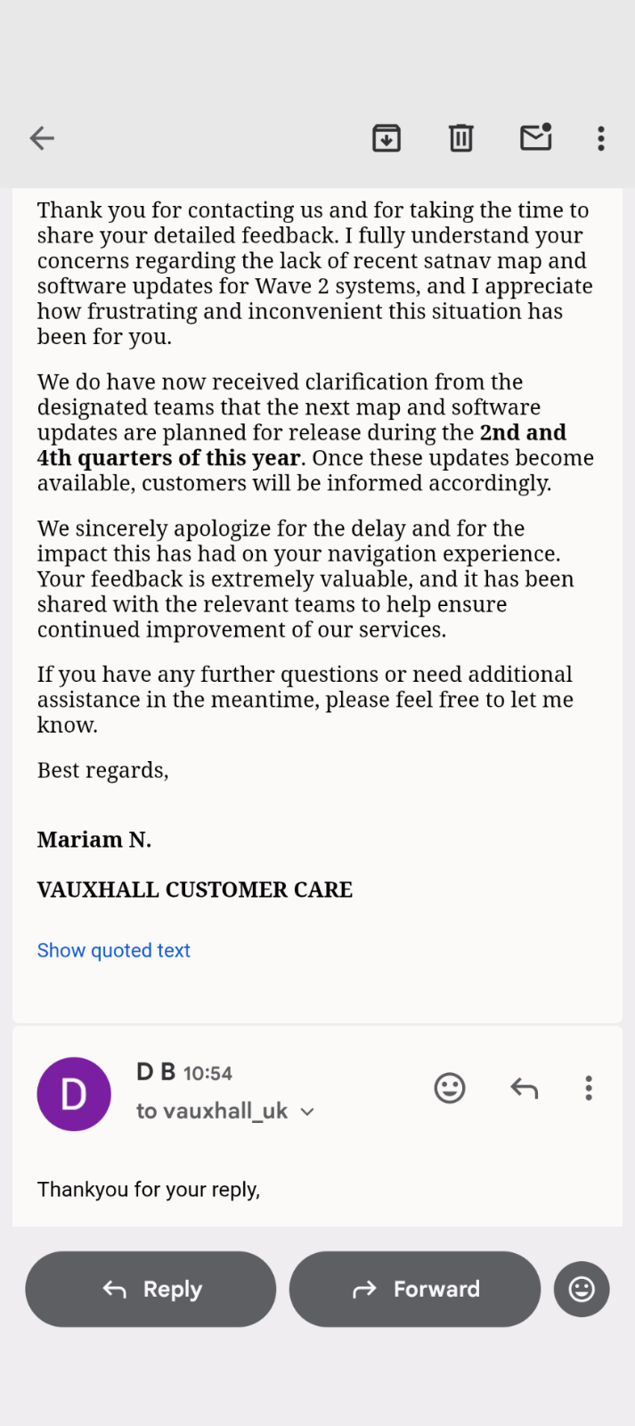

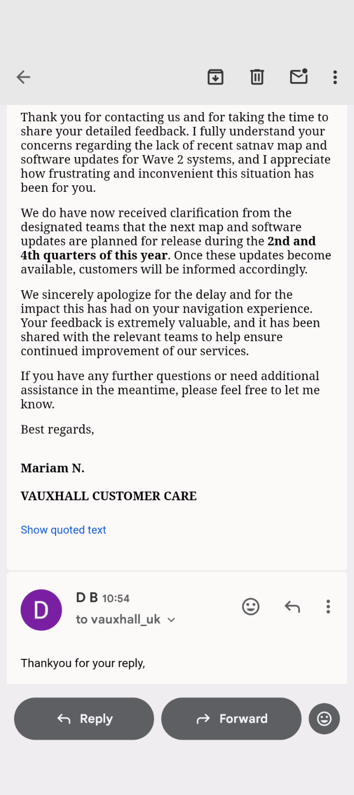

Re: PSA NAC RCC Updates
Been trying to find info for Wave 2 for a while and seen this forum. Emailed Vauxhall the other day and got sent this as a reply. Quarters 2 and 4 will have map updates, so by the end of June, there should be an update.

@RuiBoothy91 wrote: 14 May 2026, 14:38 Been trying to find info for Wave 2 for a while and seen this forum. Emailed Vauxhall the other day and got sent this as a reply. Quarters 2 and 4 will have map updates, so by the end of June, there should be an update.
If this is true Rui, the Wave 2 getting updates, then how can we feedback to Continental for fixing the wheel scroll functions and the Android Auto size and the car info placement on the 12" screen ?
