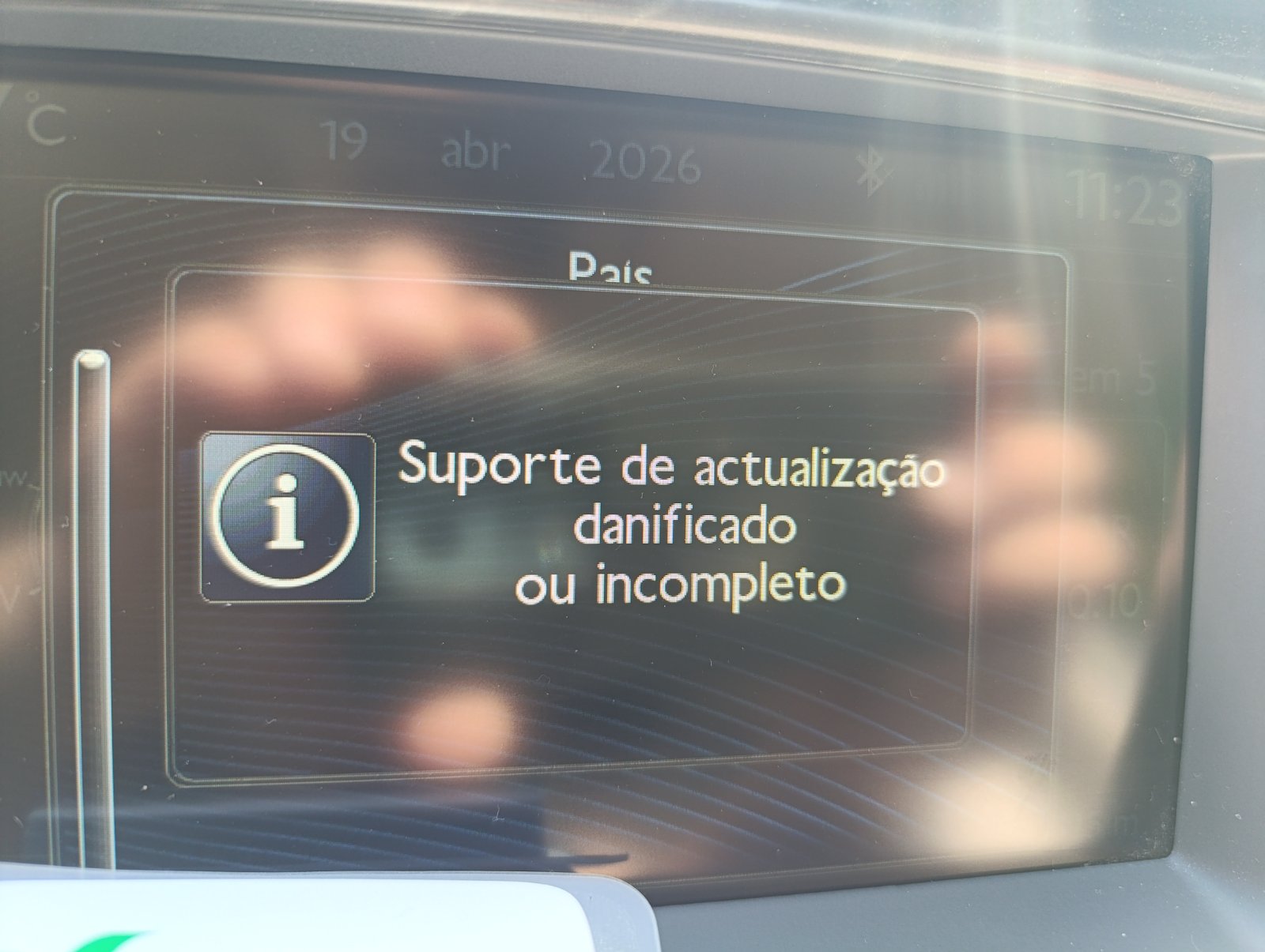

Good afternoon again. I installed version 2.86 on my RT6 radio, but the maps have completely disappeared. I've already tried installing maps via USB drive, but the message "damaged or incomplete update support" appears on the screen. Could someone please help me? Thank you.

Re: Atualização rádio e GPS rt6 peugeot 508 (Peugeot 508 RT6 radio and GPS update)
Try downloading the maps again.
Good afternoon Paulo R.
I downloaded the maps again on my RT6, but it seems it didn't work yesterday because I hadn't generated the Java codes.
Today I did everything correctly as the tutorial explains, generated the Java codes, then just inserted the USB drive into the car and it immediately asked which maps I wanted to download.
I downloaded the maps of Portugal and Spain, which took about 20 minutes, and then I could just start driving.
Thank you for your help, without which I would still be looking for solutions
