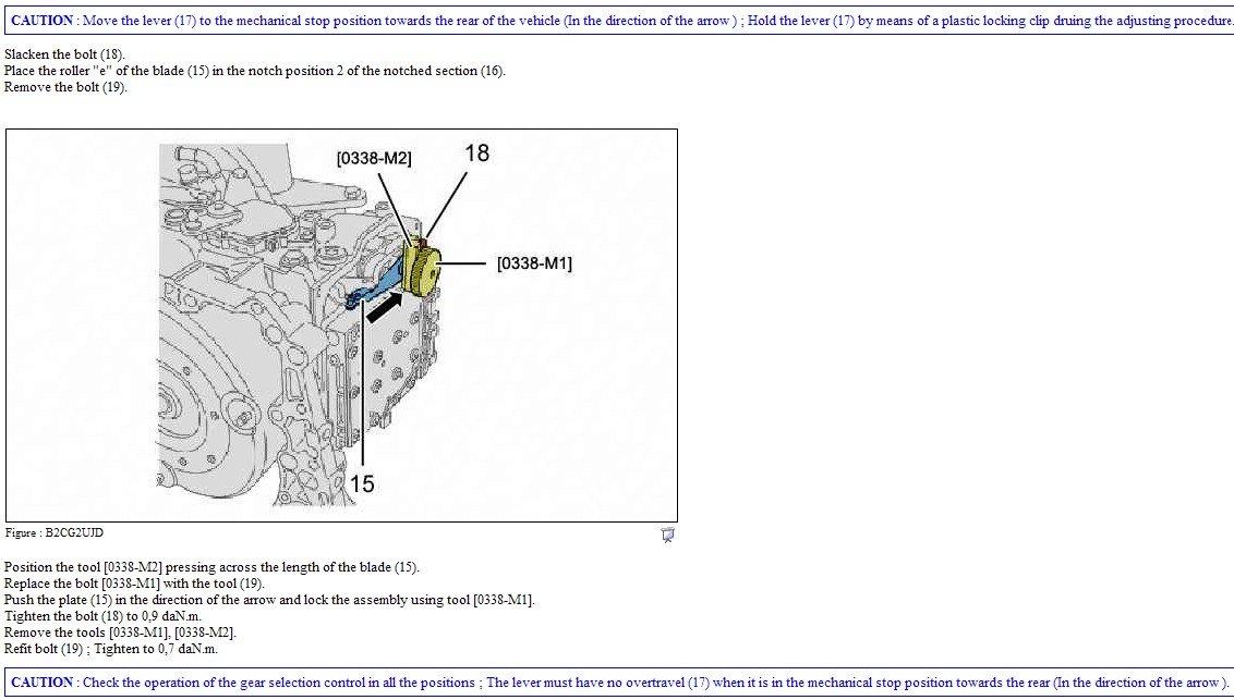

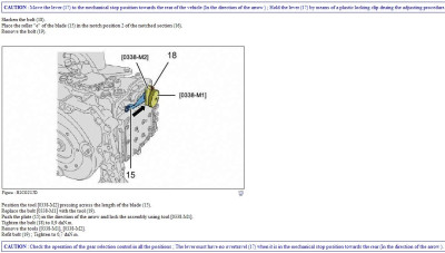

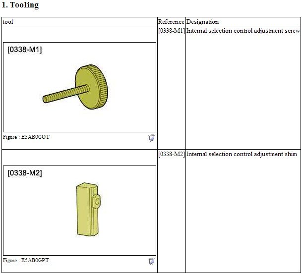

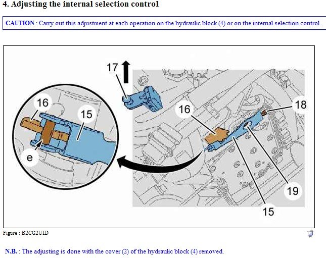

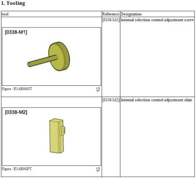

Sounds to me like the internal gear position selector has not been set up correctly when it was re fitted, there is a special tool for this but its easy enough to fabricate one.
If the car doesn't know what gear it is in then it will not start.
