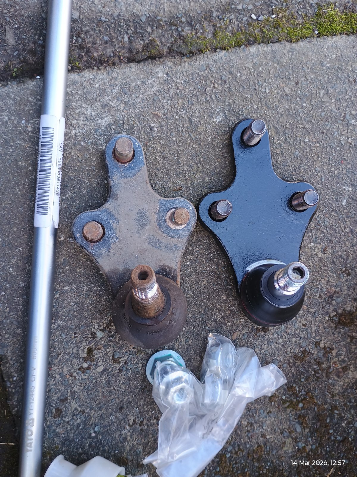

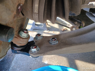

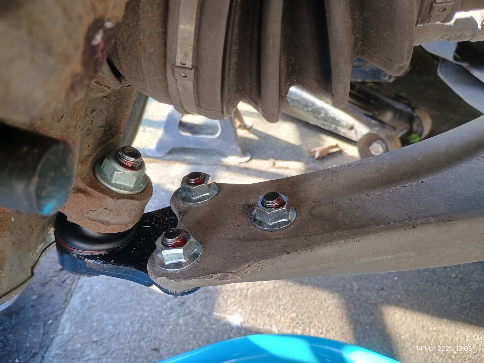

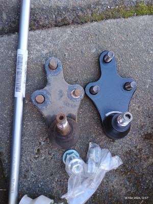

A pair of ball joints from GSF arrived on Thursday, so as the sun was out I set to and got the driver's side swapped (other side isn't showing signs of wear / play so will stay as is for now)
Thankfully the correct dimensions this time around!
That's more like it!
All the fixings came off without a fight :wink:
Job done
Job done

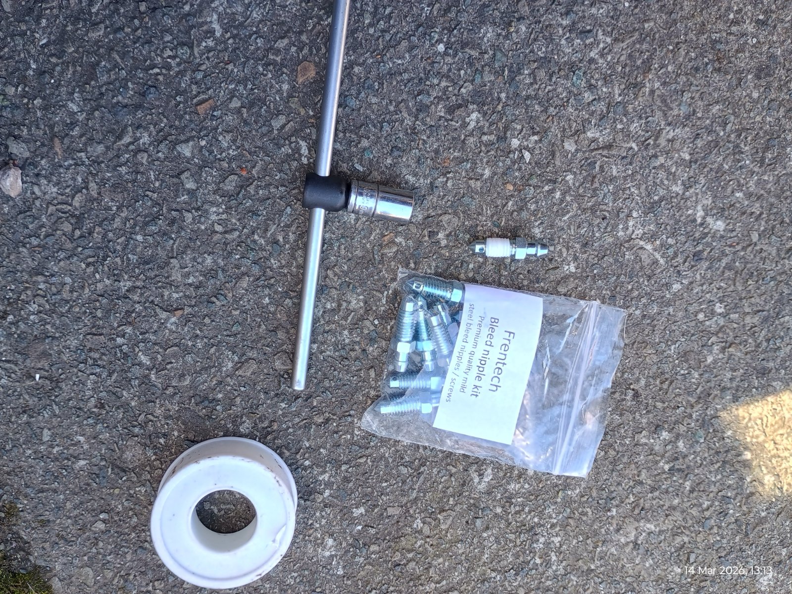

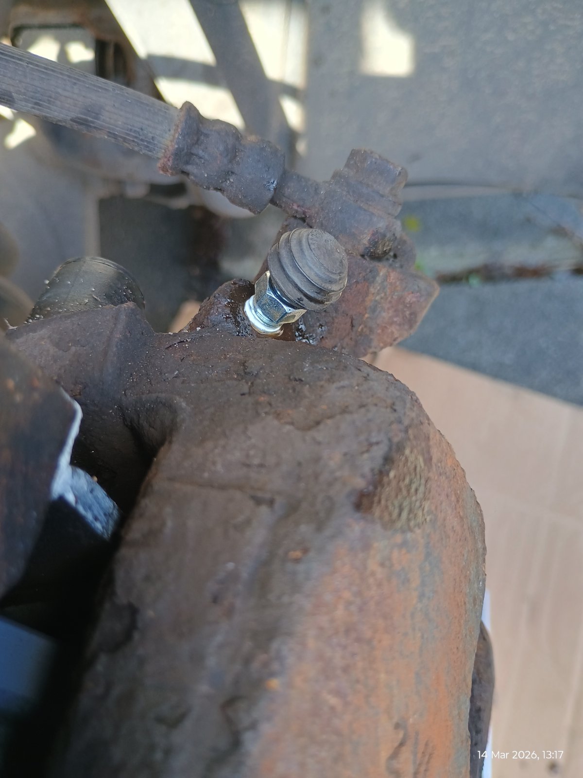

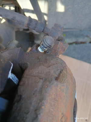

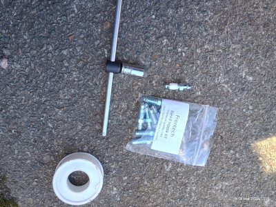

Also arrived in the post was 10 new M8x1.25 bleed nipples, so swapped over the driver's side caliper nipple whilst accessible
Shiny Nipples
Shiny Nipples
9mm hex, I like this 1/4" drive Tommy bar for applying torque without bending forces.
Bit of PTFE that'd help potentially vacuum bleeding if needed.
Installed
Installed

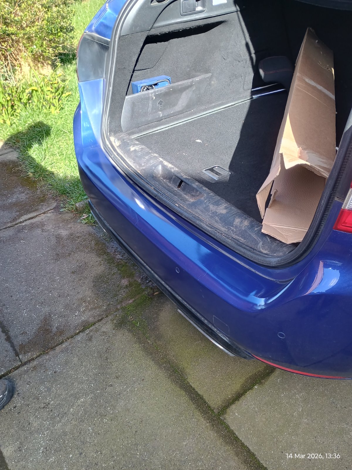

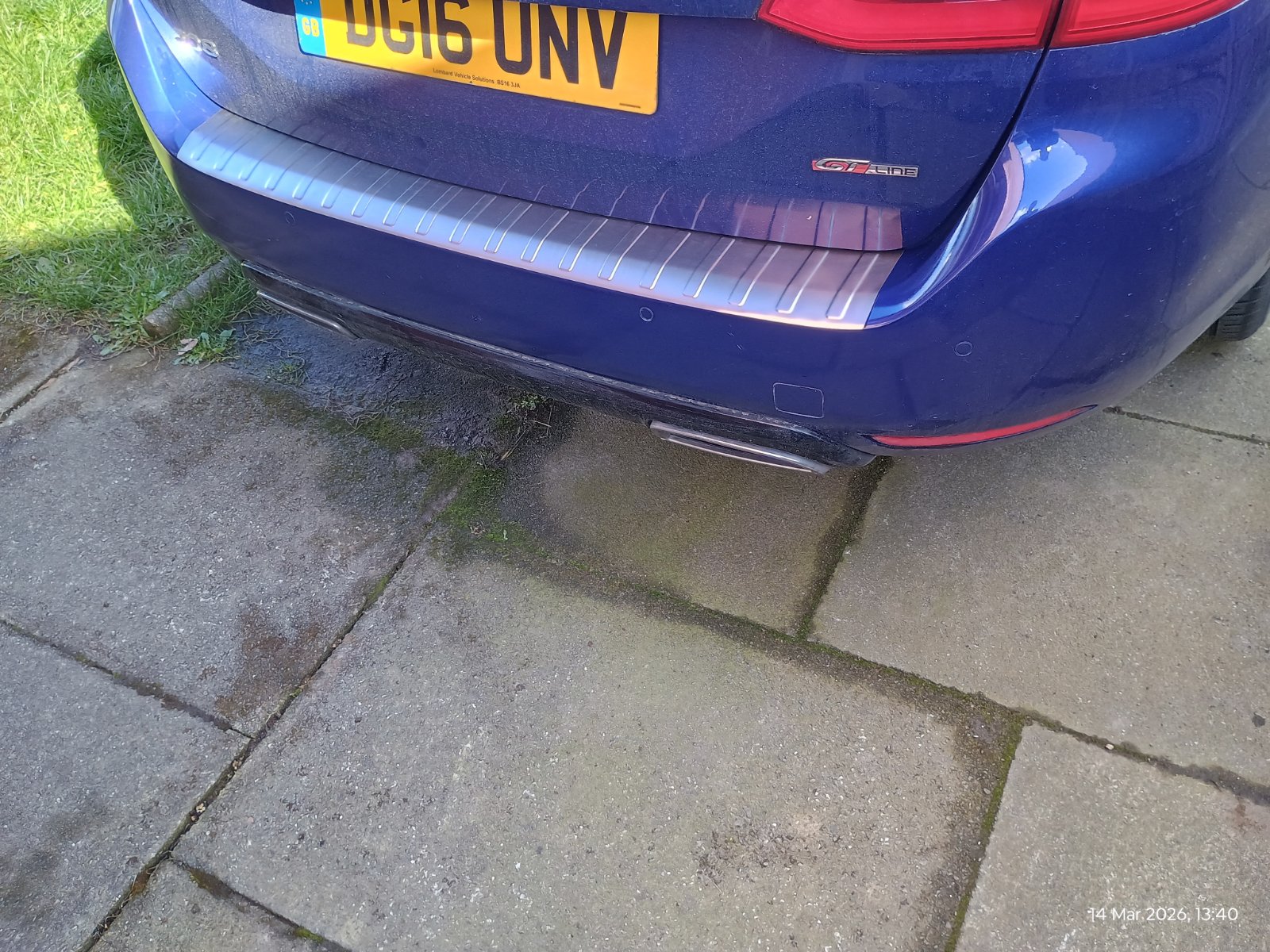

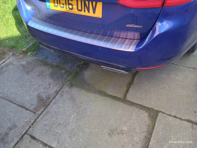

Next, something I'd had in my Watched Items for about 6 months, recently reduced by a few quid (£39.90 delivered) a bit of bling, or more importantly hopefully good protection to the rear bumper top surface.
Before
Before
Then:
After
After

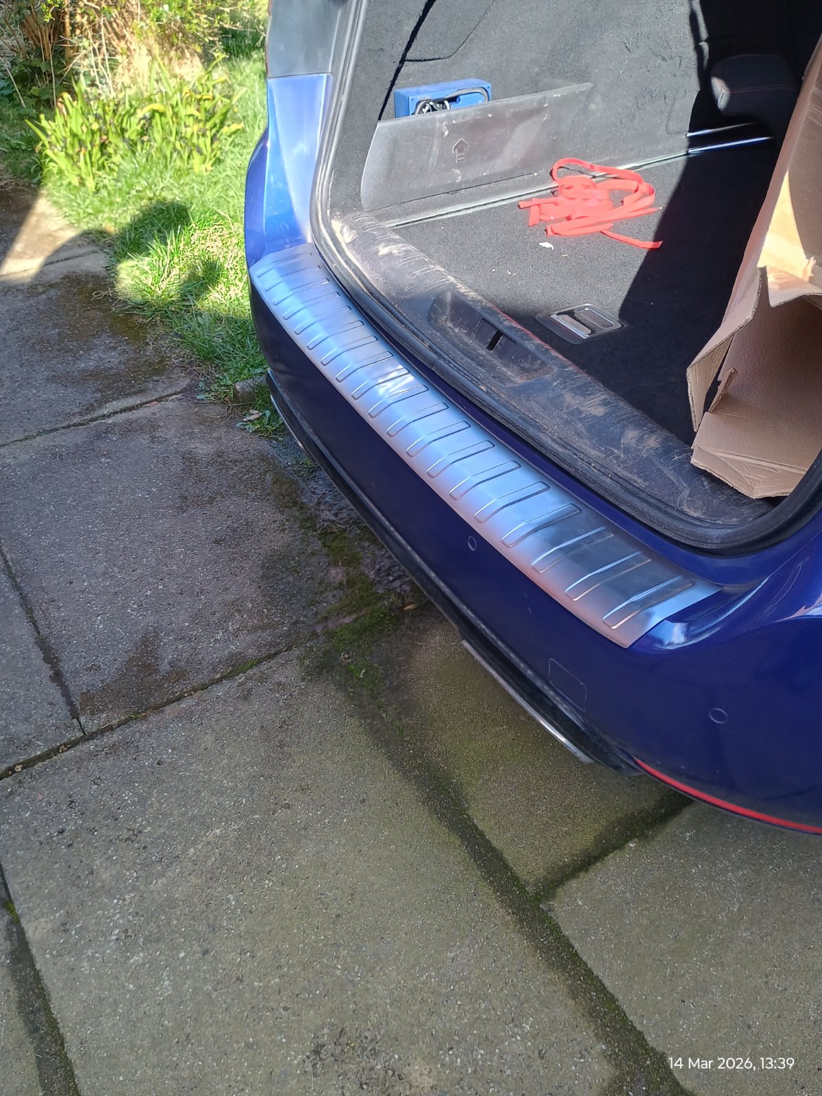

Boot shut view:
It's very conspicuous, not sure if I like it, but Function over Form :)
Posts: 21119
x 8111
Good work on the ball joint Matt, not sure I like the bumper protector either but function is important, maybe spray it body colour? :)

mickthemaverick wrote: 14 Mar 2026, 14:51 not sure I like the bumper protector either but function is important, maybe spray it body colour? :)
Wondered about that but it's stainless which doesn't take paint well and I thought if full of shiny scratches it'd look terrible in short order!
I'm going to see if it "blends into the background" given time [-o<

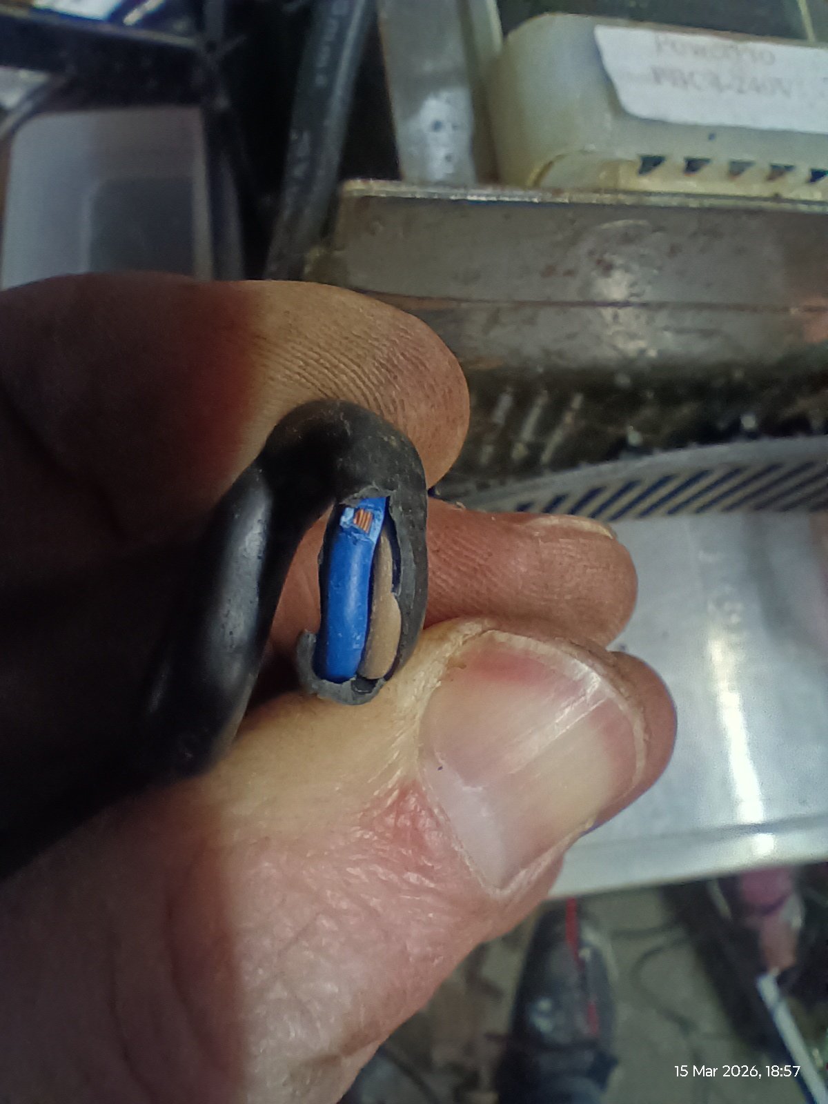

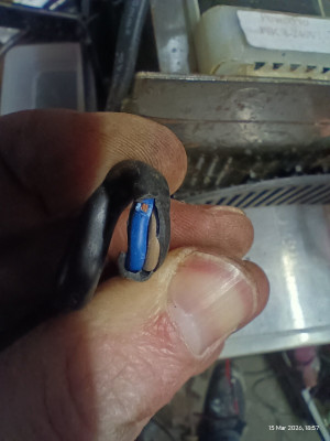

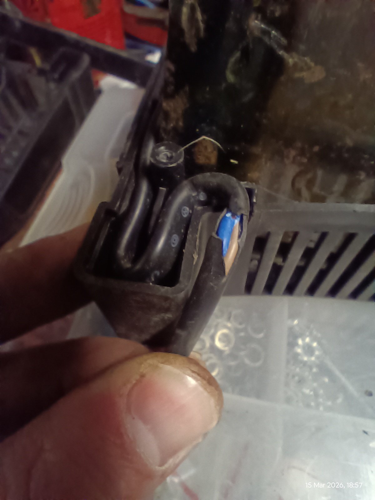

Good example of why it's worth checking over tools and equipment every so often:
I spy bare copper!
This battery charger wasn't far off either a BANG or giving me a jolt!
:yikes:
No strain relief and a casing design that encourages you to wrap the leads around the casing for storage (and hence usually bend them in the same direction each time) fatigue failure of the outer and then inner insulation.
The output leads were not as bad but similarly poorly protected from the same failure mode.
