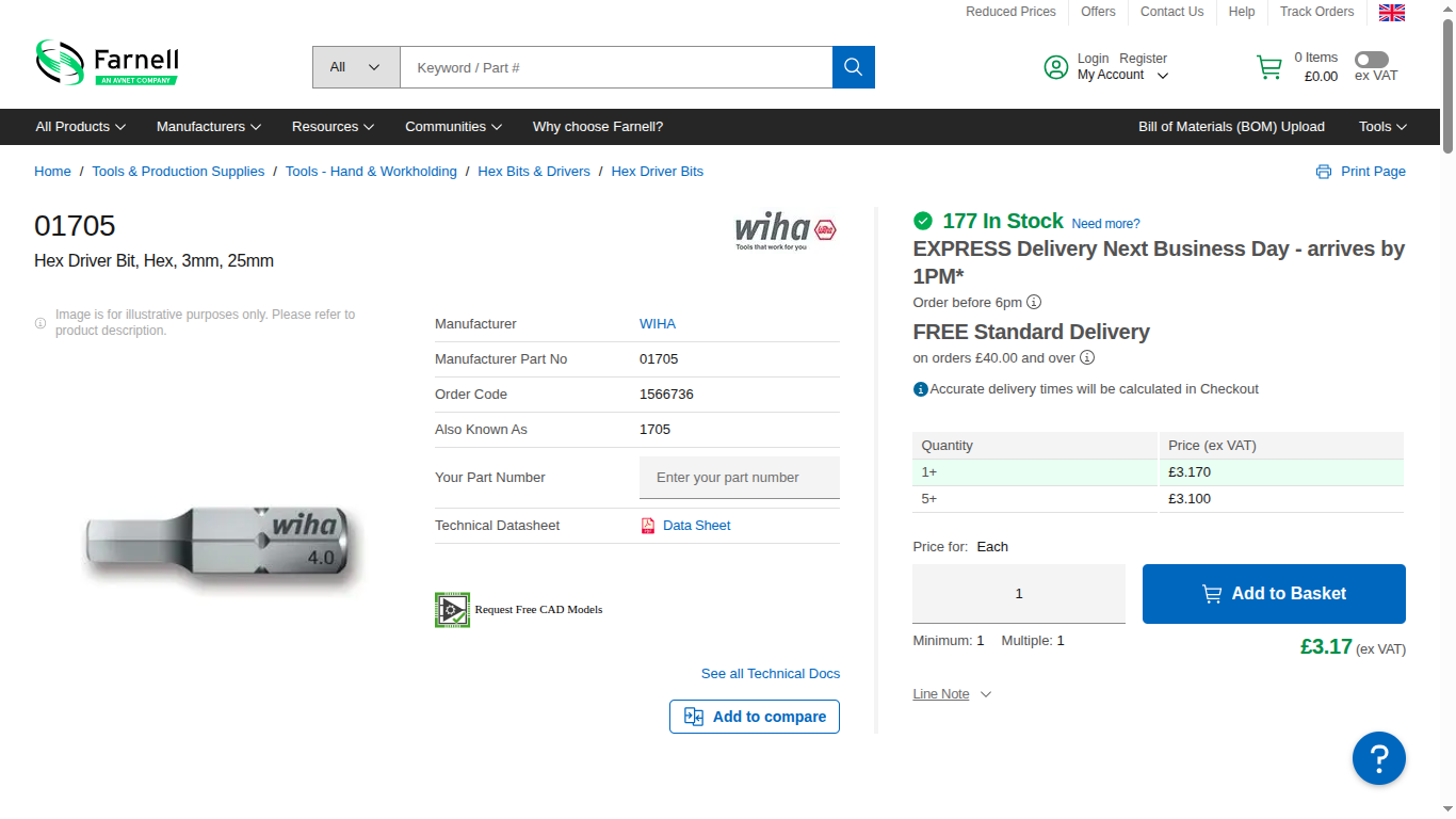

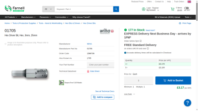

Coincidentally, perhaps Neil has the solution:-
viewtopic.php?p=864950#p864950
I'm sure that I have some square bits here. A quick and dirty search brings them up from several sources including Farnell:-
https://uk.farnell.com/wiha/7013-z-3-0m ... dp/1566736
