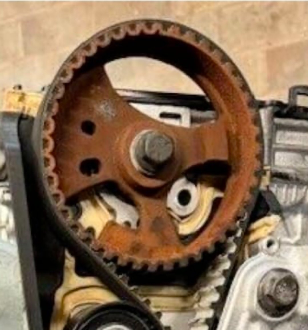

Hello all. I am new here and seeking clarification on a job i am going to be doing next week.
Going to be doing timing belt on a 2020 Peugeot Expert III 2.0 BlueHDI DW10.
My question is, is the high pressure fuel pump timed?
I have watched a couple videos and there is no signs or mention of the HP pump being pinned and locked before removing the belt. Yet when I look online, it says that it should locked to keep it synced.
After finding TDC should I be able to pin the larger timing hole on the cam gear as well as the smaller hole which is for the HP pump?
Any advice would be greatly appreciated.

I had this with my Expert DW10FC, this may help if I have attached it correctly.
And this was interesting: https://www.repxpert.us/en-us/training- ... ssure-pump
Bobby
