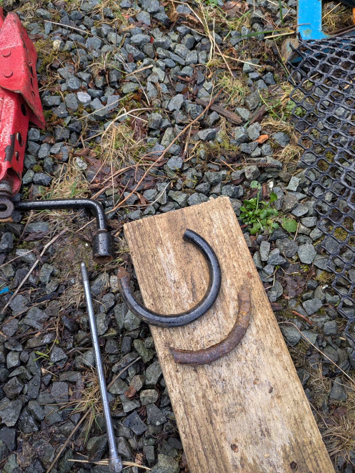

OK finally found time to look at this and, yup, the spring has popped partly off. Haven't looked to see if it's actually broken but I don't see/feel anything obvious. So maybe it's that top bearing?

Oh it's definitely broken.
Just had the wheel off and I've fished out two separate pieces of spring. One break looks fairly clean, the other is quite rusty, so the first bit must have broken off a while ago.
Nearest garage is about fifteen miles away... car still seems to be driving ok around my driveway... and if avoid full lock there are no horrible noises... but I'm assuming it would be a pretty big risk to actually take this out on the road like this?

Re: 308 noise from steering
That's quite a lot of spring I think...?
- Posts: 21057
- x 8085
That certainly is a handsome chunk gone missing in two parts!! Personally I would suggest that it is not safe to drive on public roads as a single heavy jarr such as a pothole may dislodge the spring completely causing all sorts of secondary issues. I don't know but it may even be illegal to drive as it would probably be declared at an MOT as dangerous. The safest course of action would be to have it recovered to the garage for spring replacement and I would advise replacing both springs as a pair.
Springs can move and cut into tyres when they break so driving is probably not a good idea as it could end up costing a lot more. If you are having to pay for recovery then you might try a mobile mechanic since it is not difficult to replace a spring with a couple of spring compressors and should be around 1 to 2 hours work.
I was driving my daughter's C3 when a spring broke, didn't 'stab' the tyre but deformed enough that the coil rubbed on the tyre and wore through it and it went off with an alarming bang.
